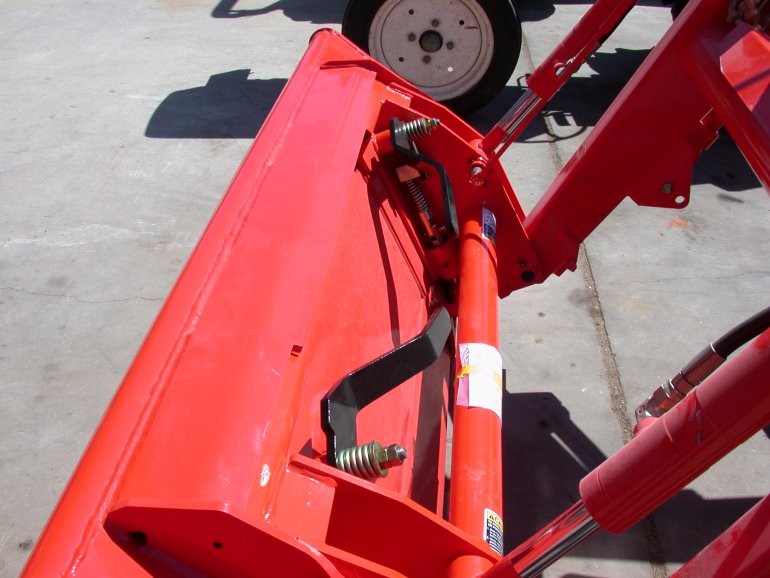

Here's another photo.

On my BX23, when my dealer put hooks on the buckets, he put a reinforcement plate behind the lip of the bucket. He did exactly the same thing with the bucket of my B3030. I agree with you Bob about the fact that hooks on the lip without reinforcement is dangerous to twist the bucket.

dwight, the term Heavy Duty was defined, not by me personally, but by a consensus of a few differnet TBN members of which I was one. It was used in the photo comparison thread from a couple weeks ago. But that said, the term is simply our opinion and does not take metal gauge into account, nor does it take metalurgy into account because those things could not be easily shown in photos.
We defined a HD bucket as one that had welded reinforcement on the cutting lip and the bucket sides, PLUS had some sort of square or round tube welded to the top lip of the bucket.
For mounting a center bucket hook (and this is just my opinion) I would not mount a center hook on any top lip that was not somehow reinforced. The reinforcement could be in the form of an OEM supplied HD bucket or in the form of angle iron (as Henro did) or tube welded onto the top lip of the bucket.

I did the 2x2 angle 1/4" thick. I just did not want to hang the chain over the lil lip on the bucket that I had already bent up.

I understand you to mean that a fella should assess his bucket to determine if he thinks it is heavy enough to be pulled in the center and still keep its "straightness".
Your comments made a lot of sense.

Angle also 2.5x2.5 x 3/8. I like even better now that I made a set of rudimentary forks that I can attach and detach just by rolling the bucket forward and slipping the angle under the channel I made on the fork assembly without getting off the tractor. I hate to get off the tractor.
