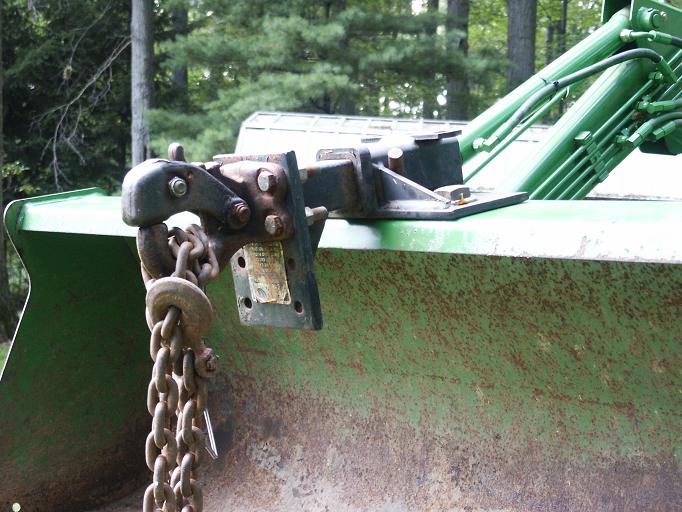

Just mounted mine. Was going to buy a hook from Tractor Supply or Horrible Freight but the pintle hook works very well.

Well all my trailers are pintle hitch so I figured I might as well use what I already have on hand.:D
