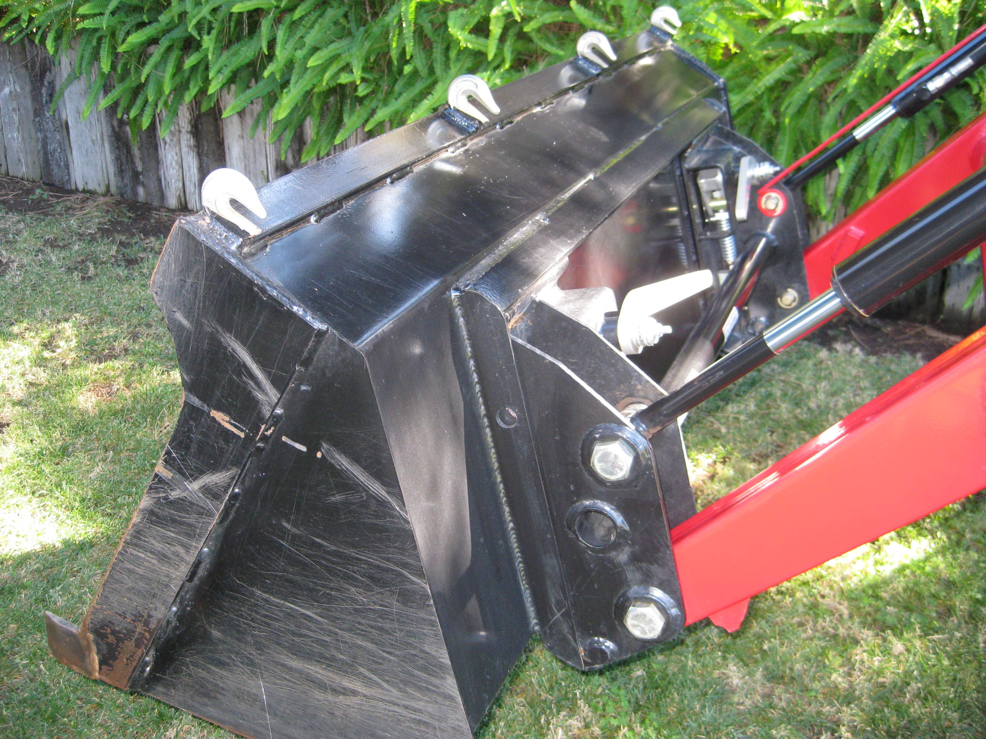

I reinforced bucket with 3/8 angle, gridded flat spots on 3/8 hooks for chain and welded on
   / Bucket Hook(s) Placement #23
Nice Job! Looks like a super-duty bucket! What kinda tractor you have that on?
   / Bucket Hook(s) Placement #24

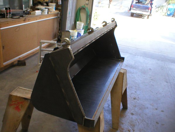

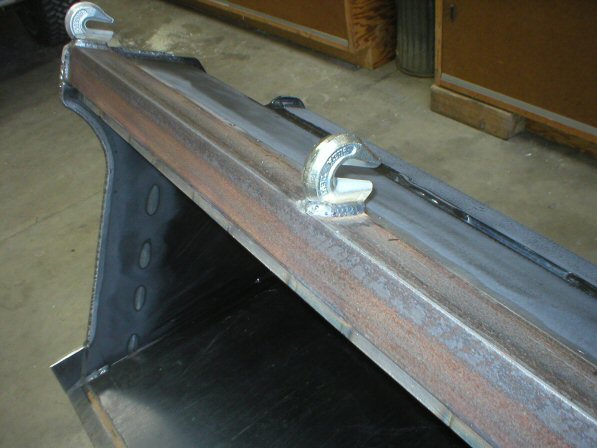

I used 2x2x3/8 angle on the top of 2 of my buckets. 4 hooks on the 5' bucket and 5 hooks on the 78" bucket. Have had zero problems. :thumbsup:

I have enough trouble getting 2 chains to match length, sure wouldn't want to try to get 5 hooked so they are all lifting equal load.
   / Bucket Hook(s) Placement #26
I have never seen anyone with a hook welded in the center that didnt have a bent lip on the bucket unless you spend lots of money and time to add doubler plates to either the underside or top side.
Boy, I'm gonna jinx myself with this statement but here goes. I welded my hooks on within a couple days of purchasing my tractor new. As you can see by my pictures I use my bucket pretty hard. I carry a lot of steel items and big rocks. I use my center hook almost as much as the end hooks. Several times I've hooked to the center and carried all my hydraulics and tractor would lift. I've yet to bend the center of my bucket. I agree with what you are saying as far as adding strength thru plates. I just think your statement that you've never seen anyone not bend their bucket is a little strong. In my case maybe my tractor just isn't strong enough to do that damage. :)
   / Bucket Hook(s) Placement #27
Gary, the 5 hooks are so that I have hooks where I need them, when I need them. I can't think of a time that I have ever used more than 2 hooks at one time. ;)
