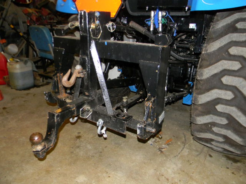

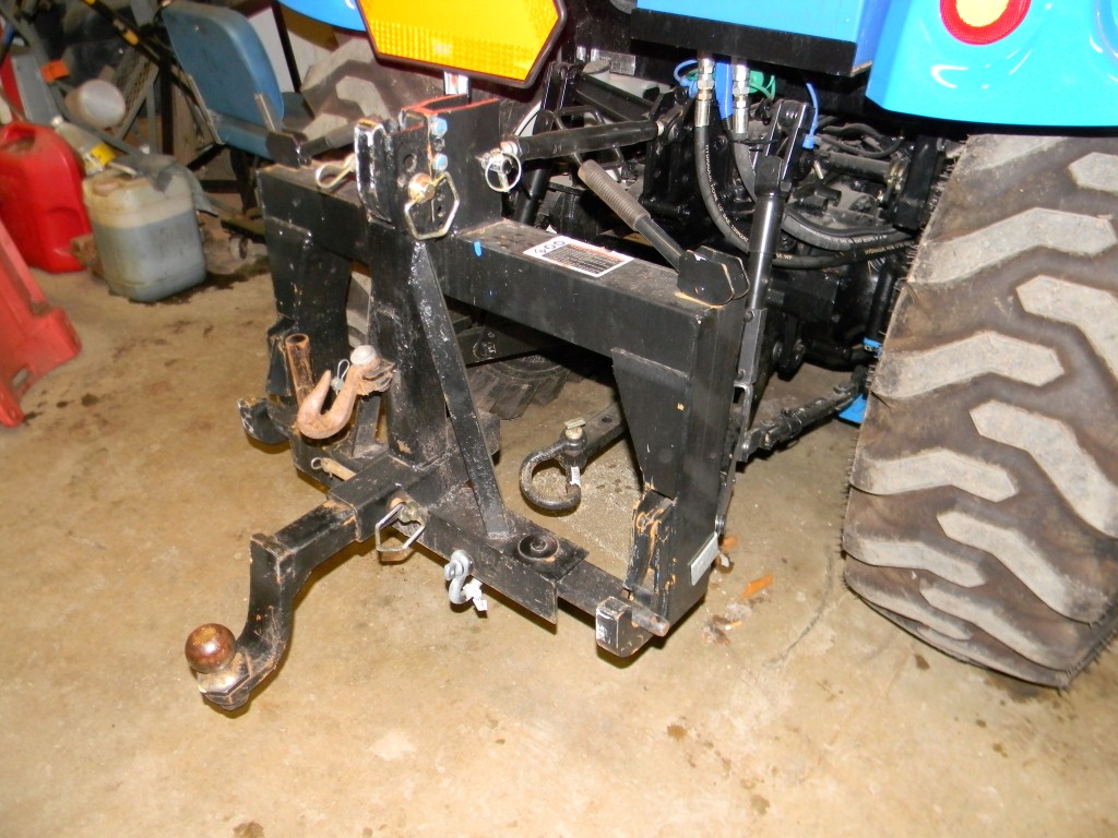

I welded grab hooks and shackle mounts in addition to a receiver mount to the bucket. With the receiver mount I have many choices with the center of the bucket. It makes moving things around much easier. With the large hook moving three point equipment is easy. I like the shackles for attaching ropes and straps plus the mounts give you a place to bolt something on if needed.

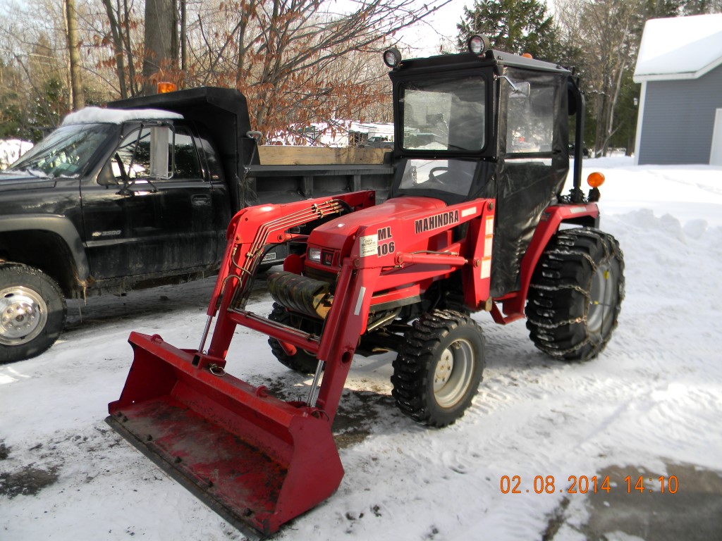

I put these on 6 years ago, they really come in handy. WP_20140426_003.jpgtractor%202.jpg
   / Bucket hook weld on points #29
Kubota BX25D
I placed them just inside the welded channel for balance and stability...
