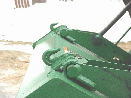

Welcome. It just made sense to me. I had to mess around with a couple of hooks and clevis pin links to make-up the double grab hook, but the assembly works great

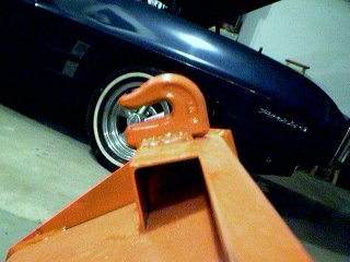

/ Bucket Hooks...Again #22
Here's one view of the hook

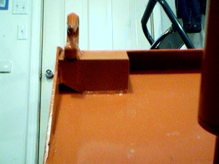

/ Bucket Hooks...Again #23
In this view, you can see a triangle shadow below the hook in the angle iron. I cut about 3/4" off this corner on each side of the bucket to let stuff flush away when I washed it, so it wouldn't trap water and rust.

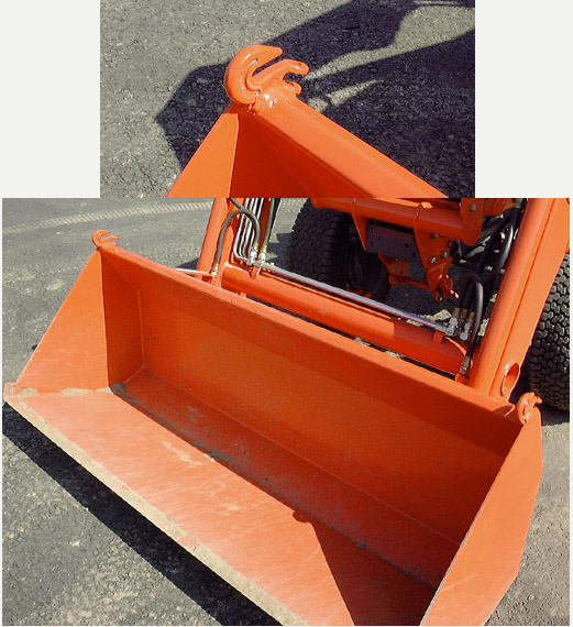

/ Bucket Hooks...Again #25
OK Paul and everyone else....these hooks look great but now another issue resurfaces from the past. I just read through the old discussion threads on these hooks and there was a real concern whether these hooks were Chinese made or U.S. made. It seems back a couple years ago in the threads, the Chinese hooks were of poor workmanship and would break easily under moderate work loads and posters were recommending TBNers shop for the U.S. made ones at one or two on-line supply houses. I'll be having hooks welded on my new bucket in another month or so and I would like to resolve this issue, at least in my own mind, so I can plan accordingly. Any comment, anyone?

/ Bucket Hooks...Again #31
Paul, Nick.....Thanks....I'll check into these sites. But, if you don't mind these nagging thoughts, up pops another issue that I just thought of. What size grab hooks do you and everyone else use? Are hooks that accommodate 3/8" tow chain satisfactory or maybe I should say optimal? I'm thinking anything bigger than this is overkill anyway since the working load limits of the chain and hooks would far exceed the lift capacity of the FEL and bucket. You think the hooks for a 3/8" tow chain are sufficient for a JD460 FEL with anticipated uses of restraining bulky, heavy loads and pulling/plucking moderately sized honeysuckle and other swamp bushes?
/ Bucket Hooks...Again #32
I just discussed this with my dealer last week. He wanted to put 5/16" hooks on, as he said most people use that size chain on CUTs. But I insisted on 3/8". That way I can use either size chain in the hooks, otherwise I would be limited to the smaller size. I can't imagine needing anything larger than 3/8" ever. When he delivered the tractor Saturday, he said the more he thought about it, the better idea it was. I'm very happy with how they turned out.

/ Bucket Hooks...Again #36
Rancar, I wouldn't worry about where they're made, BUT I worried about the steel grade. I did some shopping around and found some grade 80 grab hooks with clevis pin link on the end. I torch cut the clevis pin end off of the hook and then welded it on. I found my hooks at a local equipment rental store where they handle chains and binders for trailering equipment.
