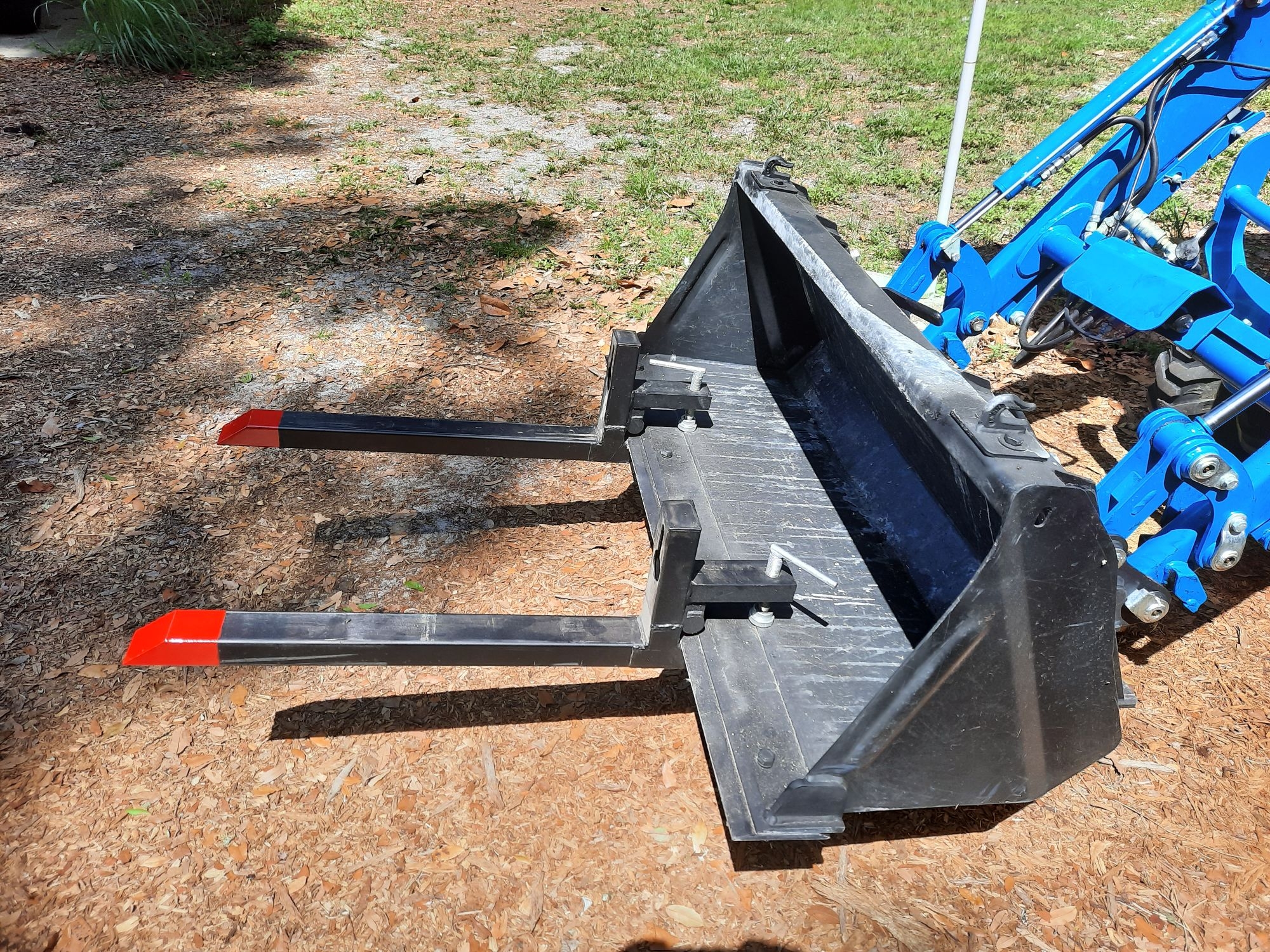

I just ordered some bucket forks this evening for $85. I dont expect them to be a Good solution, but they are the cheap (and that means fast) solution. I had planned on picking up normal SSQA pallet forks; but wallet got light; and really wanted to start pulling crap out of the woods and hauling to scrap yard. Nothing super heavy; but 2 old riding mowers; 2 small 4 wheels; couple washing machines/driers; and a bunch of old half rotted demo lumber (old chicken coop).

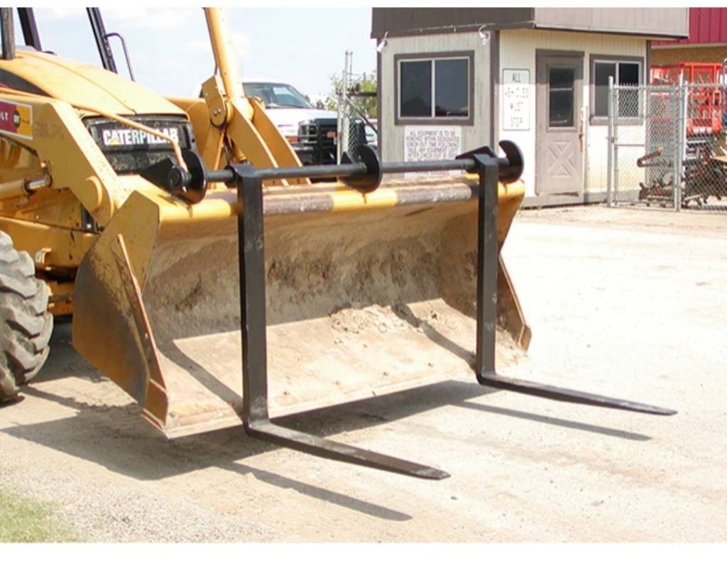

Question is; does nobody make the old back hoe loader forks; had the 4 hooks on back of loader bucket; heavy rod; and forks that where supported both by the back hooks and the inside bottom of the bucket? I've never seen a pair on a tractor; and frankly, I dont think I've seen any new back hoes/rubber tire hoe/combination (whatever yall prefer to call them).

I saw some of those; but they are only supported by the hooks; there used to be a type that sat in the bucket; so you had support both on the bottom and the top.
Either way; they don't seem like an economical option compared to regular SSQA forks. Maybe good for non quick attack buckets.
Maybe I'm just misrembering, and they didn't sit in the bucket and only hung from the hooks... or maybe it was something fabriccobbled by a contractor for their specific use.

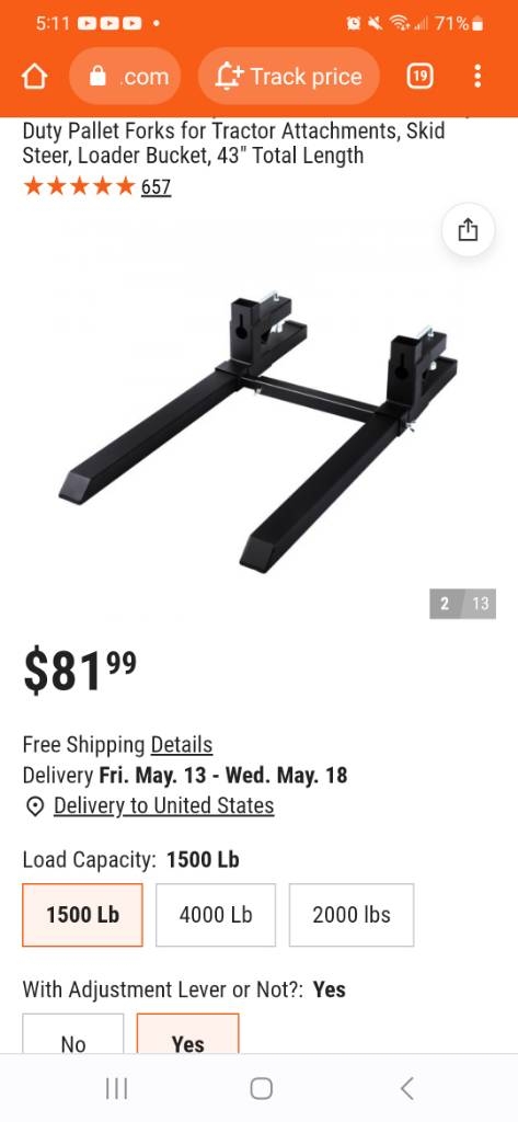

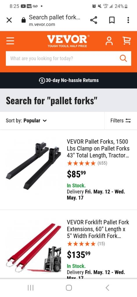

Ones I ordered do come with stabalizer bar. I ordered the smaller, 30" ones; hoping I wouldn't be tempted to have something at the very end of a 42" lever, already almost 24" beyond the pins. If you ever order from Vevor,(which I have several times) it can be confusing when you order the 30" variety of the 42" forks; and the description doesn't change. I also bought a 7"x14" metal lathe from them about 5 months ago, for $300 (and they had probably 3 flavors, all at different prices, and same description), and a 36"x72"×12" metal garden raised bed for wife.
I know the "Tool Bear" just did a video, basically saying they are a shady, copy right stealing cover company, but... so far I've been happy.

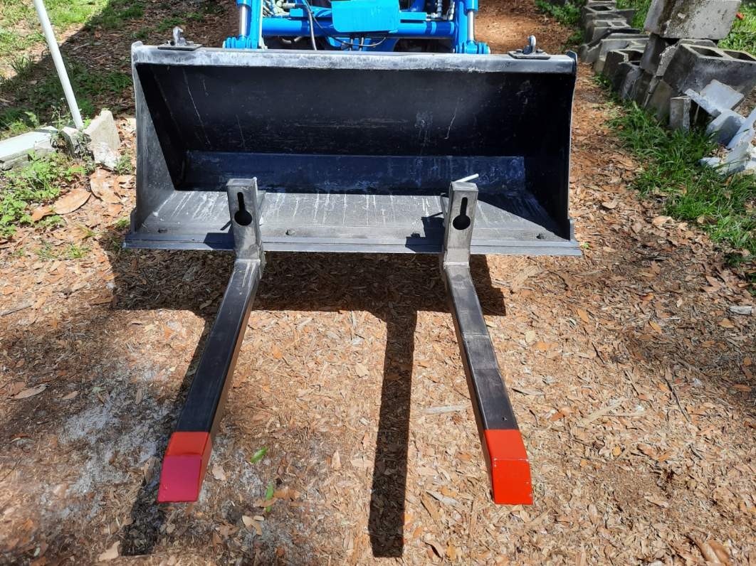

Got the Vevor bucket forks today. After just 2 hours of use; my general impression: they are worth the $85; and they beat the heck out of trying rig chains or straps over the bucket to try to pick up weird stuff; But they are a bit of pain in the butt. Even with the support bar, you can't have Any side load of the forks or they go cross eyed. Don't know how much anything I lifted weighed; but it was as much as I would want to. 2 seat Tao Tao go cart, 2 mowers, a big commercial stainless cooler, pile of underground primary power wire ect.
Not a replacement for a SSQA forks; but I would buy again at $85.

The stabilizer on mine slips over the forks , looks like this one is on the top of the mounts?
$85 and does the job, seems like a good bargain.

I have a similar set as well. I can say that I find them better then not having them, but hard to use. Difficult to see them through the bucket, difficult to get get them level. Not great for precision work like loading or unloading my mower deck on/off my small trailer from the side when I ended up bending the crap out of one of my fenders. But overall better than having nothing.
