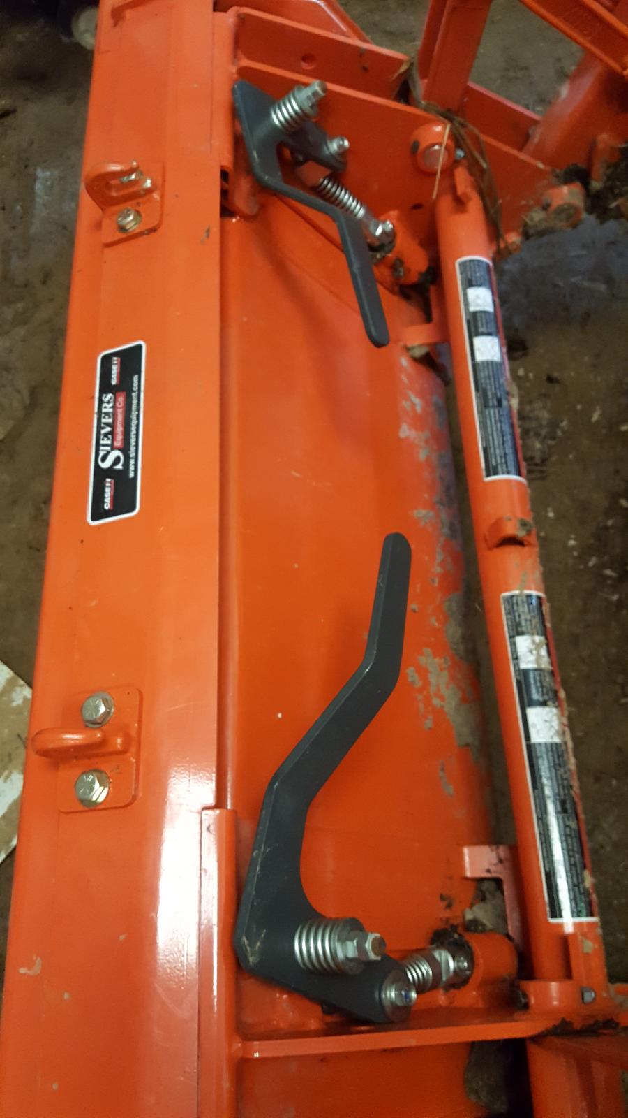

For those who don’t weld you can always put on the bolt on hooks so you can at least use them and if you ever take your tractor into the shop they can just run a weld around the hook plate and then you don’t need to worry about the bolts doing all the holding, they can also remove the bolts and weld up the bolt holes holes.

If you watch our proof testing video's you can see that the bolts will hold anything a compact tractor can deliver.

A grade 8 bolt has 150,000 lb. PSI (120,000 lb. proof) failure rating, that is like 75 tons, seriously doubt any "farm" tractor can put that much stress on bolt.... A weld will probable rip out long before bolt fails....Personally I have no problem or doubts that two grade 8 bolts will hold sufficiently....

We installed a set of Ken's Bolt on hooks on my dad's tractor (MF383). He liked mine so much, he wanted a set on his bucket.
   / Bucket Hooks #90
Mine are bolted on and I’m not worried about a thing, I’m sure my bucket will bend from abuse before anything else happens.
   / Bucket Hooks #91
I use Kens, I have put them through ****, they work well, if you have any problems with anything bending, you're bucket is weak..
