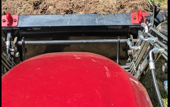

I put mine over where the bucket attaches because it was reinforced there on the backside of the bucket, you can see in this pic. I love having them on. I believe it is much safer using the hooks when using a chain to move heavy implements etc. because of reduced chance of the chain slipping.
I have another set I need to get on my other tractor. I'll probably get some stainless bolts and replace them as they are rusting.

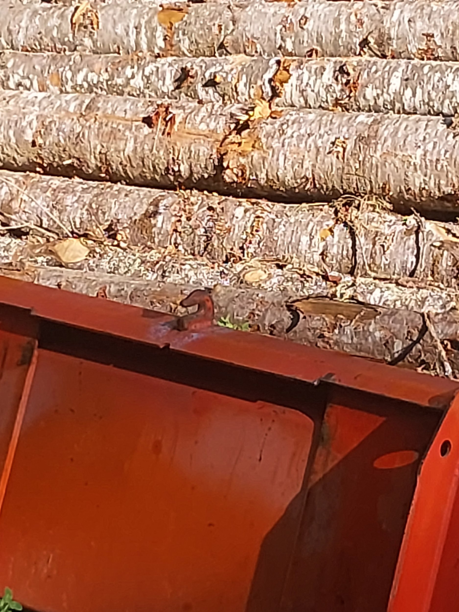

My bucket hook is unique. The hole was already there:

I think grade 8 bolts have greater strength than stainless and grade 8 won’t rust either.
