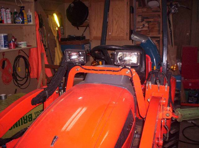

Rear lights for snowblowing and backhoe use.

YeeHaww, another guy from Nova Scotia !! Looks like you made a trip to Princess Auto for your rear lights, they look just like mine /forums/images/graemlins/smile.gif I notice you've chain hanging from your loader frame; how about a close up pic to show us how you've got that done.

The bracket is UMHF (at least I think those were the initials), the box is 1/8" plate. I didn't weld it tight so the water would drain out. Bracket is just sitting there hooked over bolt. Holds two lengths of chain ten feet long.
Steve
