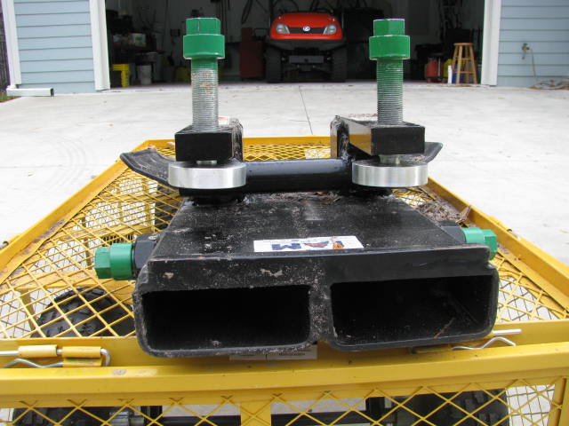

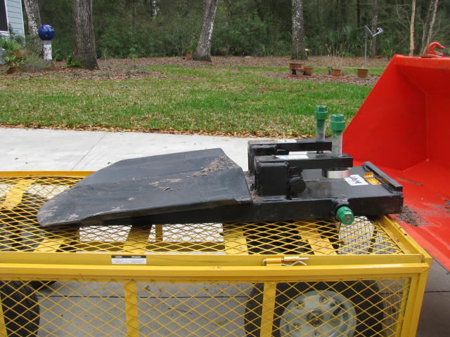

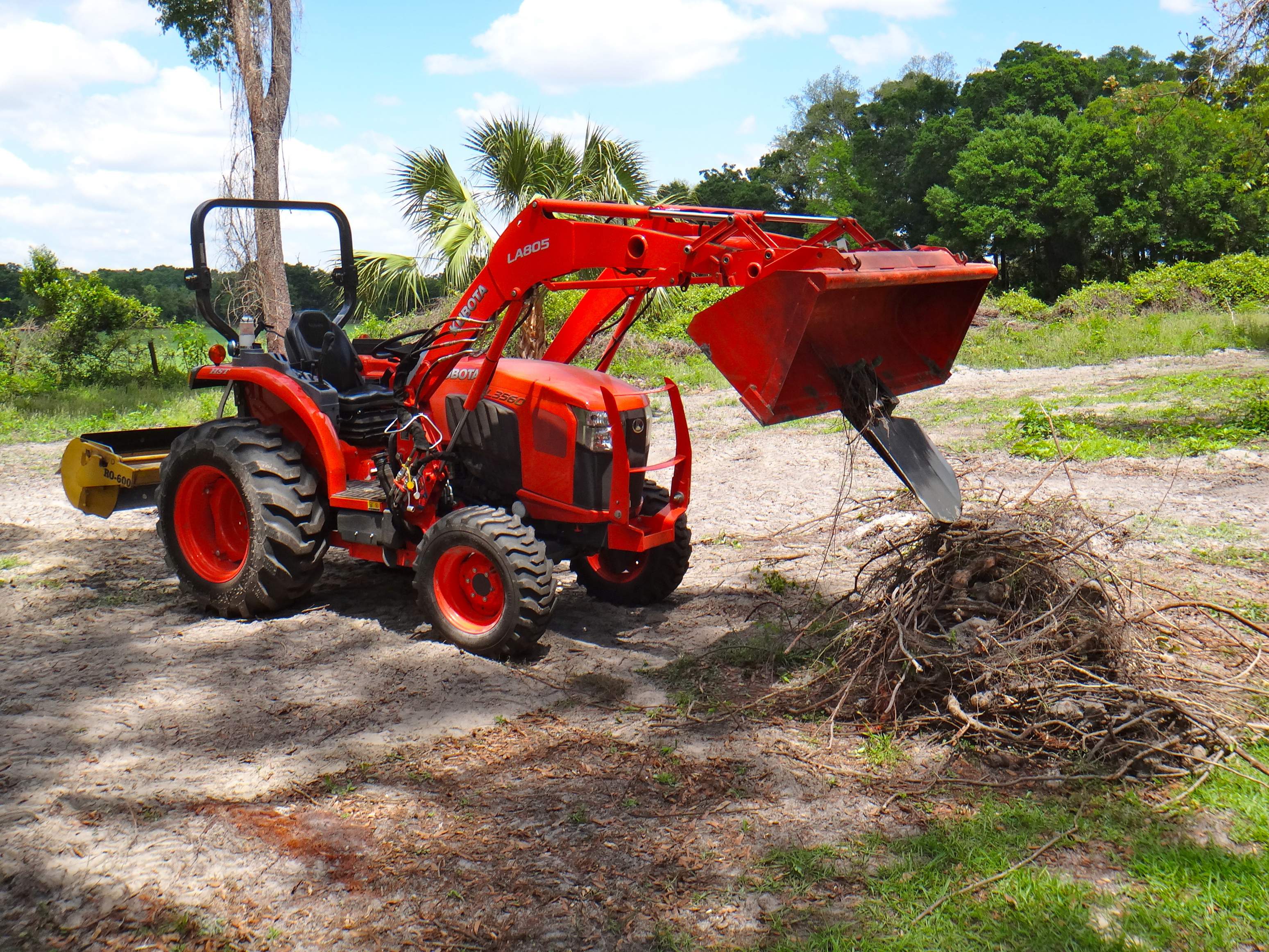

Aftermarket Bucket Spade.
   / Bucket Modifications. Pictures please.
#13
aeblank you have the hardest part done. Your bucket looks well built.
How do you like that bucket spade jeff9366? Is it bolt on?

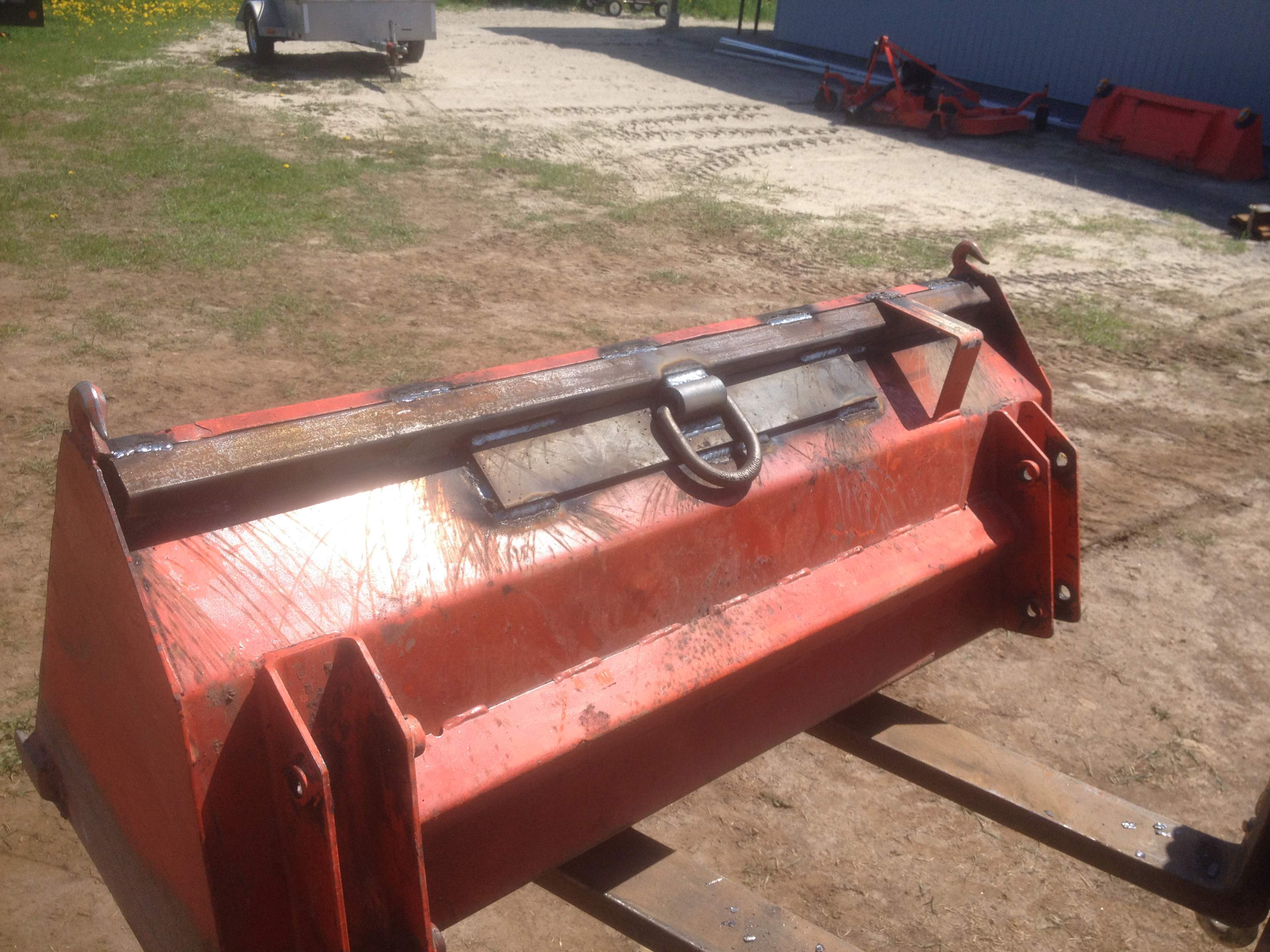

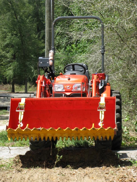

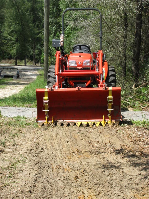

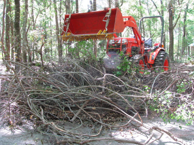

Here's what I did,
I welded one hook onto a mounting plate that I bought from Ken's on the lower portion of the rear of the bucket. I also welded a shackle mount to one of Ken's plates and welded it to the underside of the bucket lip inside the bucket. Combined with a clevis shackle I can use that for a single point lift using straps for lighter items.
I got a length of 3/16X3X3 angle to set on top of the bucket lip which I welded to the lip and to the back of the bucket. 1 hook in the center and the other 2 centered on the FEL arms. I added 2 small shackle mounts that I got from Ken's outboard of the hooks, again just for lighter lifts with nylon straps.

Nice work.
