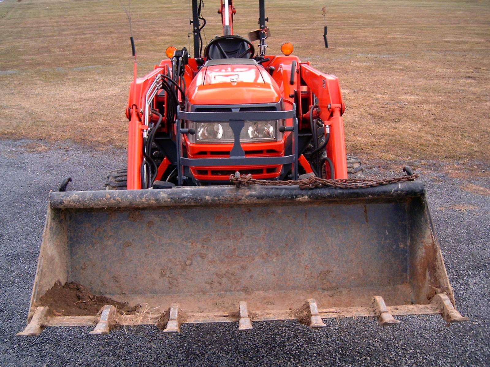

I have four 3/8" chain hooks welded on top of my 72" bucket and a BXpanded piranha tooth at installed.
/ Bucket Modifications. Pictures please. #5
3/8" angle across the top with hooks and 3/8 plate on the side leading edges. Zero bending thus far. :thumbsup:

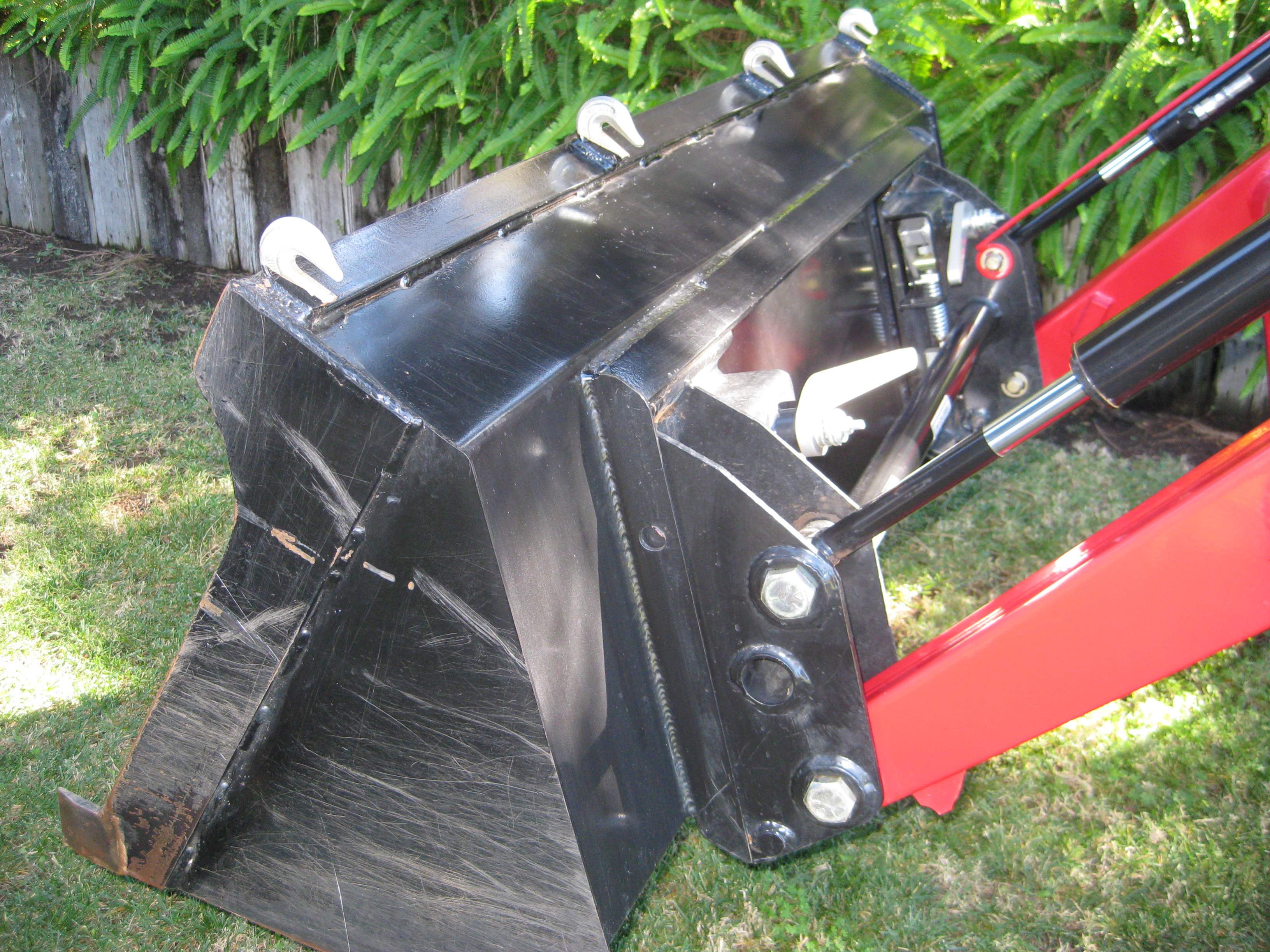

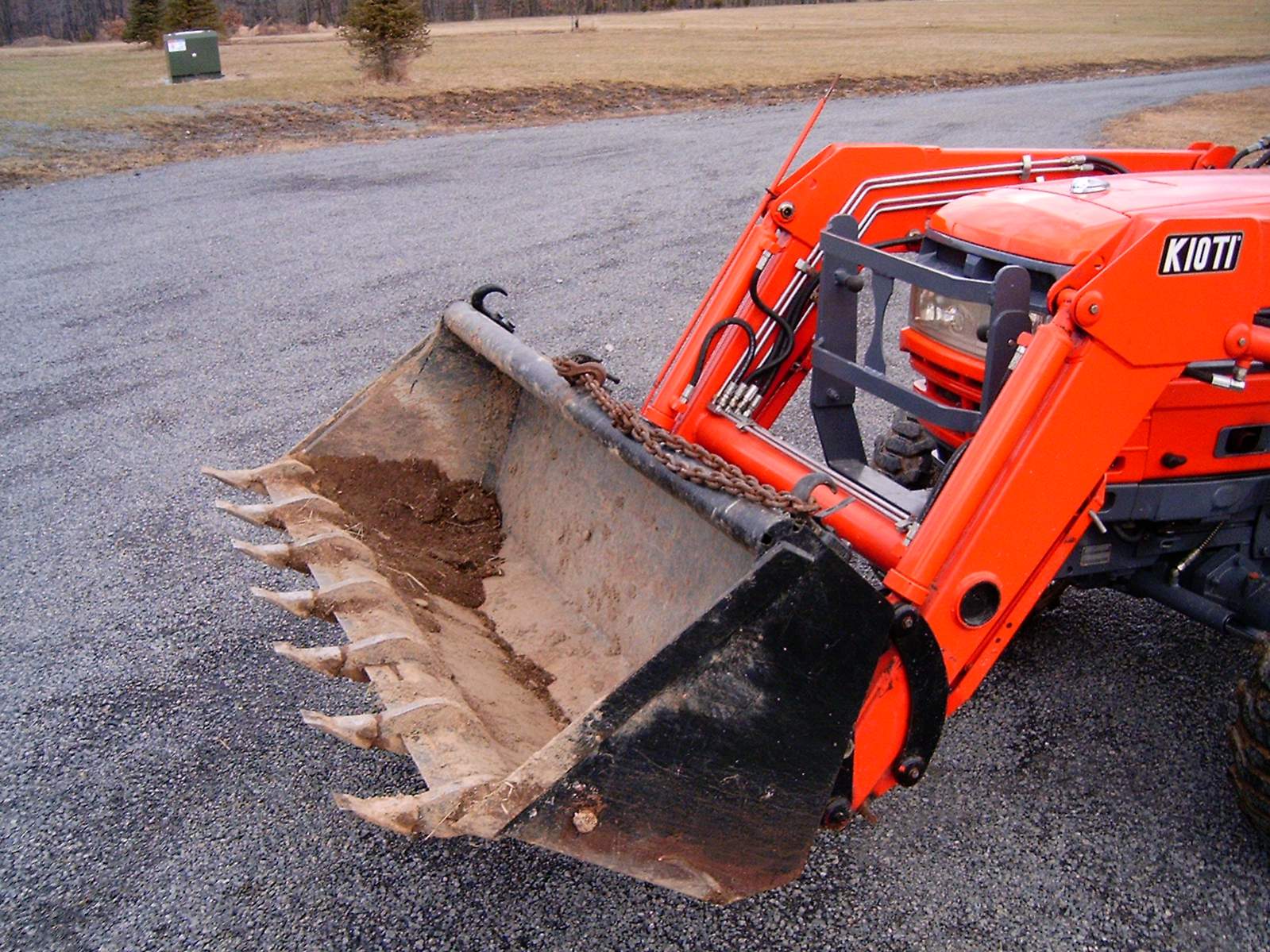

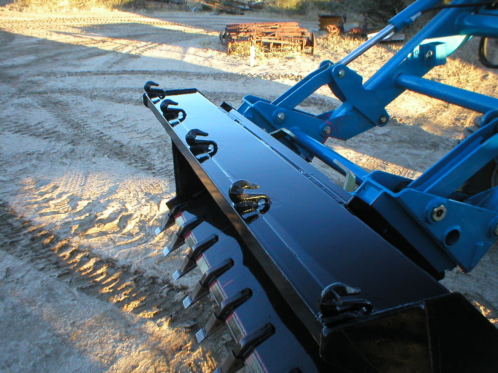

I have a WR Long toothbar and 3 bucket hooks.
The hooks on each end of my bucket are bolt-ons.
The center hook is a welded on 3/8 grab hook.

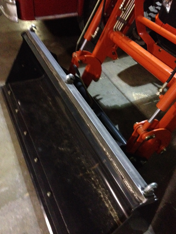

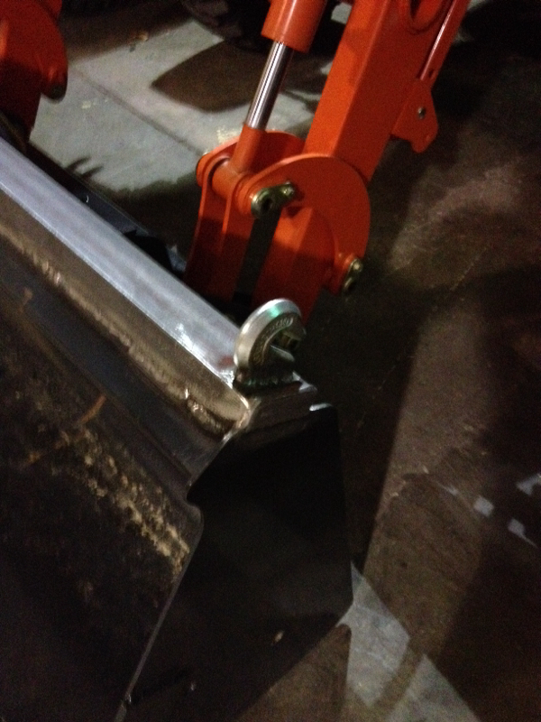

I used some 3" X 1/4" C channel welded to the top of my bucket then welded 3/8" grab hooks. Not very good pics but gives you a idea. I don't have any painted pics.
