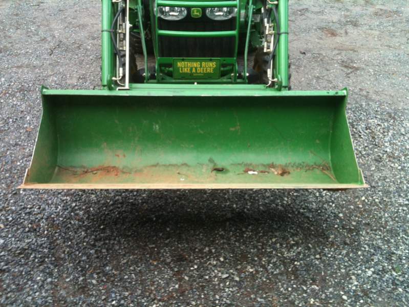

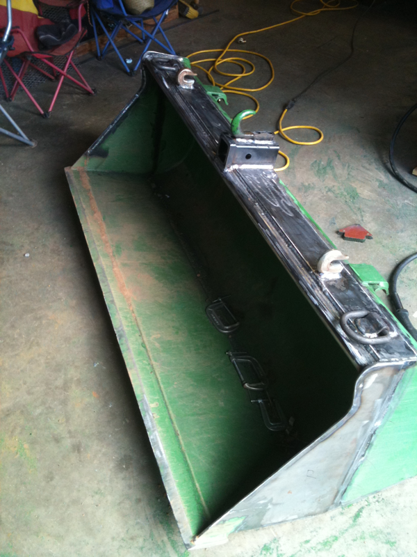

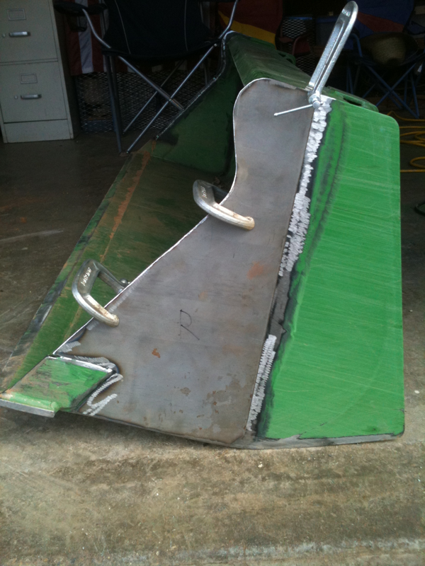

Started working on upgrading the bucket for my 3320. I did a lot of reading here and combined a few ideas from others. I wanted chain hooks, a receiver, a slip hook and some rings for ratchet straps. I also added 3/16 plate on the sides to thicken the cutting edge and provide a better anchor for the Markham tooth bar. The top of the bucket got 1 1/4 in pipe that had been sliced lengthwise and a 1/4 by 4" flat bar welded on. Let me know if I should change or add anything before she gets some paint.

Did you start out with the light duty bucket, or the heavy duty?

Nice looking job.:thumbsup::thumbsup:
The Clamps; will you remove them before painting?:laughing::laughing:
Did you add extra skid plate on the bottom of the bucket?:)

It is the light duty bucket so it needed some help. Never thought about bottom skids. Where are they put and how thick should they be?

Nice work, you made a HD bucket out of a Light duty. all those acs are going to serve yo well. I am especially fond of the center mount receiver hitch :thumbsup:

Depending on the width of your bucket I would put at least 2 on a 4' and at least 3or 4 on anything bigger. Run them from the back of the cutting edge to the heal of the bucket. Stitch weld them on so when they wear thin you can get them off easy and put more on! 3/8"to 1/2" thick x 3" wide

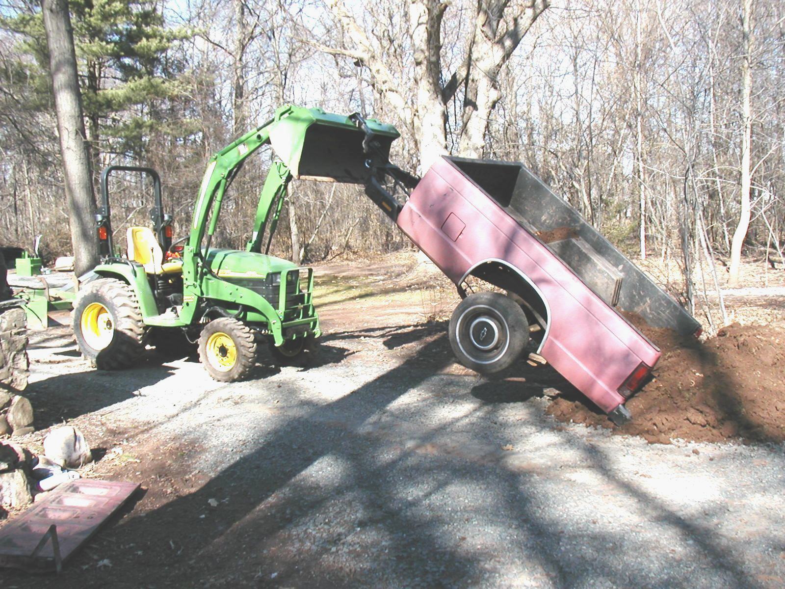

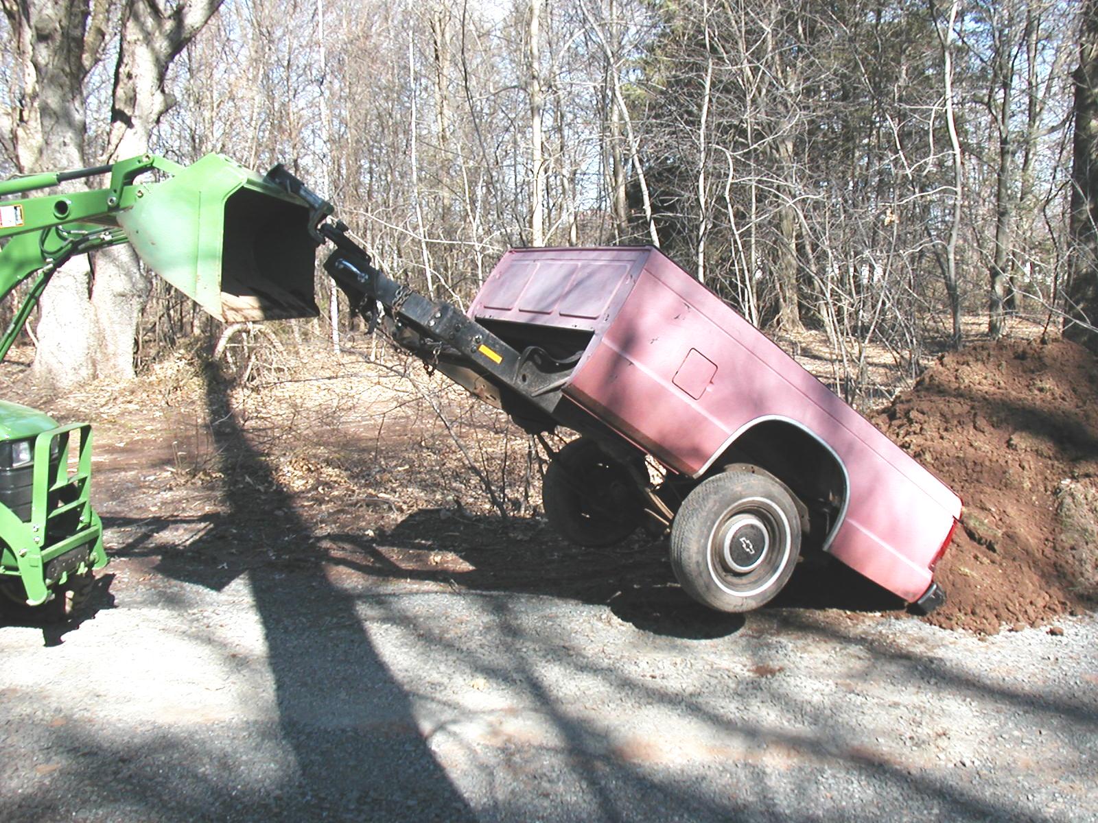

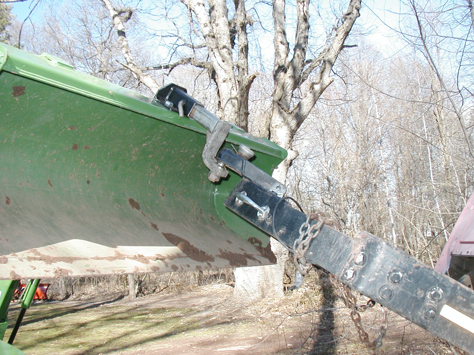

Absolutely, Not going down the road, mostly jockeying them around, storing them out of the way etc. Very handy.
This was an unconventional use, before I got a dump trailer, this set up helped me move loads of dirt a few hundred feet. much faster than running bucket after bucket full.
Just park trailer, load it with loader and grab it with hitch, drive to where needed and lift/dump.

The bucket has only two skids on the bottom so I will add a few

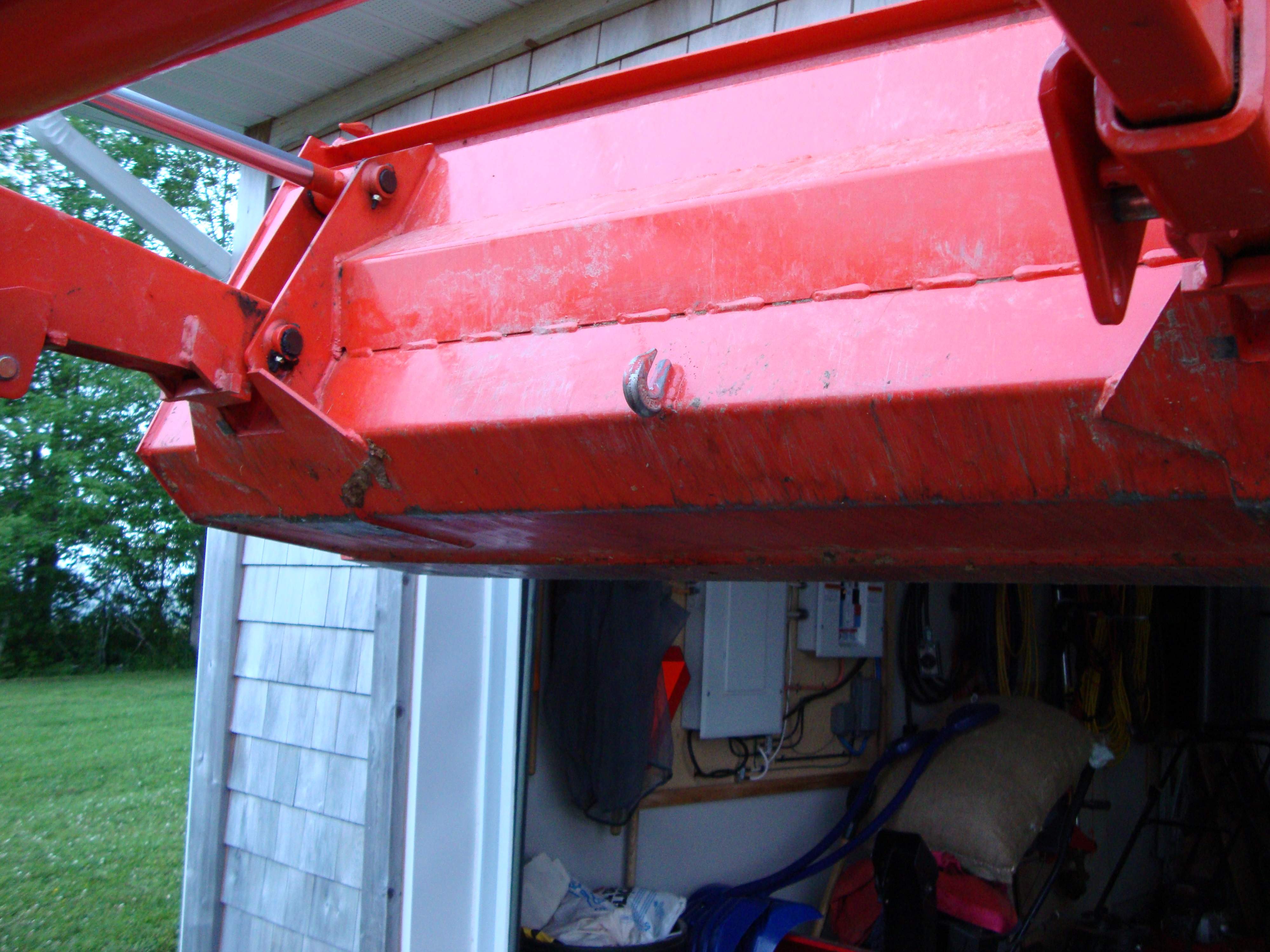

I think I would weld in another set of hooks upside down, to allow the chain to lift things from the back side. This is where you can lift the most weight, and by curling the bucket back, you can add to your lifting capability. This also prevents the chain from bending the lip of the bucket.

Nice job! I'd use more weld on those ring retainers, though.

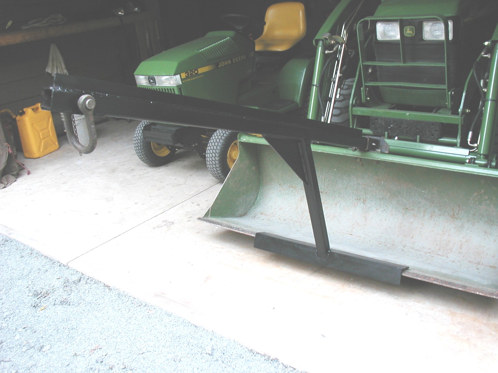

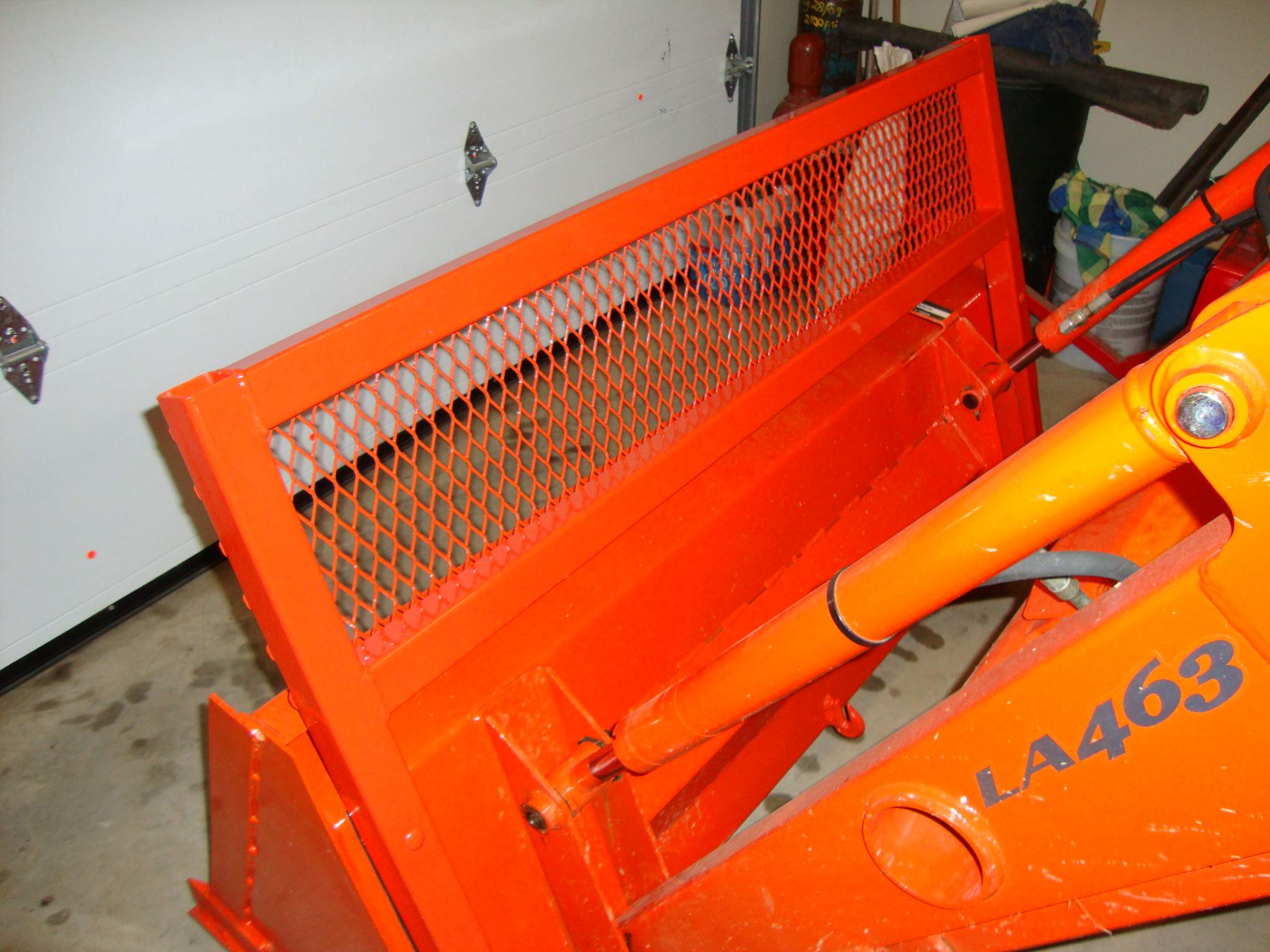

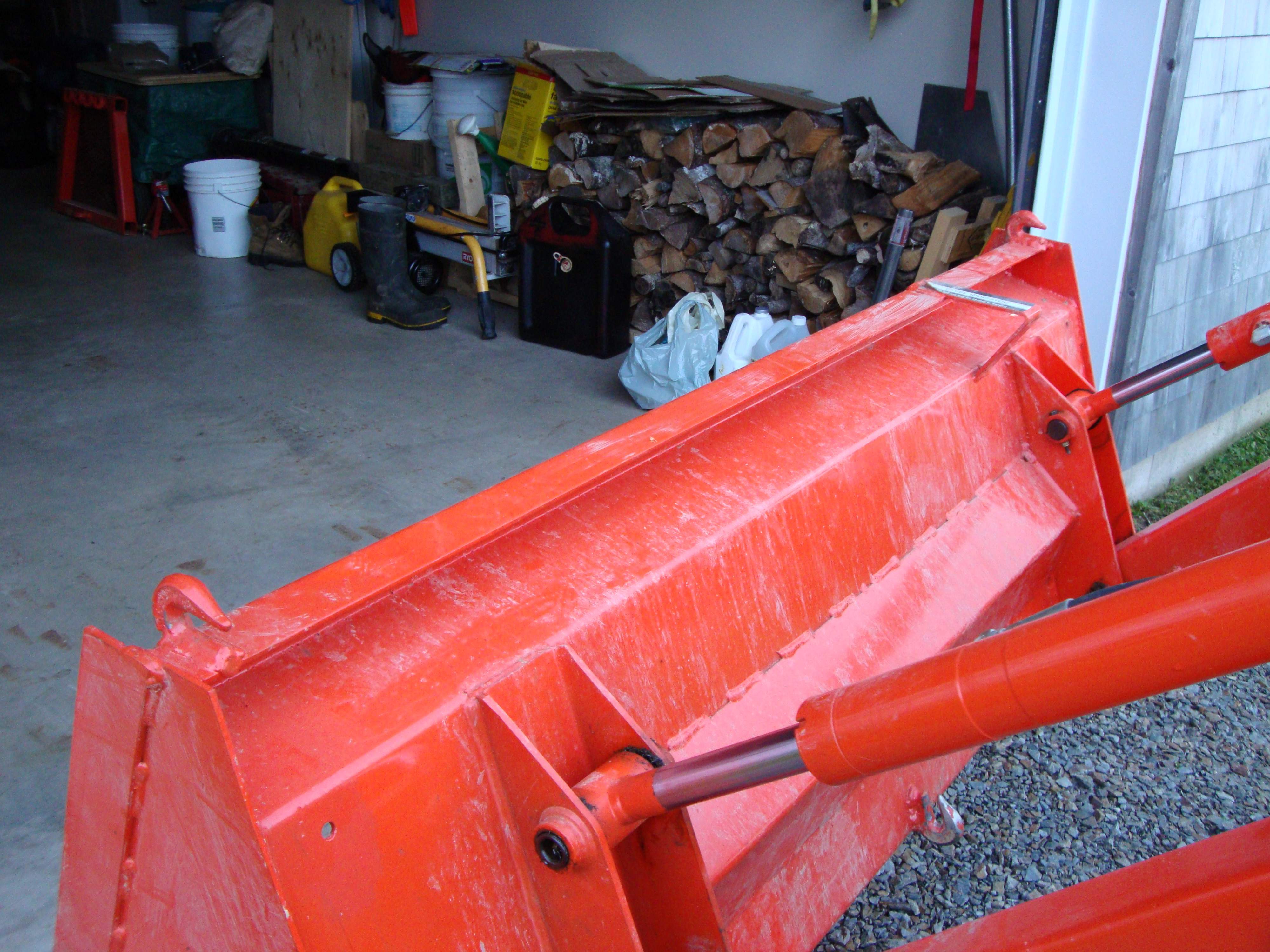

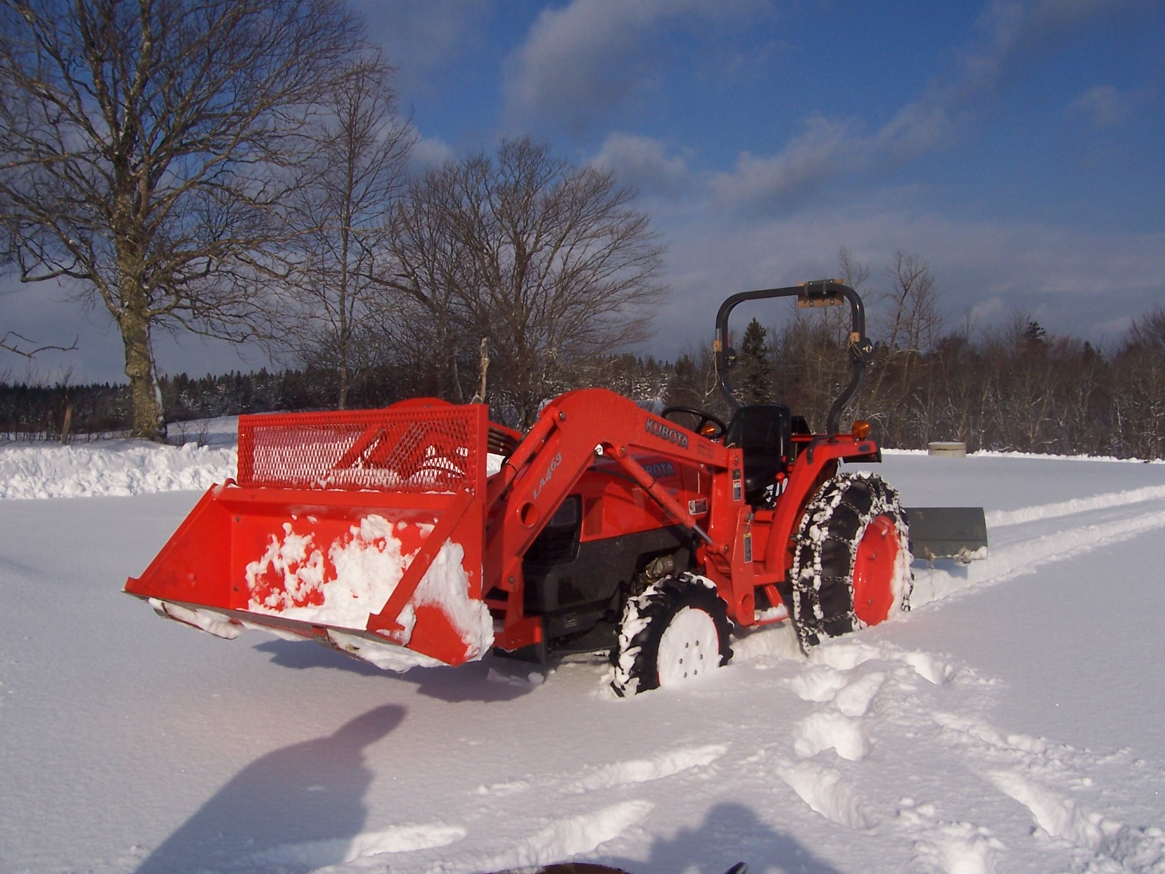

I added the usual hooks, two on the upper lip and one on the heel center line for heavier lifts. Also built a bolt-on "snow screen" to get more capacity for moving snow, and bolt-on snow skids for the bottom to leave some gravel on the driveway in winter. The next project is the removable forks.
