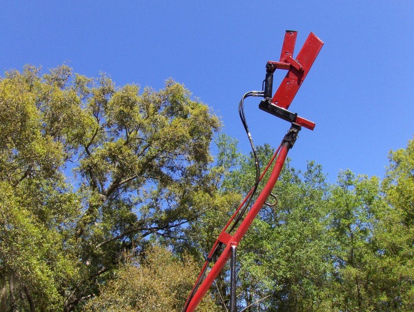

J_J's Hydraulic limb snipper: http://www.tractorbynet.com/forums/attachments/141126-hydraulic-limb-snipper.html#post1635813
   / Bucket mounted limb cutter.
#12
The top of the bucket is not as strong as the bottom edge even though I have reinforced it with 1/4" plate. So I may mount it on the bottom lit where there are already holes drilled. I don't want any hydraulics or complicated expensive equipment to use once every three or four years. Limbs up to a half inch or bigger can be ripped off with the bucket. I hope to make something that will saw off or weaken a larger limb enough that the bucket can break it off.
All in all I would probably have to walk more than a mile carrying my gas powered pole saw to trim everything. And all I want is to remove enough larger limbs so the renters can get closer to the edges when planting their crops or cutting the hay.

My neighbor made him a simple one. Mounted it on long boom pole. Made some shear blades with hydraulic cylinder. Had problems with two opposing sharp blades. Finally made flat land on one with recess . this stopped his blade from bending. Similar to picture posted here. Check how large loopers are made. Very similar.
