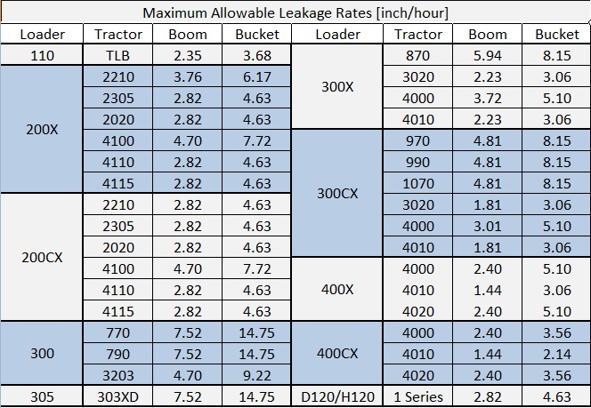

On your 420 project .... does it still leak down? Did you ever decide if the leak-down was in the cylinders or the valve?
rScotty
Loader still leaks down over night but doesn't seem to be an issue during use. The subject came up on another forum and someone produced this chart that supposedly came from JD on acceptable leakage rates. I assume it's in the SCV.

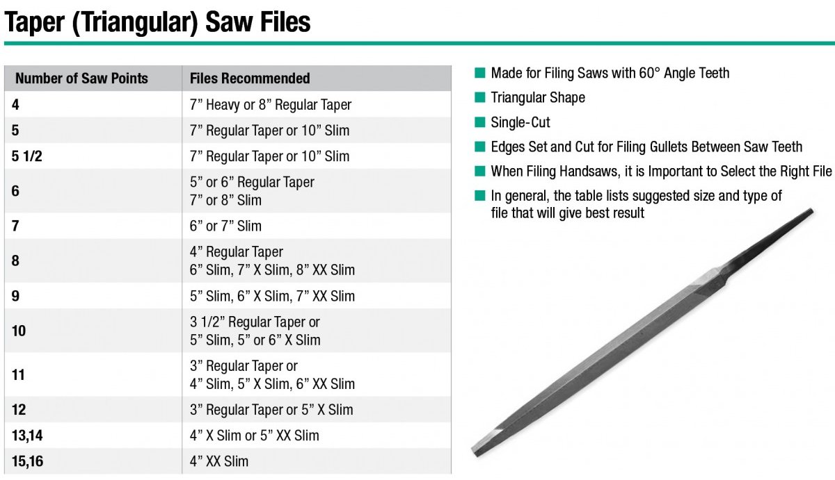

Reckon I can use a die over the threads or need to get someone professional to do it?
Large diameter threads have a lot of holding power if you get rid of the problem of the smashed part. To restore threads I just do it by hand. Sitting down at the bench with the bolt in a vise, a small sharp triangular file, and wearing reading glasses. Looking at yours, I'd say it would take about an hour of careful file work.
If you hand-sharpen your saws like many do, then bolts are easy because bolt threads have the same 60 degree included angle between the teeth just as hand saws do. And that means you can buy the perfect tool for the job at the hardware store....or at McMaster.com. What you want is a specially hardened triangular file made for the purpose of sharpening saws. You may already have one if you inherited some carpenter's tools from the last generation. Remember that files only cut in one direction, so let up on the backstroke to keep them sharp. Get a nut to fit while you are at the hardware store. It's handy for testing how the job is going.
Sometimes I will use a die to finish up... but I don't do that until it is 90% done. That part is up to you....
To shorten the job, first check for what part of the threaded area is actually used to do the fastening. If the threads stick out past the nut, I'll often taper the first half inch or more of the bolt down so that those starter threads aren't very tall. All those threads do anyway is make the nut start easier; they don't do any holding so don't need full engagement.
Here's a chart on files. The number of saw points is also in number per inch....just like threads. So count the threads per inch of your bolt to get the right size file.
I'd like to hear from others who do this type of hand repair - it works for all kinds of things.
Wow, they didn't expect much out of some of their models.
