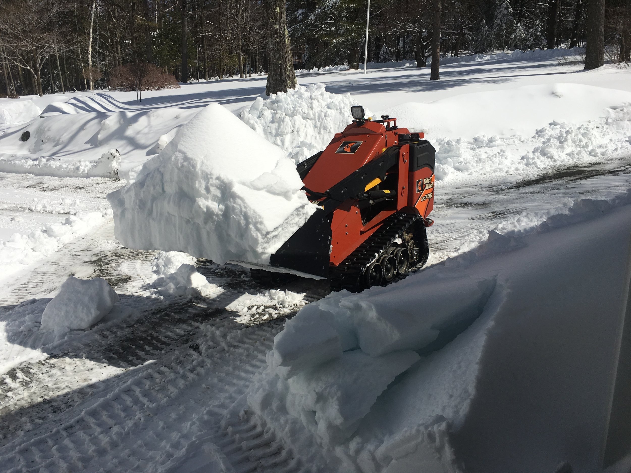

Sounds like a mini track loader would be ideal . Couldn't do without my Ditch Witch !
