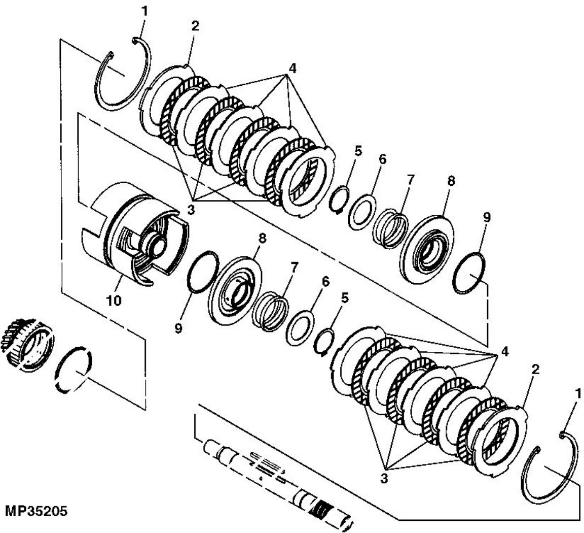

You do have shuttle shift. All shuttle shift means is you have a F-N-R shifter, usually at the left side of the seat or on the steering column that is separate from the transmission speed and range shifters. If you have to come to a complete stop to shift from forward to reverse, using the clutch, you have "non-synchro" shuttle and a dry clutch.
If you can shuttle shift between forward and reverse without grinding the gears while the tractor is moving, but still need to use the clutch, you have "synchro-shuttle" Kioti DK65, DK90 etc. among others - still with a single plate dry clutch.
A "hydraulic shuttle", "Power Shuttle", "Power Reverser" is combined with a multi-plate wet clutch and does the clutching electro-hydraulically, whether you push the foot clutch or flip the stalk on the steering column.
