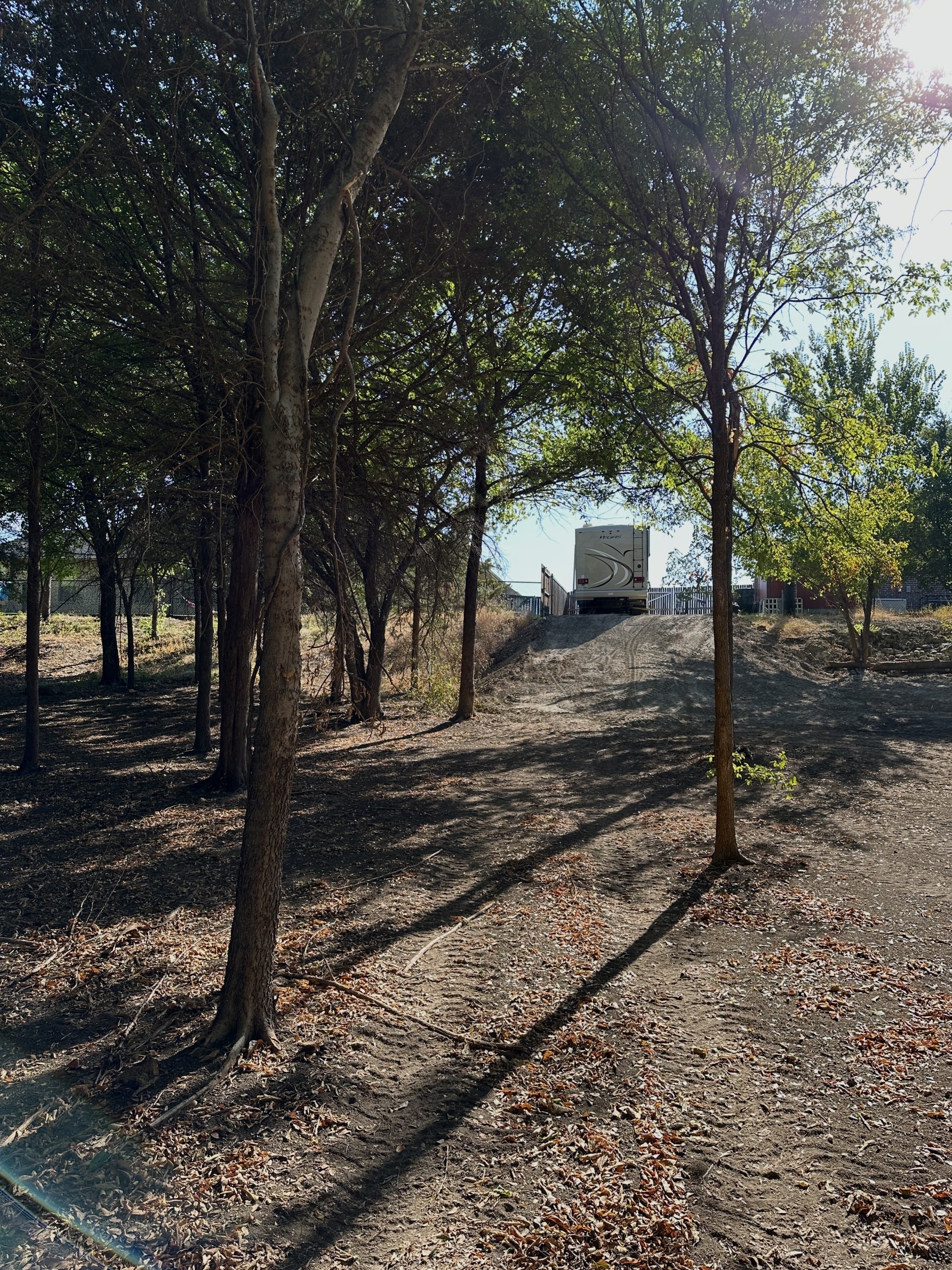

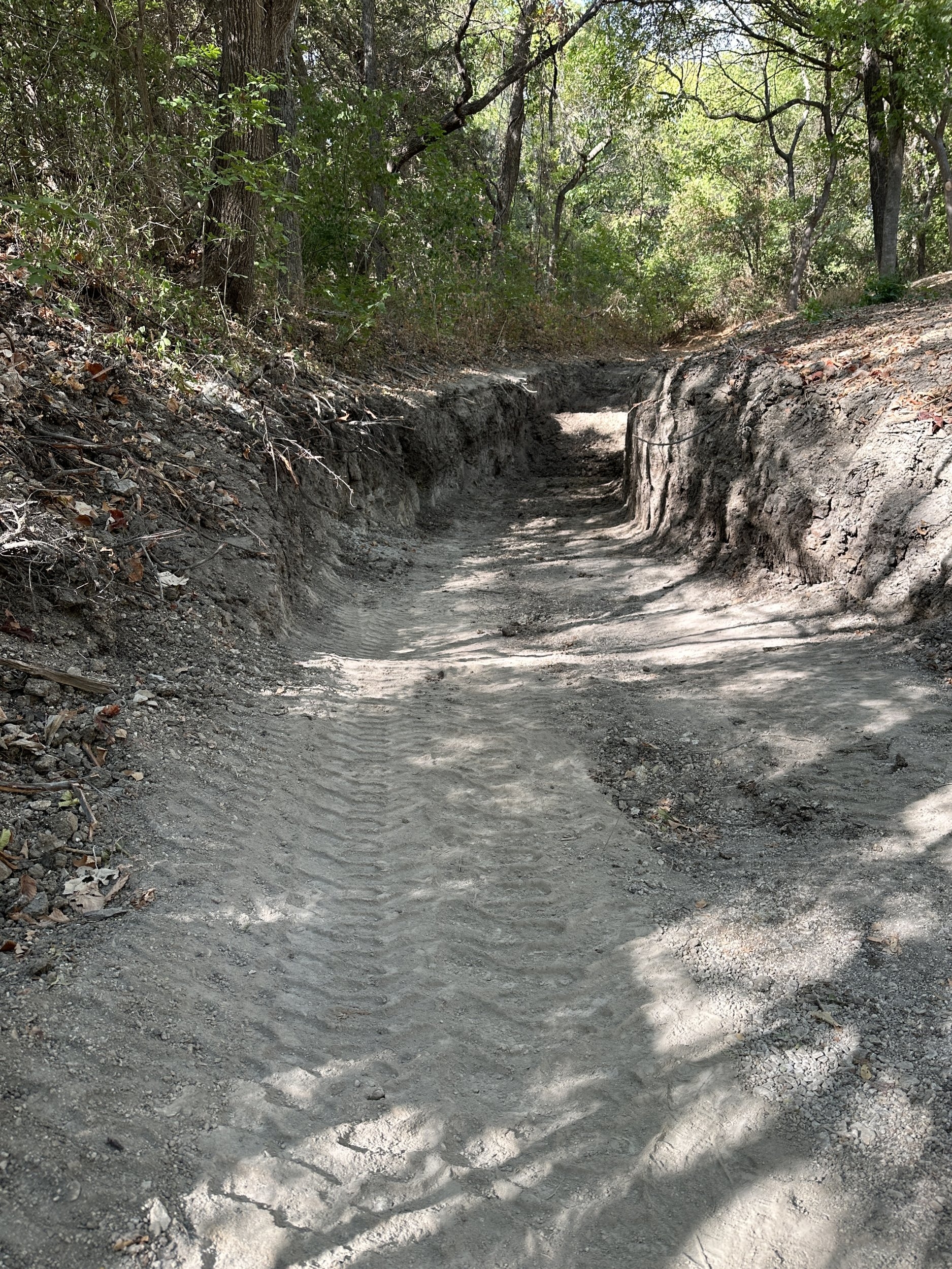

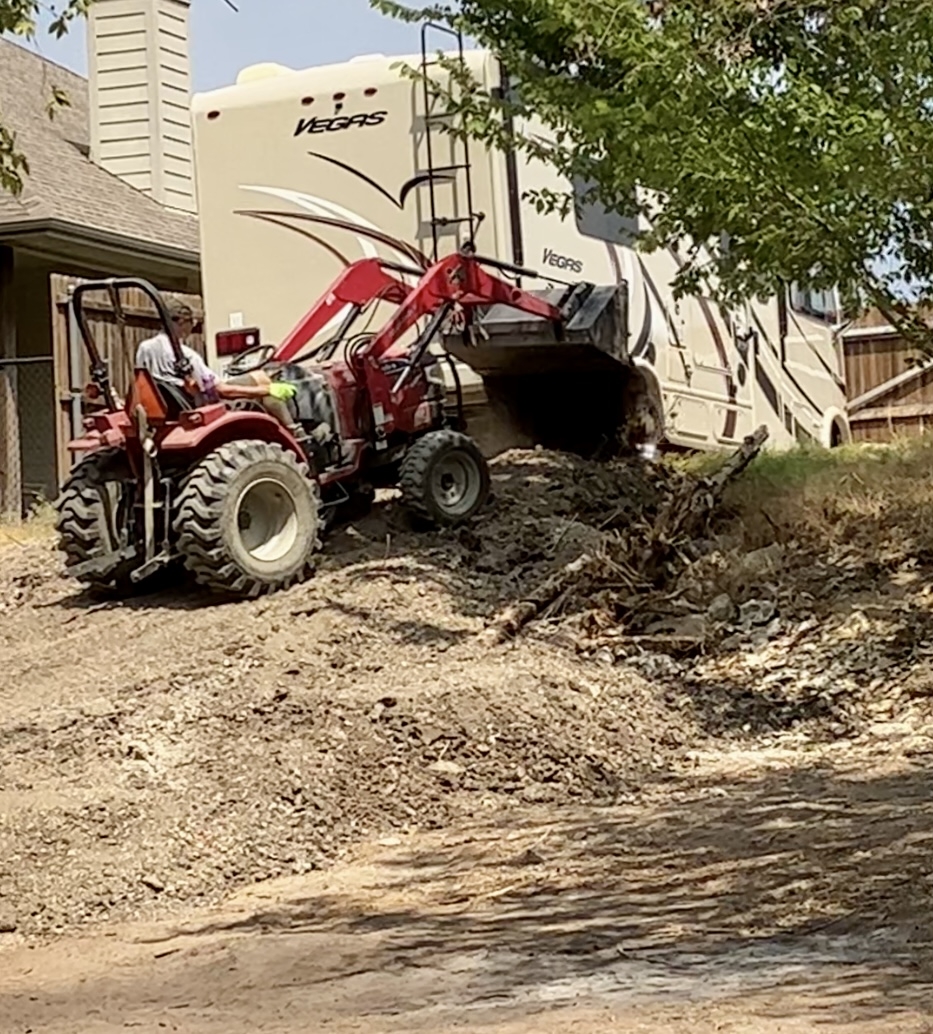

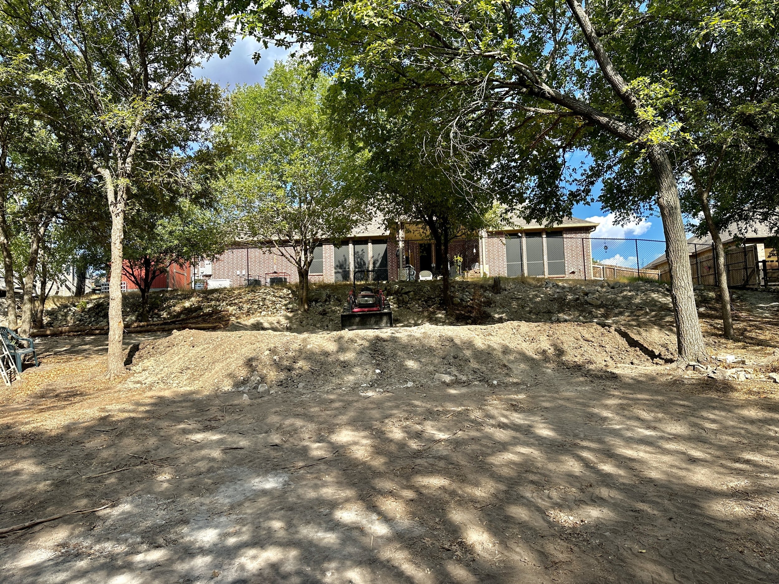

It took a couple of weeks of 8-10 hour days, but I used the Mahindra 3016 HST to dig 120+ yards out of a dry creek bed and moved that dirt up to the top of my badly sloping yard to build a driveway ramp and a 30x50 pad for my future shop.
I never pushed the tractor over 2000 RPM and only stalled the engine twice.
I’ve no experience with some of the tractors (shuttle shift) y’all are talking about and am certainly not afraid of anything with a clutch, but I think I would have been at it a lot longer without the HST.
I don’t recommend a light tractor like this for the type of soil (black gumbo clay) I’m dealing with. I’m retired, so time is all mine to use as I see fit, but I could have used a tractor that weighed another 5-700#.
I’ve got deep respect for those that do this on a regular basis.

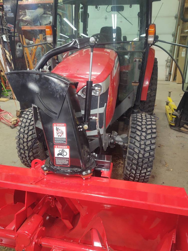

5/6 of my vehicles are sticks, but you couldn't pay me to go back to a geared tractor for what I do. I will never mow, plow, hay, etc. My current massey was available as a power shuttle, but I went with the hydro.
My tractor is used as an off road forklift, logging with skidding winch, moving brush and running chipper when i do tree jobs, and snowblowing 5 driveways with a front blower in the winter. The ability to creep, pause, and instant direction change is worth its weight in gold to me.
