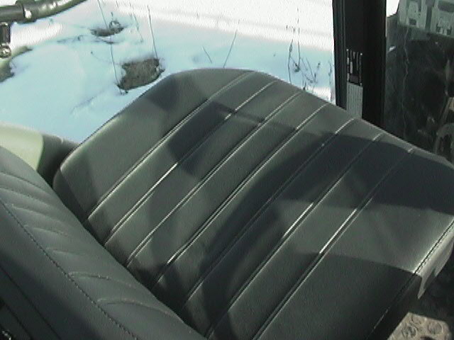

My 55 hp Zetor has a factory buddy seat

That's neat. Do you have any photos of the tractor cab, what model is it, and what is your overall impression of Zetor?
   / buddy seat or instructional seats in a compact tractor cab #7

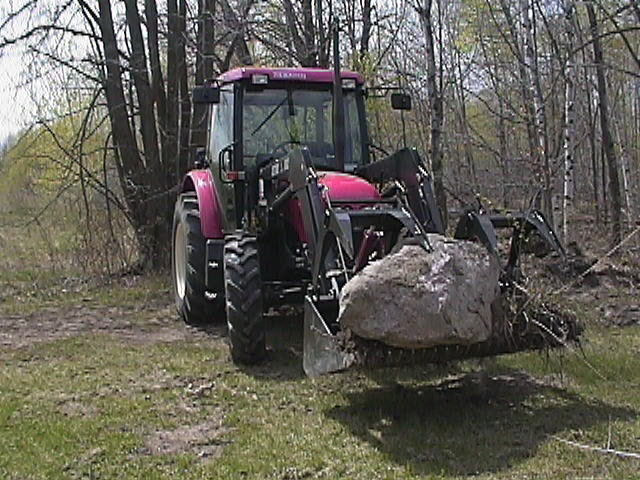

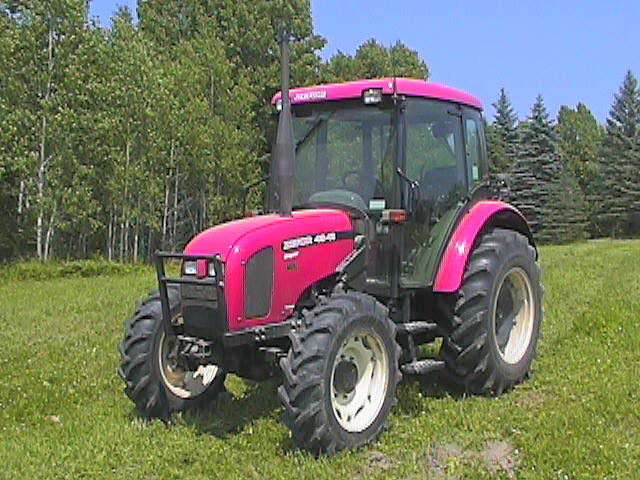

Bought it new in '04. Much cheaper acquisition than green, blue tractors. I thought the cab has better fit & finish than Massey Ferguson. NH TN's are lower profile for mowing, straddle the transmission hump. JD had the best ergonomics.
Very reliable, rugged and simple to maintain. The hydraulic clutch cylinder (dry clutch) failed this Spring & it took all of 45 mins to replace & bleed. $50 part. Zetor Tractor Parts delivers next day to the barnyard.
I do use it year round for everything with multiple attachments. New tractor with ancient tools!
