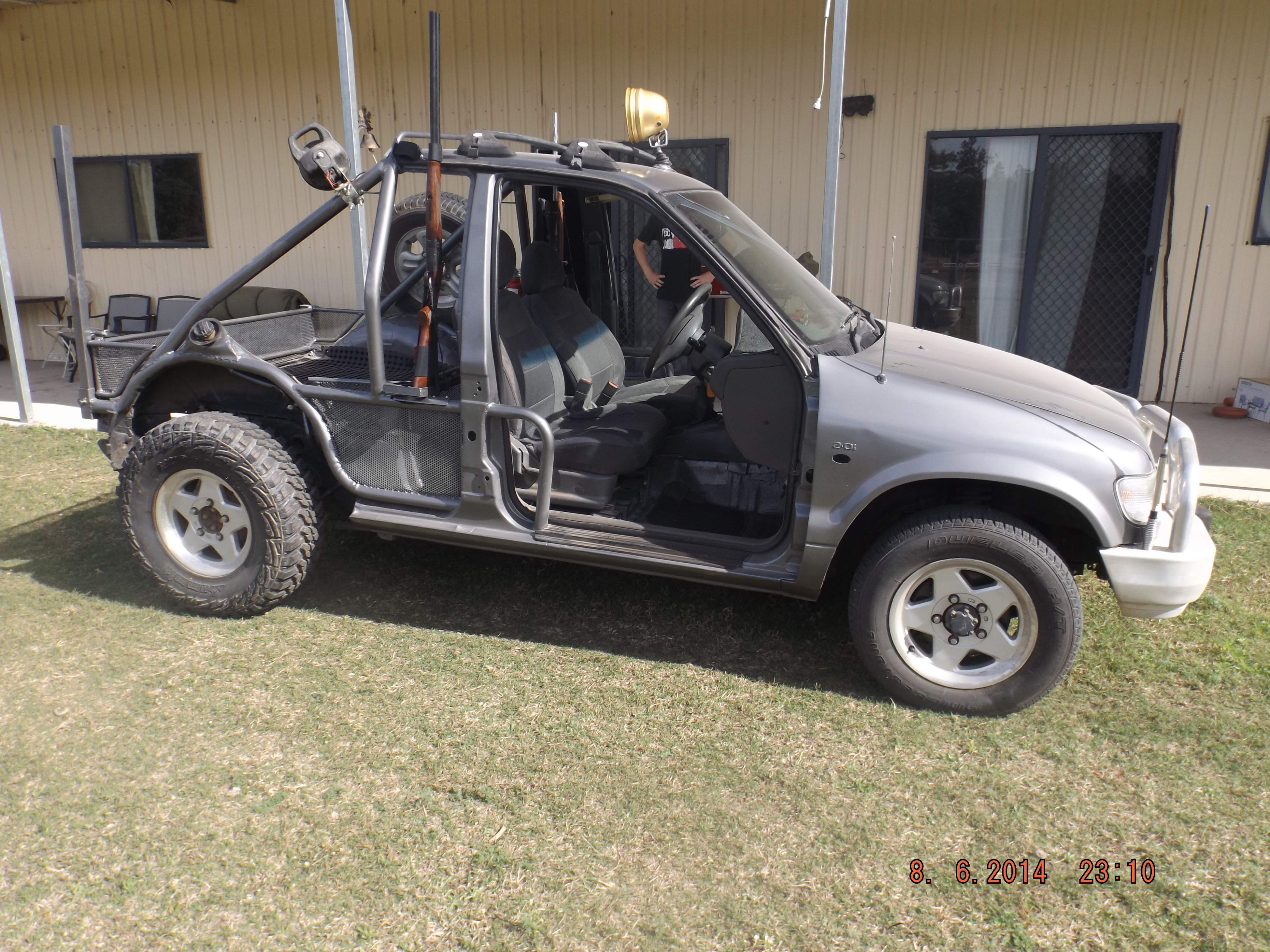

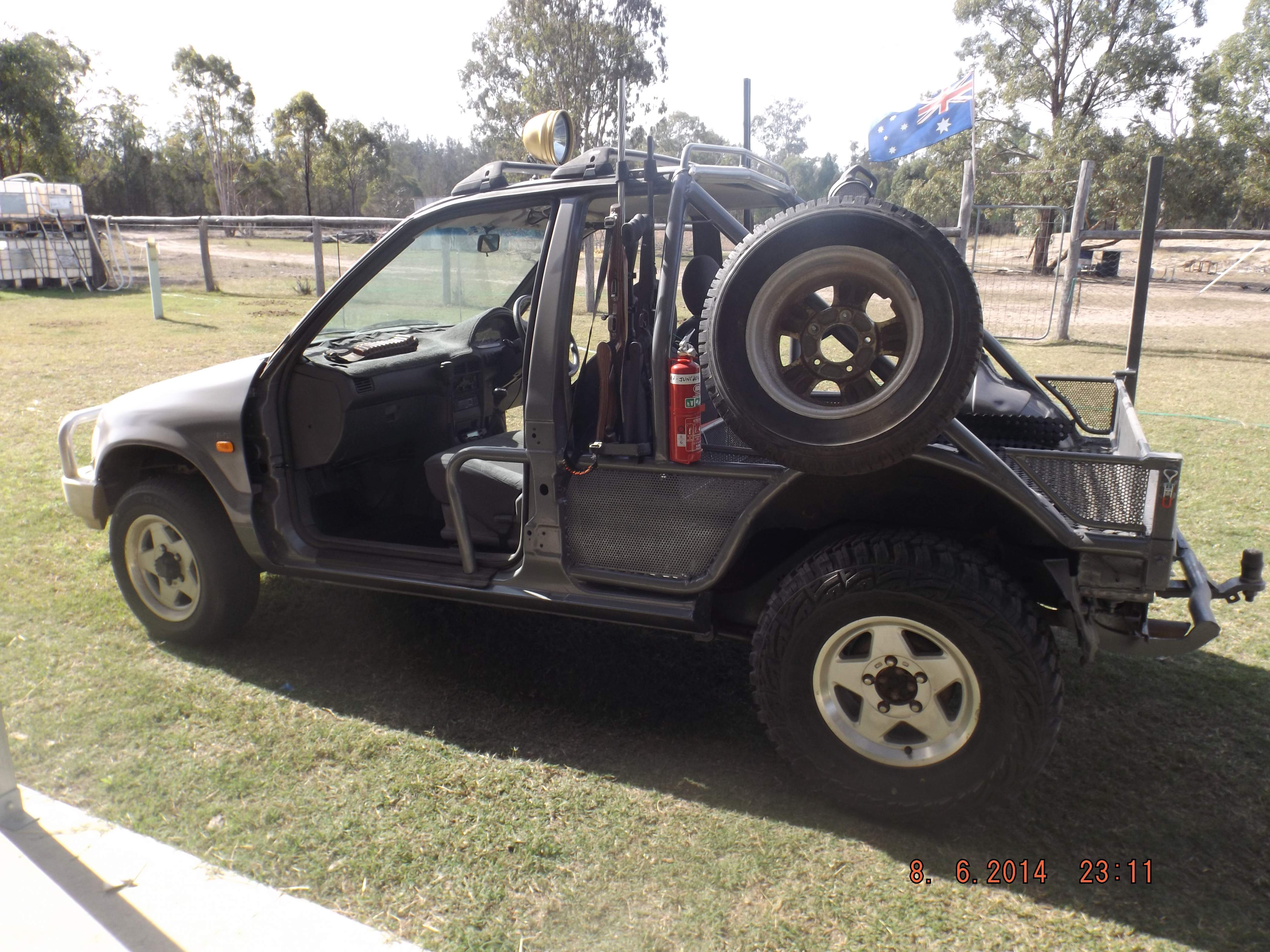

The latest pics showing the big *** back tyres out on our farm
   / Buggy build from KIA Sportage to Shooting/Farm sidebyside #14
<img src="http://www.tractorbynet.com/forums/files/build-yourself/379385-buggy-build-kia-sportage-shooting-dscf0662-jpg"/>
<img src="http://www.tractorbynet.com/forums/files/build-yourself/379386-buggy-build-kia-sportage-shooting-dscf0659-jpg"/>
You gotta run same size tires all the way around... In 4wd it will tear itself apart. Should be pretty easy to put big tires in the front too.
Yes very true....they are going to be turning at a different rate....one is going to have to slip or something is going to make it slip. That is a fantastic vehicle you built, so much more useful then a side by side. Is it street legal, that would make it even more handy. I really like it.

No not road legal, our transport rules are almost as bad as our gun laws.
