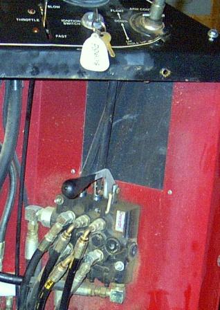

The rods go to my front-end joystick and the little lever is the attachment lock. My backhoe looks just like this with two joysticks and 2 of that same little lever for the outriggers.
   / Build A Backhoe For PT425... It Could Happen
#102
Yes. That's the same way the PT425 is set up. All options are open right now. /forums/images/graemlins/wink.gif

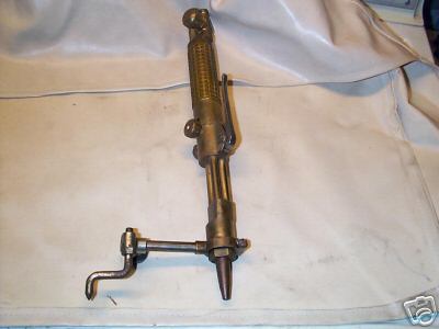

You could make yourself something like this. See picture.
I simplified this ever further by using a coat hanger bent to shape and did a credible job..

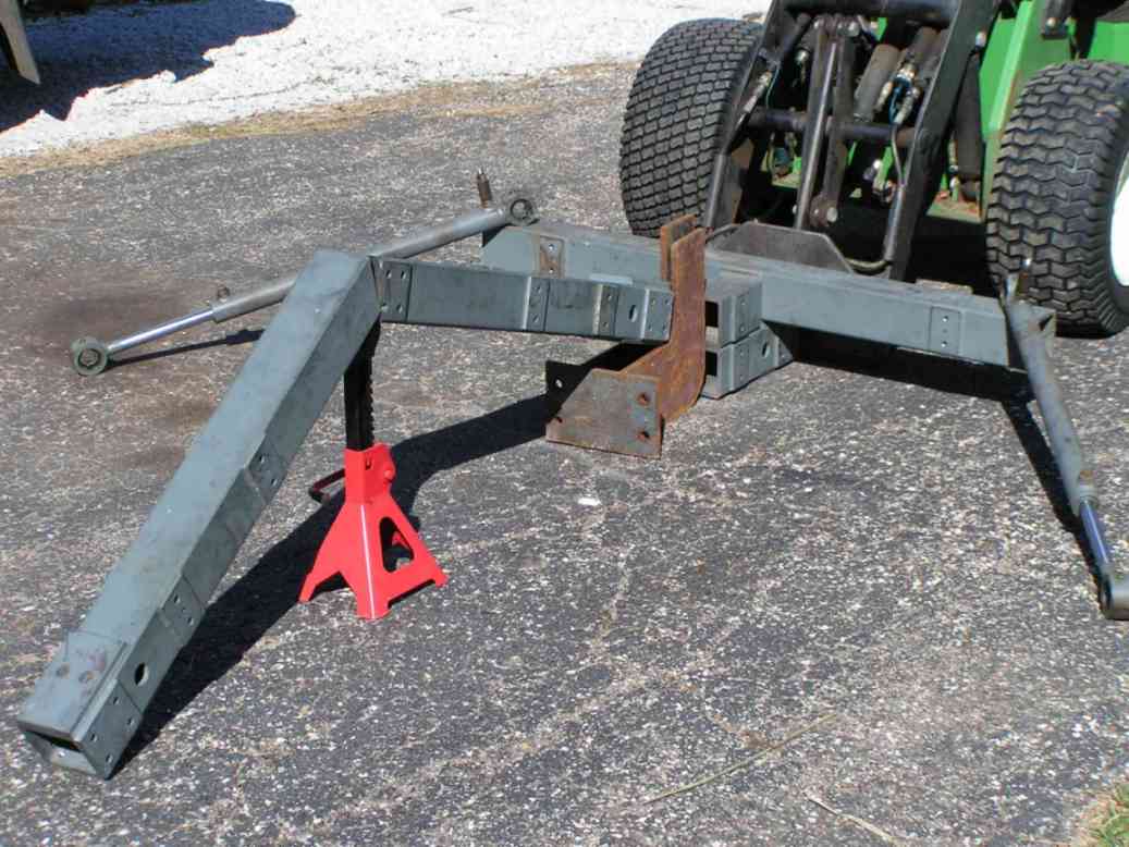

O.K. folks, try to use your imagination.... see attached. /forums/images/graemlins/wink.gif
#110
A little more info...
The gap above the red jackstand is the bend in the main boom. That gets welded solid.
The dipper stick, bucket and linkage are missing from the picture as are almost all of the hydraulics, seat and outriggers.
I have some very heavy C channel that I think will make excellent outriggers that will go under those long cylinders. I may not use those cylinders because they are so long. We'll see how the budget goes. I have four of those cylinders and they, too, were FREE! /forums/images/graemlins/grin.gif
That rusty hunk of metal I got from a scrap yard this morning. I went looking for 1/2" plate, but they only had 1" thick diamond plate about 15"-16" wide and 6' long and I couldn't lift them. They are too big for my needs. Anyhow, that rusty piece is 1/2". The directions call for 3/8" so this is a little beefier. I will cut both of those angled pieces off that base plate, make them the same length, turn the base plate 90 degrees and weld them back on. Then all I have to do is find some more plate and make the box and tube for the pivot pin receiver section.
I'm still trying to decide if I want a long frame or a short frame.
Short frame PROS:
1. Keeps the implement size down.
2. Operator will be protected somewhat by ROPS of the tractor.
Short frame CONS:
1. Will have to make some sort of FEL lift lockout device, as I could see being crushed between the seat and the ROPS if the FEL joystick is accidentally pushed backwards and the backhoe seat rises.
2. Shorter frame means shorter lever means more stress on the PT holding it down.
Long frame PROS:
1. PT will have more leverage to hold it down.
2. Less stress on the PT.
3. More weight means less jumping around.
Long frame CONS:
1. Unit will be almost 5' longer, requiring more storage spaces and limiting where the unit can fit in tight work areas.
2. No ROPS protection.
If you folks think of any more PROS and CONS, please let me know. Another thing that will be added is some sort of kill switch that can shut down the engine from the backhoe. That was suggested by the person that made the instructions and I think it is a great feature.
In all honesty, if it weren't for the time I have to wait for the saw to make the cuts, I only have about a half an hour in this so far.
Total amount out of my budget so far... $13.00 for that rusty piece of steel. /forums/images/graemlins/cool.gif
