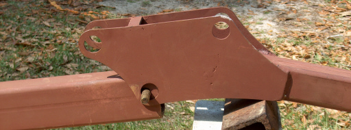

David, This picture is for your consideration. You have to have a certain ratio of push point. pivot point, and dipper stick length. The more length on the short side of the dipper stick the more power you will have at the bucket. The ratio seems to be about 1 to 10. I am not saying that the one I built is correct, but it looks about right.

   / Build A Backhoe For PT425... It Could Happen #122
Using a pivot.
With a 1 to 1 ratio, a push of 5000 lbs will give 5000 lbs push.
With a 1 to 10 ratio, a 5000 lb push will give a 500 lb force at the end of the dipper stick.
With a .5 to 10 ratio. the push would be 250 lbs
I believe this is correct.
#123
The plans call for a dipper stick length of 60". The pivot point is 12" down from the top. So, that is 1 foot on one side of the pivot and 4 feet on the other. So will 1000 pounds of push on the short side give me 250 pounds of push on the long side?
#125
Yes, I unserstand that, too. Good points from everyone so far. As for beefing it up, this this is pretty beefy for a PT425. /forums/images/graemlins/wink.gif
#126
J_J,
How thick is the steel on those plates attached to the tubes?
   / Build A Backhoe For PT425... It Could Happen #127
Those plates are 1/4, with support bushings around the holes.
