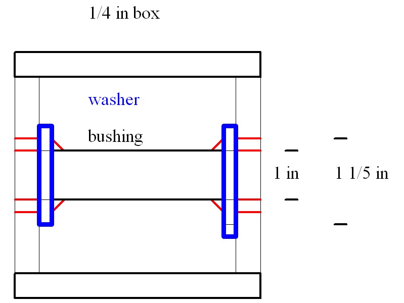

The plans that I have call for bushings on the outside, but the big 1" pins are then pinned through the outside bushings so they can't rotate. This would seem to indicate that the outside bushings are there for supports and strengthening so the pins have more than just the 1/4" wall to rest on. So, I will be using them where the plans call for them.
One more thing I noticed about that plans, and maybe I should re-read them again, is that they call for lots of 1" holes and welding of the 1"ID tubing inside of the 4"x4" tubing. I don't see how I could weld around the entire 1"ID tubing inside those square tubes. At best, I could only weld 180 degrees. I'm thinking of making the holes 1.5" and fitting the 1"ID tubes inside and weld from the outside, with beveled edges as we talked about the other day, then grinding the area flush. That seems it would be stronger for two reasons... 1. the weld would be 360 degrees around the 1"ID tubing and 2. the 1"ID tubing would be supported by the 1/4" wall of the square tubing AND the weld, not JUST the 180 degrees of weld that the plan calls for.
   / Build A Backhoe For PT425... It Could Happen #159
David, You are correct on most every thing you said, except I would not make the hole any larger than 1 in. That pin and hole set up, has to be aligned perfectly. I found out the hard way, when I attempted to hook up the hydraulic cylinder, and the bushing was skewed a little and that make the cylinder not center up. The trick here is to have the hydraulic cylinder on the pin before you tack weld. You probably know to tack all around, or the heat will pull or twist the bracket one way or the other if you try to weld one side completely. On the bushings on the inside of the 4x4, I could only weld about 180 degrees on the inside. Your idea of making the hole larger would work only if you could put the bushing inside the 4x4 with two 1.5 in heavy duty washers. then push the washers to the inside of the 4x4 and weld 1/2 of the washer to the bushing, then role the bushing 180 degrees, and weld the rest of the washer to the bushing. You would have to center the 1 in bushings in the 1 1/2 in hole. Now you have some metal around the bushing to weld the bushing, washer, and 4x4. Then you have to grind every thing flush so the dipper arm or what ever will slide on the 4x4. That is a lot or work. I would just bevel the bushings and the hole, and lay a good bead around the hole, and do the 180 weld on the inside. See if this drawing makes any sense. Red is the welding points.
