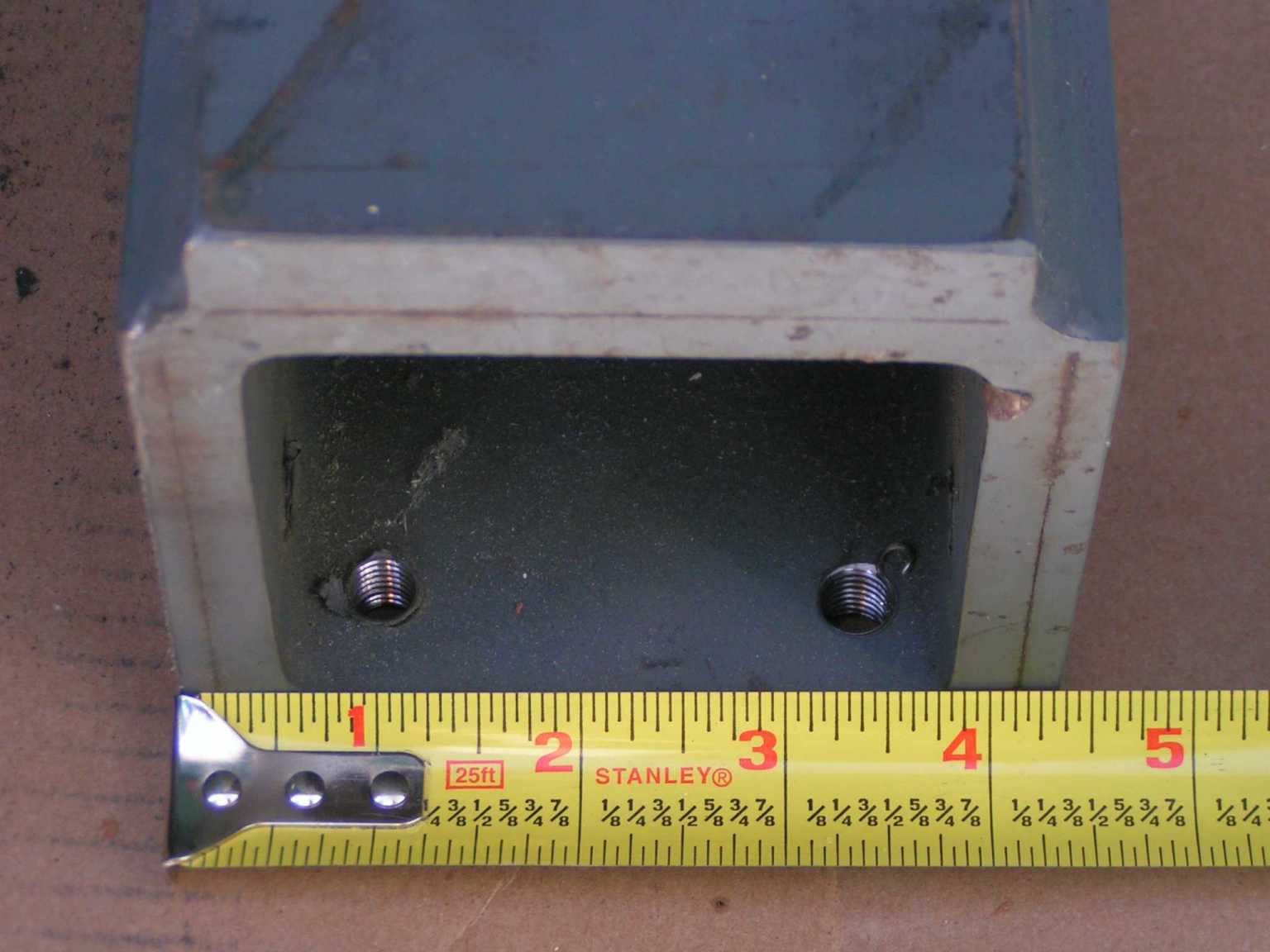

Here's some pictures of some of the steel that I want to use. This first one is the end of the square tubing. After measuring, it is 4X4X1/4. There are plates welded to the ends around all sides for re-inforcement. Both ends are the same.

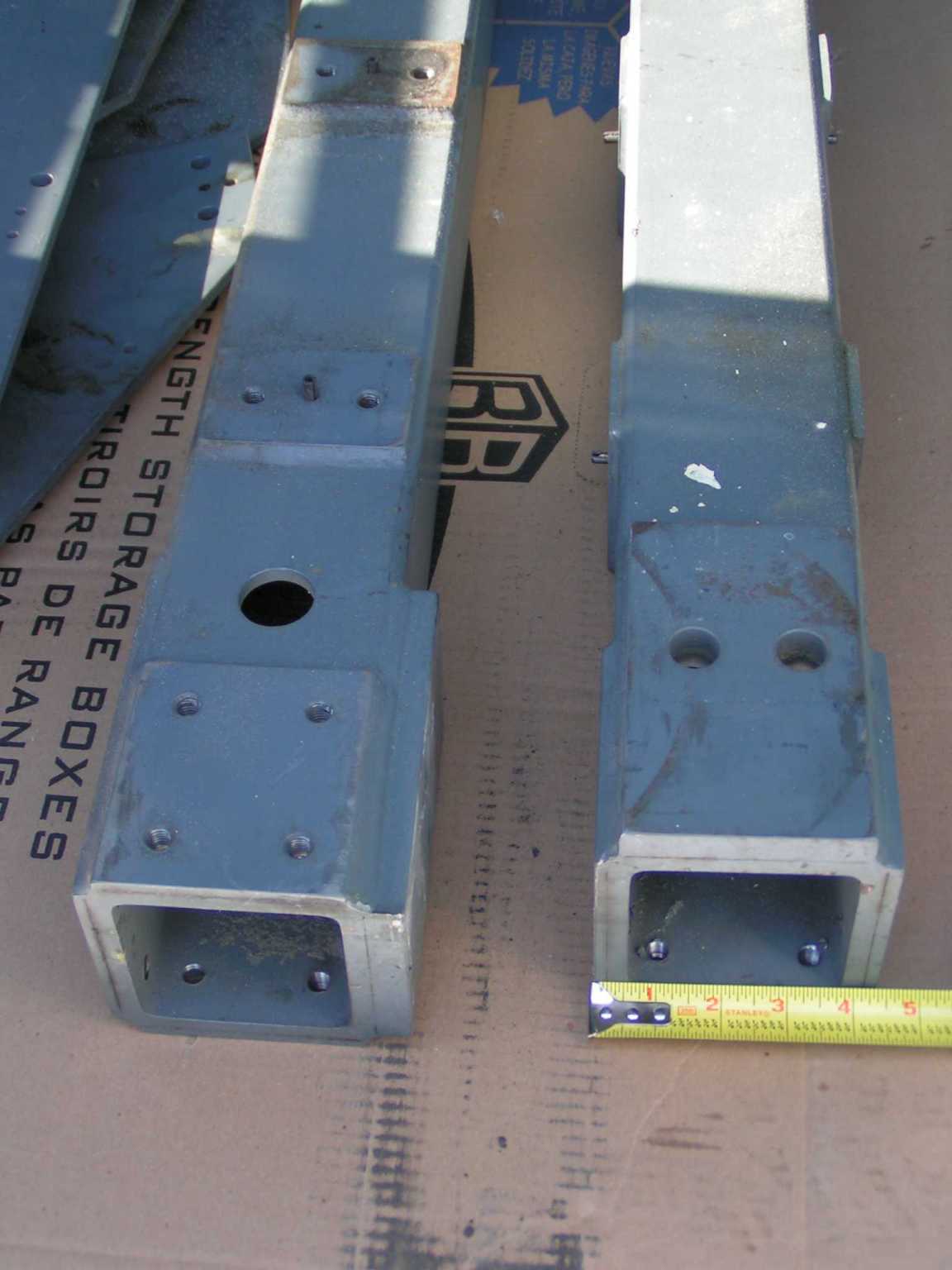

#14
This next picture is of two of the steel tubes next to each other. One is rotated 90 degrees so that we can see what is on each side. All four tubes are identical side for side and end for end. I don't know if any of the holes will be useful or not, or if the reinforcing plates will be a help or hindrance, but free is free /forums/images/graemlins/tongue.gif
That large hole measures about 1 and 1/8". The tubes measure 74" long. The plans call for pieces of considerably less length, so if I decide to use the reinforced ends or not, I will have enough to get pieces with or without.

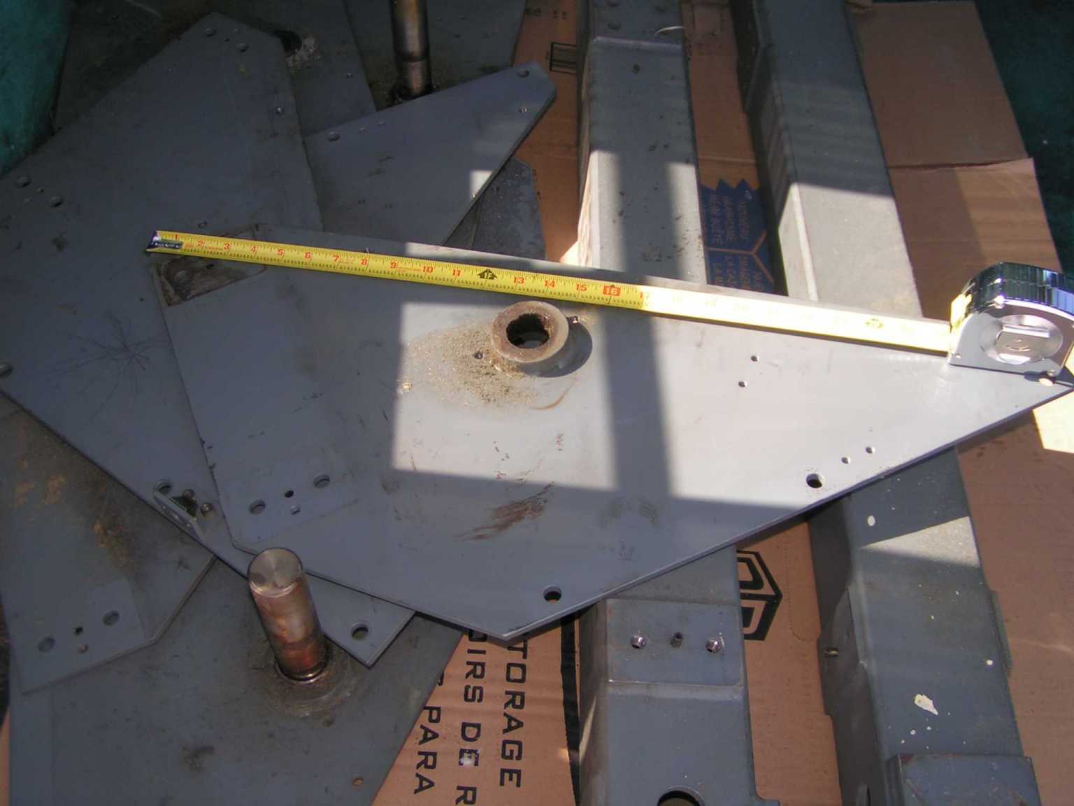

#15
This last picture for now is of the triangular pieces. They are 12" tall and considerably wider than the 18" that I estimated... almost 30"(jeepers, I was off on that!). The large bushing in the center of the plates appear to be a bit over 1 and 1/4". They may be metric. Not sure. The plates measured out at 1/4" thick.
That's all for now...

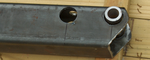

   / Build A Backhoe For PT425... It Could Happen #16
David, This is a picture of the bucket end of the 4X4 with the 1.5 in holes cut out. These can be cut with a plasma cutter, torch, or drilled out. Then you weld in the bushings, keeping good alignment. A good 1 in reamer is good to have. Some use one inch rod for the pins, but I used grade 8 bolts.
