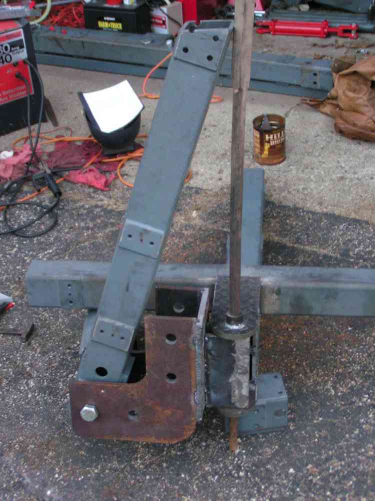

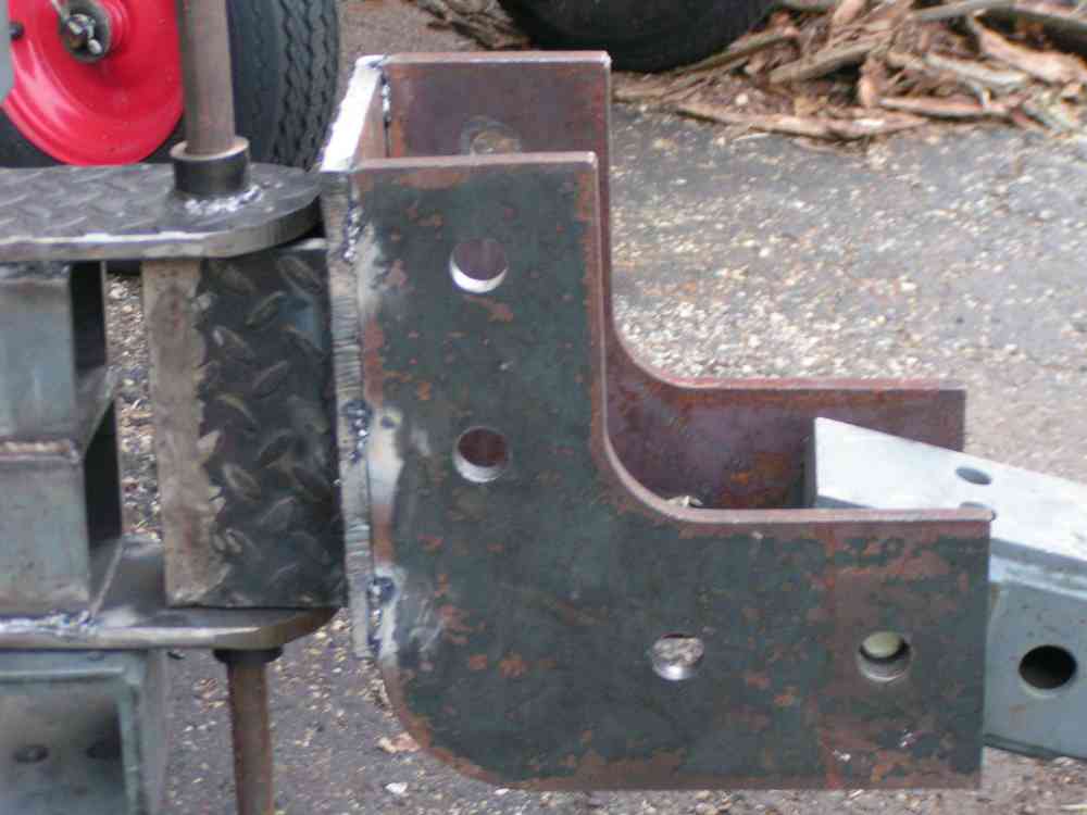

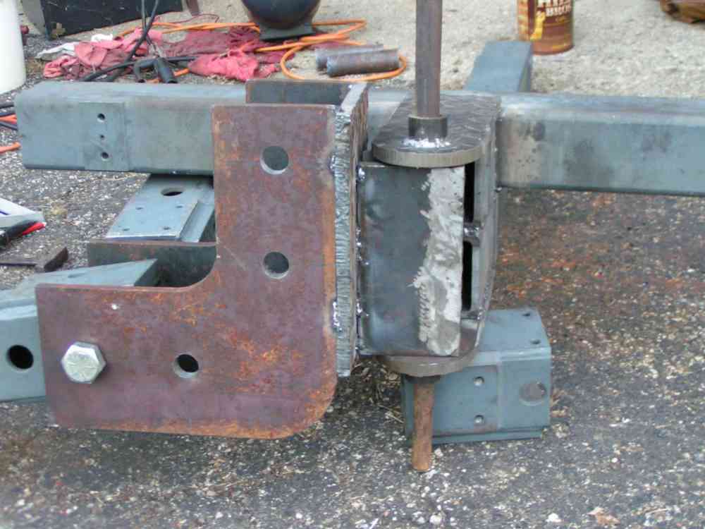

Here's some pictures of today's progress.
It pivots veery easily on that fine digging bar that I am using for a temporary pivot pin! So easy, that it will flip right around and hit you if you aren't careful. The boom lifts well past vertical and is also very easy to move. The entire boom assembly will pivot a bit over 180 degrees. Pretty nice. I'm not sure how to make the linkage go all the way to 180, but I think I can get it 90 to one side and probably 60 to the other.
J_J, if you read this, how many degrees of pivot do you have? Can you describe the pivot linkage?
David, I don't think I get the full 180. It's more like 80/80, I am thinking about making one side a full 90 degrees. I will just have to switch the turning cylinder to the other side. for working in that direction, or just turn the PT around. Some machines use two cylinders to turn the boom. You will probably have to do some trial and error. I will be out of town for a week , renunion, etc in S.C.
