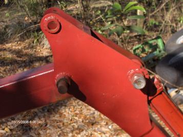

MossRoad said:
Well, so much for waiting two weeks... the kids worked on their projects unsupervised with no problems, so I got to work on mine again. :)
Finished drilling the holes for the dipper stick cylinder and mounted it and the rear brackets. Tacked everything in place and tested for articulation... man, it swings smooth! :D
This is the 10" cylinder. I could probably go 12" or 14" without any modification, but I want to make sure that I cannot accidentally hit the backhoe pivot point or boom as J_J mentioned that someone he knew did this and damaged the boom cylinder. While my boom cylider will be on top, I still don't want to be hitting anything. I think I will use the 10" and see how it operates. If I am dissatisfied with it, I can always add a longer cylinder, or I have another choice... It is currently set for maximum lift height, which will also give it maximum depth while sacrificing the ability to dig close to the tractor. I could put another set of holes closer back to wards the tractor on the dipper brackets. I could then sacrifice lift and depth for digging closer to the tractor. It would just be a matter of removing the pin and relocating the rod end to another set of holes. I think I'll leave it as is for now and only make the modificaton if I need it.
Oh, yeah, I forgot... here's some picture goodness! :)
Running totals:
Time = 26.5 hrs.
Approximate Cost = $380
David, In picture # 02, is that the setup that you will be using, Something seems wrong to me. The geometry doesn't seem right. Here is a picture of mine. This is the dipper arm end. The cyl on the right will push or pull the bucket.

   / Build A Backhoe For PT425... It Could Happen
#318
Yes, that is the way it looks for now. The brackets are overly large. When I get a few minutes, I will superimpose mine onto yours and then show you what could be cut off mine without hurting anything.
The first time I looked at it lying on the ground I about cried! I thought I had just welded everything on backwards!!! :eek: :D
But it passes the articulation test, so that's the way it will stay. :)
   / Build A Backhoe For PT425... It Could Happen #319
David, Will that 10 in cylinder allow the dipper section to fold up with bucket curled as in trailering and stowing?

Probably not. I think I will need a 12 or 14 for that.
