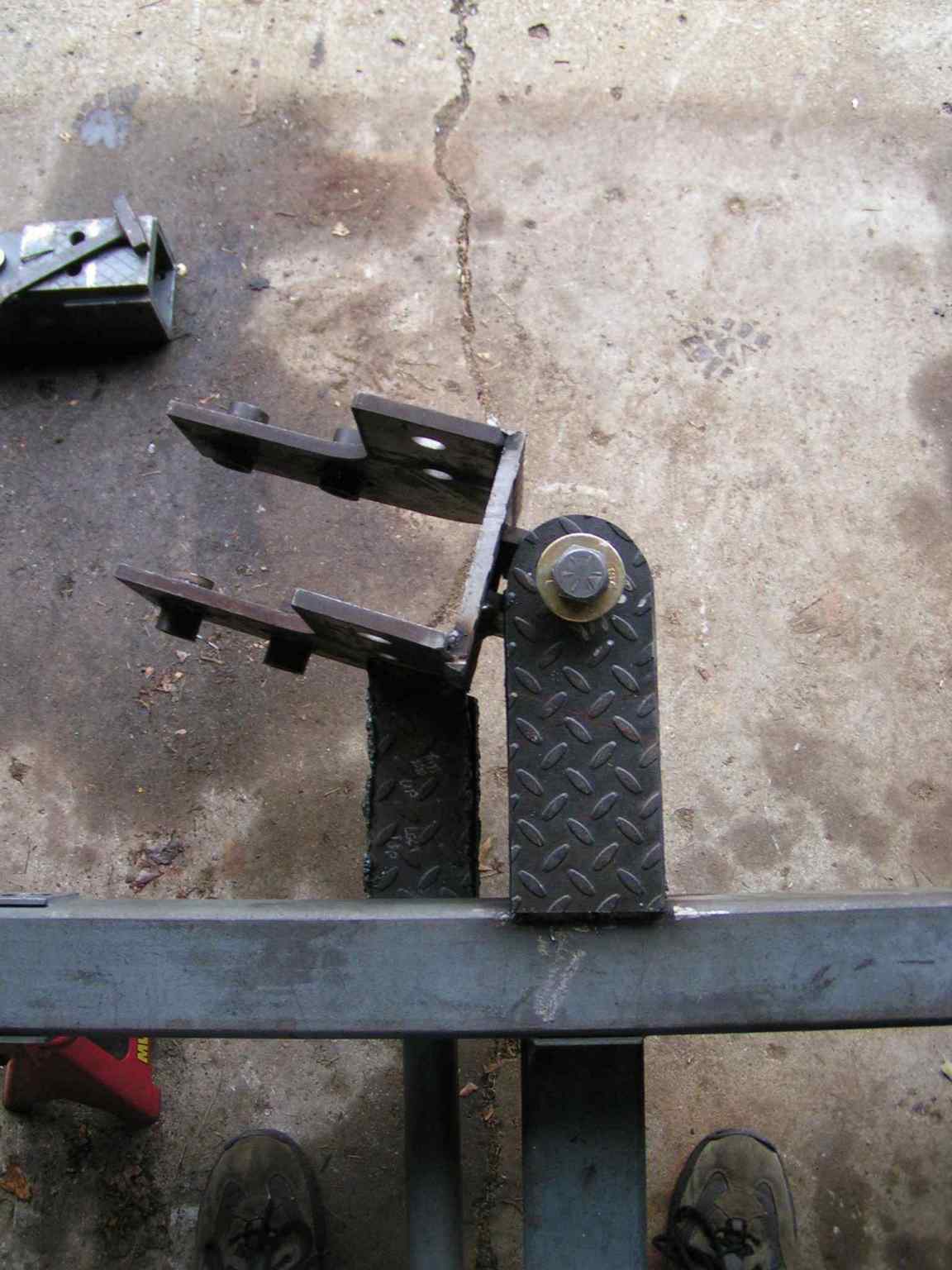

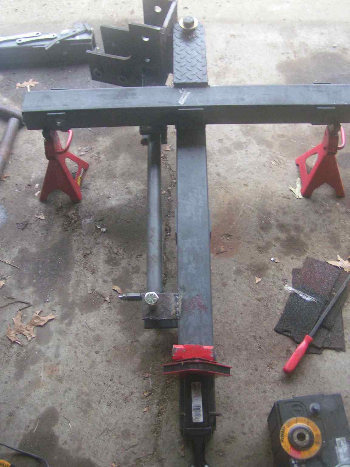

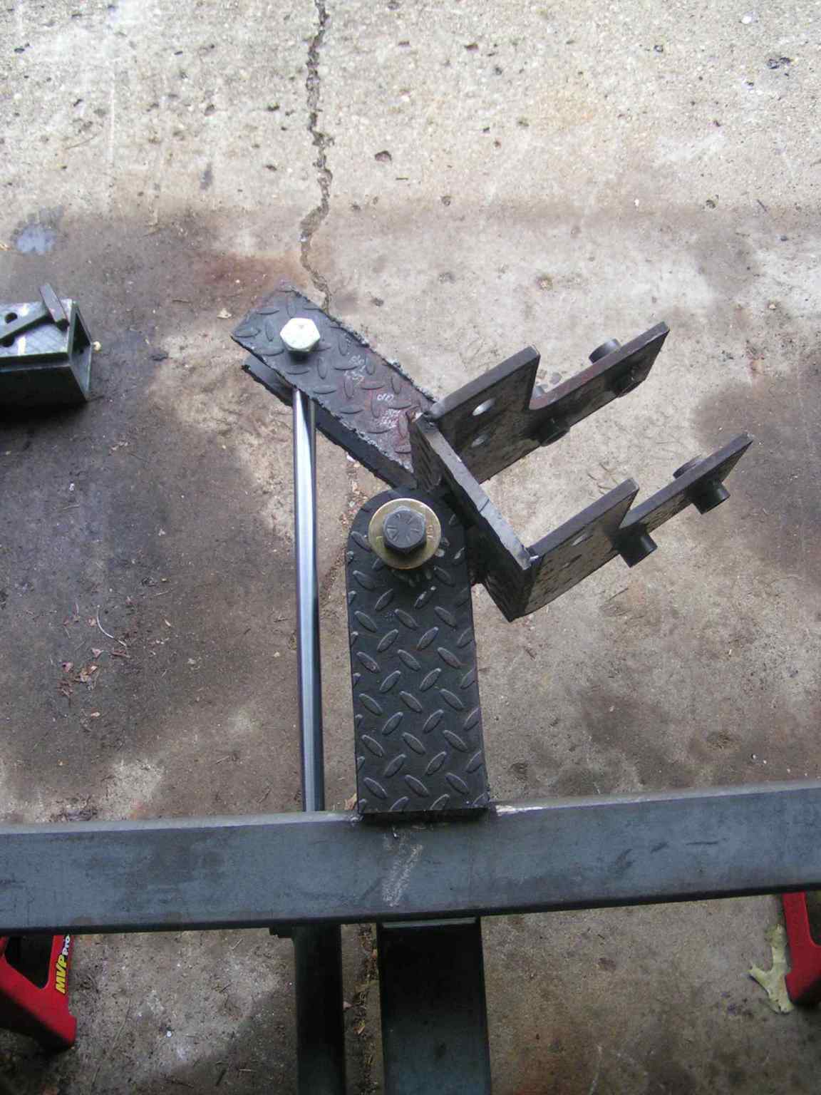

A few more hours and a few more pics...:)
Attached the left swing cylinder brackets and tested for movement. O.K. After I took the pictures, I attached the right swing cylinder brackets and tested for movement. Not O.K. :p I am having trouble making the brackets in the same plane. If I had the ball joint ends similar to what PT uses, I would be done. I am checking Bailey's and I think they have them for about $20.00 a poke. It may be worth ordering some to get this part finished.
It was HOT today. And very humid. I found an old window air conditioner in the back of my garage and plugged it in next to where I was working in the garage. That, and a couple-three quarts of ice water kept me going. I was soaked after using the torch, cutting holes, welding and grinding. :mad:
Running totals:
Time = 30 hrs.
Approximate Cost = $380
