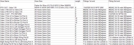

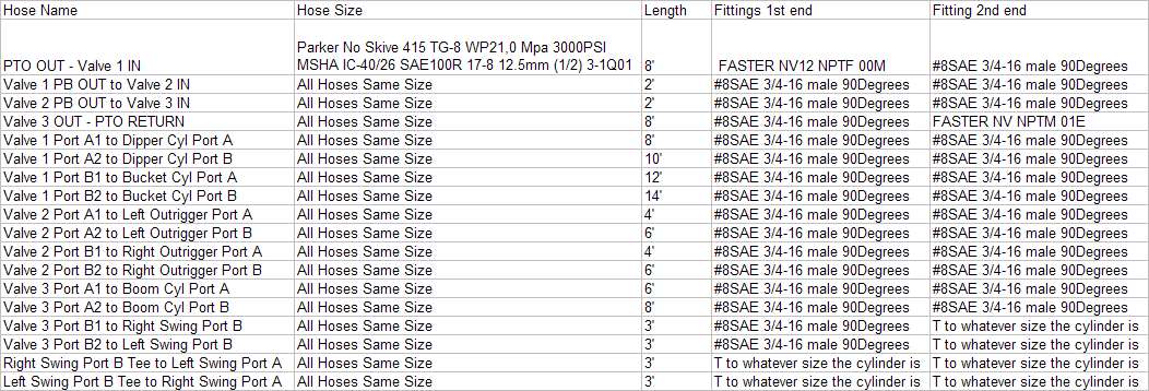

Attached is my hose sheet that lists all the hoses and fittings I should need. I still need to figure out what type of fittings the swing cylinders will take.
David,
I had to bite the bullet, and ordered the same valves that you have. I still have a stock pile of various valves. According to your chart, you say that SAE8 is 3/4. Is that correct? I thought SAE4 was 1/4, SAE6 was 3/8, and SAE8 was 1/2 , and SAE 12 was 3/4. Those joystick valves are o-ring SAE8. They also say if you use quick disconnects, go one size larger because of the restrictions in the sealing setup. Most of my cylinders take a 3/8 fitting, All my fittings will be JIC-37..
   / Build A Backhoe For PT425... It Could Happen
#398
The website and the PDF documentation list the ports as #8SAE (3/4-16). They are the same port size as my hydraulic cylinders. I'll find out for sure some time soon, if I get some time to get down to the hydraulic shop here in town. I have a pretty full plate this week. My daughter is in a school play and several festivities and ceremonies leading up to 8th grad graduation. :)
I think the 3/4 -16 is the thread, not the hose size.

J_J said:
David,
This is the fittings that I am planning to use on the valves, which is a JIC-6 to a SAE8 o-ring fitting, which is 3/8 to 1/2 . I think.
