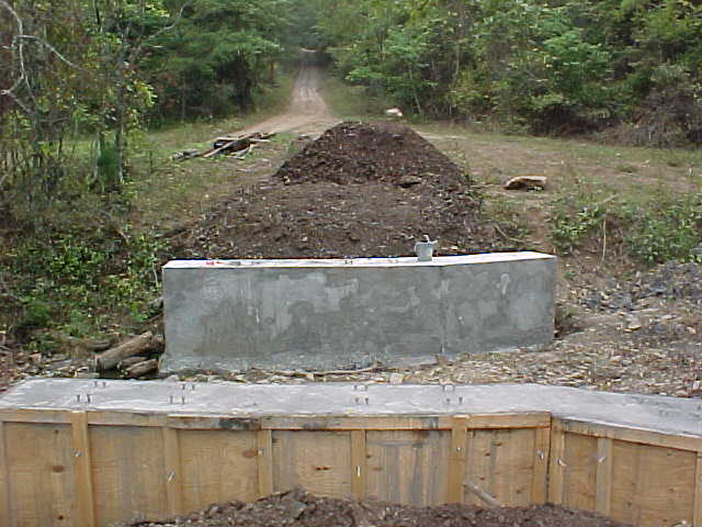

#11
another shot of the opposite bank while the concrete is still curing.

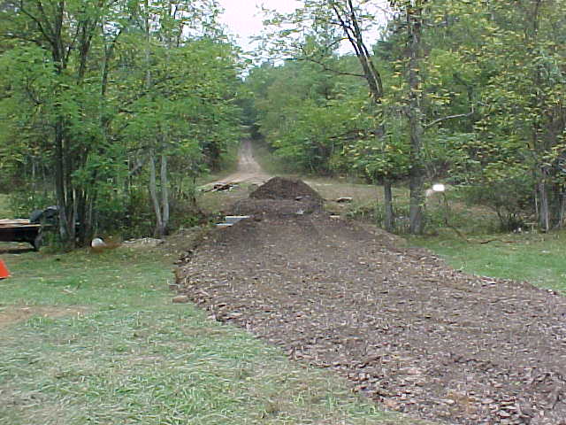

   / build a bridge, get over it
#12
shot of the driveway after a little slate poured down
#13
another shot after slate being poured
   / build a bridge, get over it #14
What kind of beams did you use?
   / build a bridge, get over it #15
Are you getting over it yet? What is going on top to cross over the abutements?
#16
I used 12/26 I-beams twenty feet long. I decided to used four beams, two inside a standard car wheels and two on the outside. two would have been enough. but i like to over build everything i get my hands on. guess than is the eng. coming out in me.
