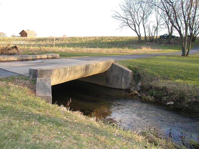

The weather was decent here today, and the sun was at the right angle to get a shot of our bridge. It was built in 1989. The shape is as designed by the engineer, and if viewed from the top, it is slightly trapezoid-shaped to compensate crossing the stream at an angle...................chim

That is a heck of a bridge for sure. And after seeing this I don't see why I couldn't have one put in on our creek. This creek that runs by your place does it run all year and with good high rate flows sometimes? Again very nice

Darin, the picture shows the creek with the flow a bit higher than normal. A heavy rain brings it higher - about cuts the clearance between water and bottom of bridge to half of what shows in the picture.
Water goes over it (and the driveway) anywhere from 0 to 4 times a year. There's enough flood plain that once the water gets high enough to get over the banks, it almost never gets above the 6" curbs of the bridge. The origin of the creek is about 2 miles away, so it doesn't drain a huge area when it rains. That's why it doesn't generally stay out of its banks for more than a few hours when we get a flood.
We had a drought here in PA this year, and the creek slowed to a flow that a 6" pipe could have handled. There was one Summer about 6 or 7 years ago when it totally dried up for a few weeks. It felt kinda odd to be able to walk the creekbed in sneakers to whack the weeds on the banks..............chim
