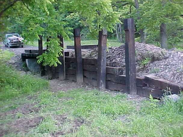

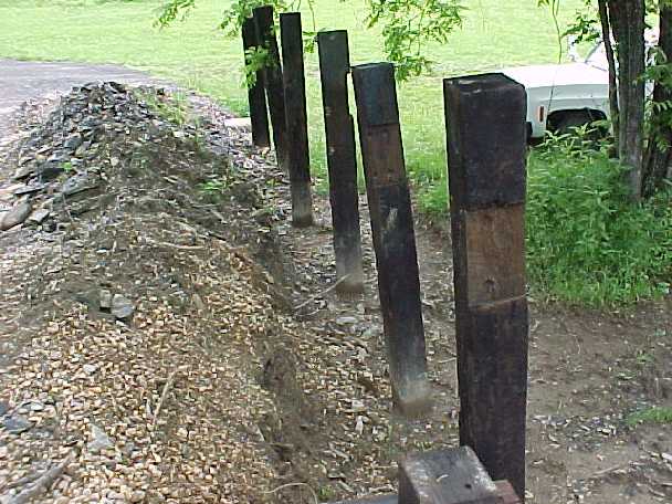

I had trouble getting dirt to pile up to the proper level i wanted, so i desided to build a retaining wall for the dirt. i rented a post hole digger and sunk rail road ties as far as the post hole digger would go. shear pin would break at about 4 to 5 ft, solid slate does that. /forums/images/graemlins/grin.gif

#66
Re: another update on the bridge project
picture from the side

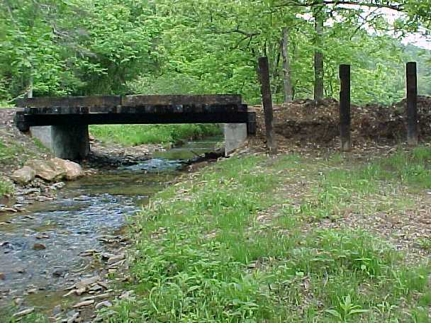

here is a photo showing the ties stacked up on one another, i stagered 10ft and 14ft ties and drove rebar through them to hold them together. as you can see i still am piling dirt up to get where i want it.
If you get flooding, do you have any culverts or anything to allow water to pass through your retaining wall?
You may have answered this in a previous post, but do you have the current cost of your project?

actually i do have one 10" drain pipe at the low end of the wall just incase water does get up in the field.
cost is a little over two grand for materials, but labor, boy there is the real cost.
