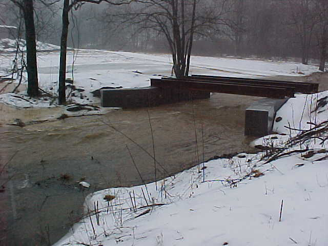

bridge with first real test
With all the snow and rain we have had my bridge got its first real test of high water, the water is about two feet deep here and moving very fast. bridge did very good, but this was not as high as flood of 85 would have to add about another foot of water to match that level.

I love that bridge. It appeals to the puttering desire to build in me! /forums/images/graemlins/grin.gif Nice work!

Nice job, can't wait to see it finished. If you had not hit solid rock when digging for the foundation, how deep would you have had to go for proper support. I am considering a similar project in the future.
