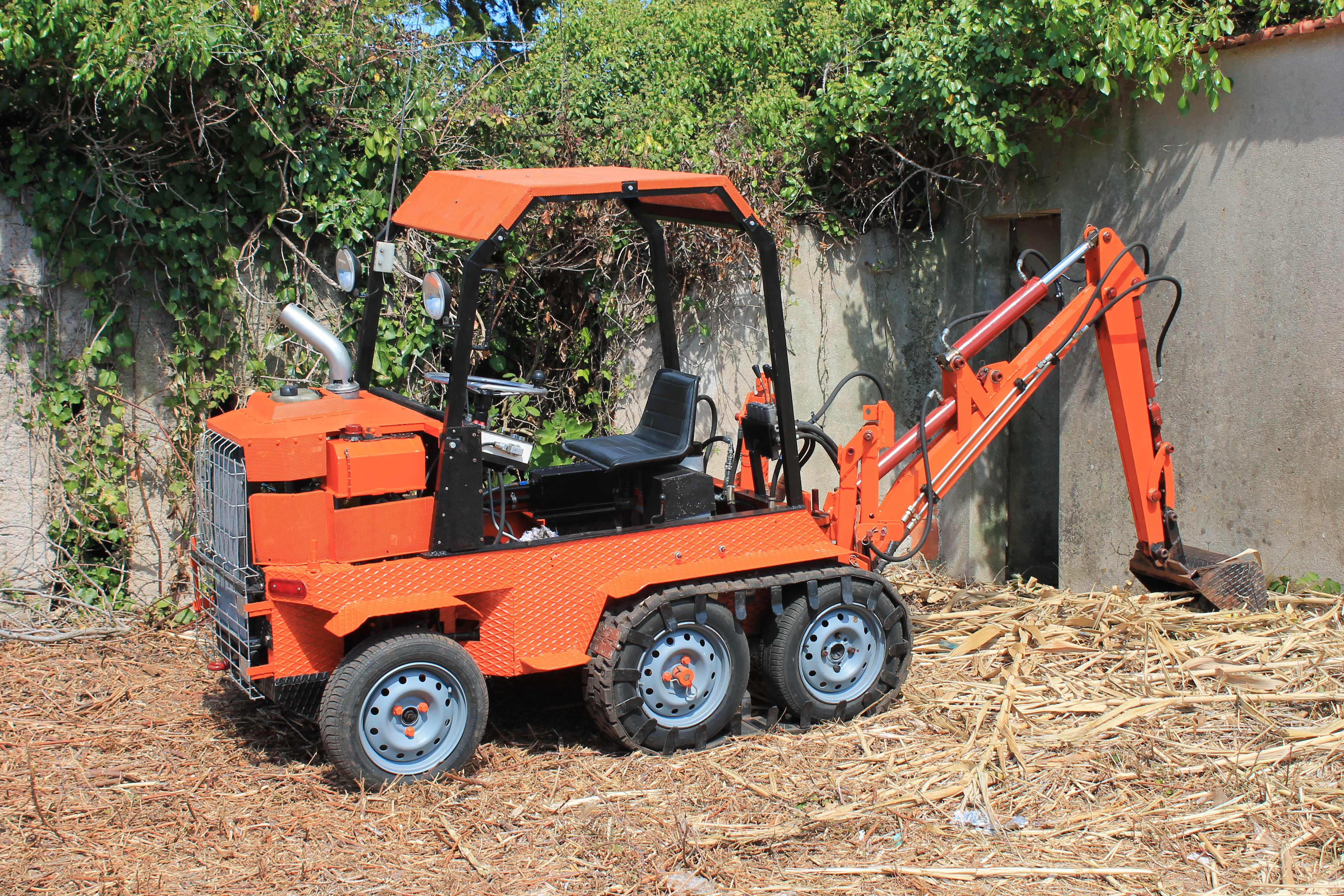

Here is mine. Not pretty by any means, at the time I had somewhat limited skills and tooling, but sure works very nicely and saved me loads of handwork. I started building this back around 2006 with the help of my dad as I was only 12 years old, and finished around 2014 or so, working on it mostly on weekends. Or as I usually say, it's never been finished as I keep adding/changing things over time.

Having built a backhoe from scratch myself, I'm very interested in this project.
If you do, indeed, start this project, please post the progress for us to watch.
Having 4 wheel steer wouldn't be a bad idea either. With just two front axles of whatever 4x4 truck you find and a simple linkage, can be easily done.
Let us know how this goes.
You got a build thread on that beast? Looks awesome
/ Build a mini-backhoe??? #11
No, unfortunately I didn't take much pictures back then.
It's powered by a Kubota D640 with 17 HP, it has a 1.03 ci pump for the backhoe and drive motor and a 0.4 ci pump for the thumb and flail mower.
The drive train uses a 4.88 ci hydraulic motor, powering a 4 speed gearbox through a chain drive providing a 1:1.3 ratio to the gearbox. From the gearbox, goes to another chain drive, where I mounted the brake disc on top and drops to two differentials.
Now for the tricky part, I added the second diff years later after the first one and I could quite get the same diff I had already. So I managed to get a diff from a England made Ford Anglia which worked out in my favor as it rotated opposed to the diff I already had. This means I could get the diffs facing each other. From one diff to another, I added a chain drive to correct the diff ratio difference between the two diffs.
Both diffs are mounted on a subframe that pivots in the middle. I had to lift the machine when I added the second diff so I had room for all the transmission components. Almost like a lift kit on a truck.

PTSG, that's awesome. Congratulations, it actually works. Excellent inspiration, thanks!
Thanks Sebculb!
What I love about this machine, is that I can use it and abuse without being afraid to break my tractor in half if I used a backhoe on a tractor. And if it breaks, I can simply weld it back together, reinforce it and abuse it again, all on the cheap.
