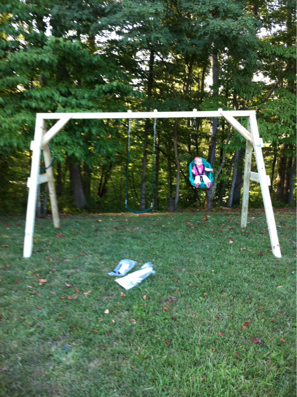

Here is the one I built for my daughter 3 years ago. The top 4X4 is 12' and works well with 3 swings. The 4X4 on top flexes a little with 2-3 kids swinging on it and I wish I had used a 4X6 or I couple 2X10's. I have recently squired a slide and plan to build a platform on one end for it and will upgrade the header at the same time. I built a-frame ends because I wasn't exactly sure where I wanted to put it, so it needed to be movable. So far it works great for my almost four year old and 8 month old.

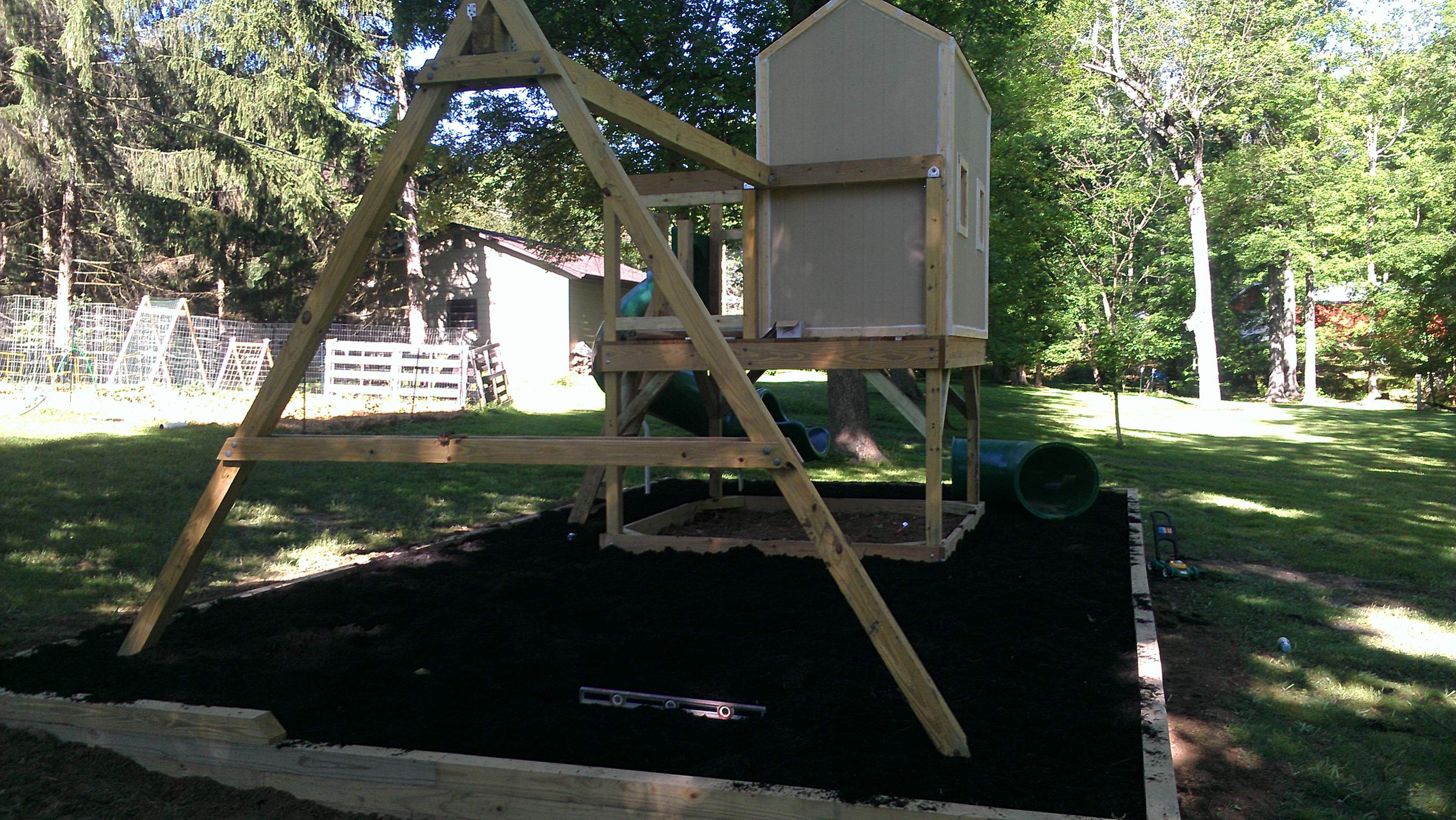

I am in the middle of building a swing set/play house for my kids. It is a little more 'elaborate' than what you are describing, but if it were me doing what you described, I would sink 6x6's. I used 4x4's for the platform with the playhouse on ours, I had to do quite a bit of bracing to keep it from swaying. I used one a-frame for the swingset(the other end is attached to the playhouse), and a 4x6 for the header. The a frame is built with 12' 4x4's and was placed on very un-level ground. I used 2x4's bolted to help brace the a-frame. I havent put swings on yet, but I can hang from the header and bounce up and down with very little movement. I am 215 pounds ...
