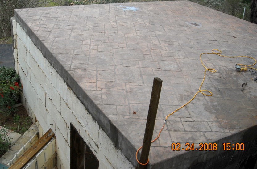

I have designed and built several of these kind of buildings (incl my house and
workshop and water tank), but I have only recently done a flat concrete roof.
It has a clear span of 20 feet and I designed for 100psf live load. Stamped
and stained. Two walls retain 8-10' of dirt.
My house has a wood I-joist roof rafter system with 14' rear retaining walls.
If I did it over, I would go with some kind of concrete insulated roof, like
PanelDeck or equivalent. Insulating conc roof systems are VERY expensive,
so I would prob not use it for a workshop-type building.
For your building, I would go with a sloped or domed roof. I did a domed
roof of only 4-4.5" thickness over my water tank: clear span 12.5'.
