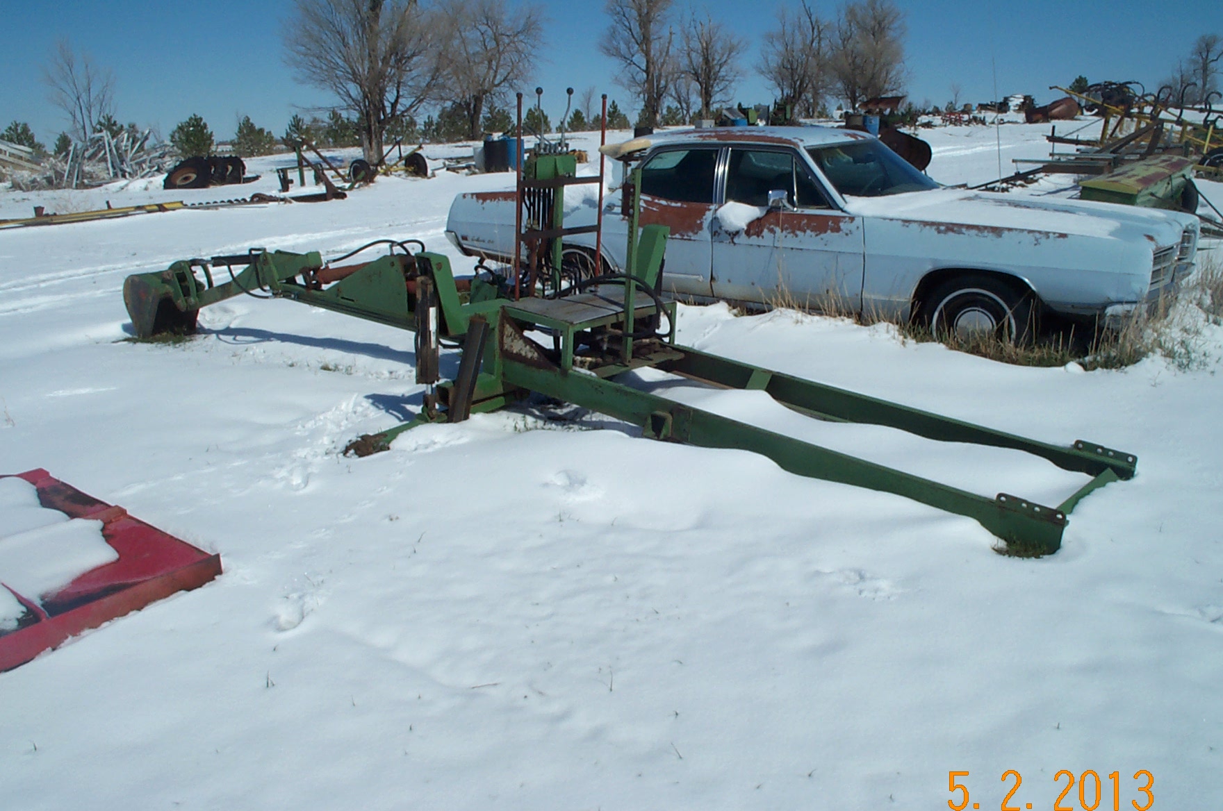

YES I did buy plans, from cad plans, I down loaded free plans and scowered over drawings of commercial back hoes, and most did not have the reach or size I was wanting,
so I got cardboard, and started to cut out parts, and used 1/4" bolts, to make pivot points and made or used the actual cylinders to check clearances and actions,
what happened is when I put a tractor in the mix, the tractor being a little larger than what the back hoe is, under a few actions the of the bucket and weight of the tractor could over load a cylinder, that was not being used, at that moment, the cylinder diameter was not the problem but the rod/shaft size,
so what I did was blend a number of plans in to my unit, ( the only thing I wish is now that I would have gone a little more and made it bigger yet, and more sized to the tractor, (old JD 4020) it would be great on a mid size tractor, about 40 to 60 hp. but the 90 hp tractor is a little small,
my depth of reach is some times not as deep as I would like, it is about 7 feet, be nice to have 10 foot,
not a good picture of it, but the only one I have pre loaded here,

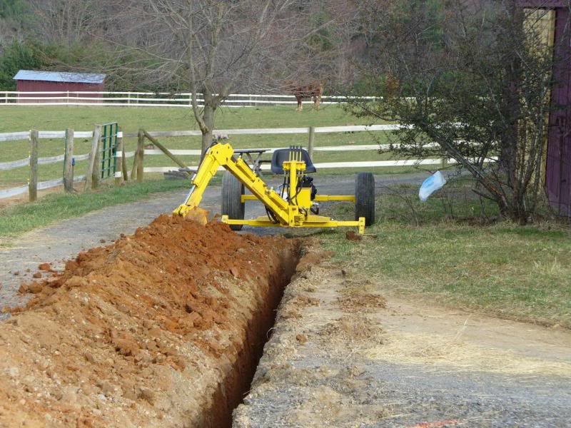

I have a CAD digger 628 (the smallest one) that I built a few years ago. For my intended purposes it has worked very well. It is a bit slow, but it will dig through clay just fine as long as it's not terribly dry. It won't dig through shale and if the surface is very hard, like a compacted gravel driveway, sometimes it's hard to get that first bite out. It doesn't have the weight to force the bucket 'down' into hard ground, but has plenty of force to curl and draw the bucket back. Once you get a hole started you can tear through some pretty hard soil.
I've used it around the farm to trench in many water and electrical lines, do some ditching, dig out for culverts and other sundry tasks. I think I had about $1500 in the whole unit.
Here is a link to the build thread: CadDigger 628 build
