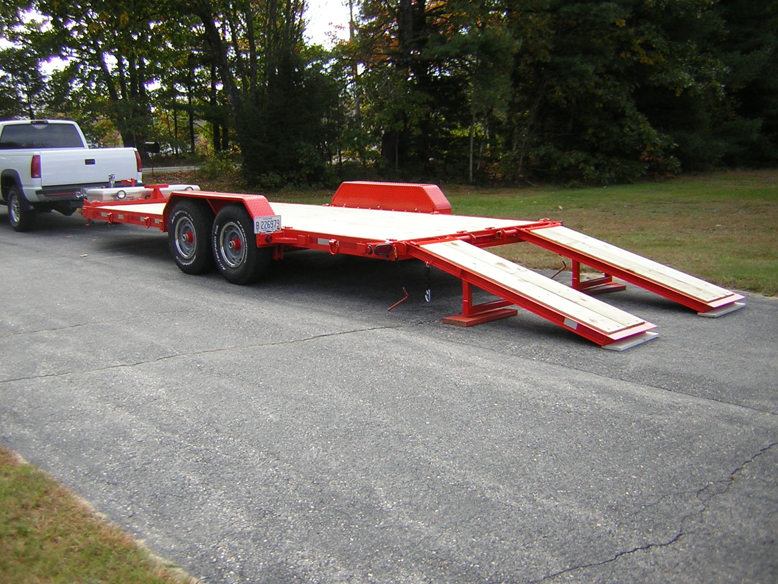

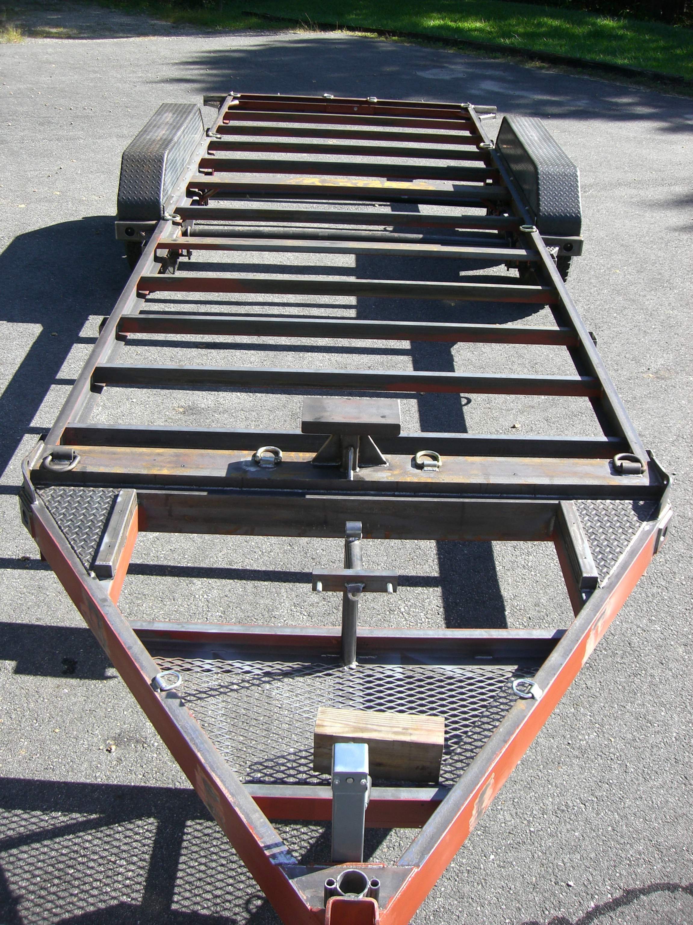

A few pictures of my trailer, I bought Dexter 7,000lb axles and all the steel, wood, LED lights and hardware for $2300, it took about a month off and on to build. My welder is a ESAB Migmaster 250 with 75/25 Argon/CO2 mix, .035 wire. It is 102" wide and 20' long, hauls like a dream! And you can't buy a trailer with 38 tie down points! CIMG1739.jpgCIMG1859.jpgDSCN0902.JPG
/ Build your own trailers #91
A few pictures of my trailer, I bought Dexter 7,000lb axles and all the steel, wood, LED lights and hardware for $2300, it took about a month off and on to build. My welder is a ESAB Migmaster 250 with 75/25 Argon/CO2 mix, .035 wire. It is 102" wide and 20' long, hauls like a dream! And you can't buy a trailer with 38 tie down points!<img src="http://www.tractorbynet.com/forums/attachment.php?attachmentid=297789"/><img src="http://www.tractorbynet.com/forums/attachment.php?attachmentid=297790"/><img src="http://www.tractorbynet.com/forums/attachment.php?attachmentid=297791"/>
Nice build. You must have some serious tools at your disposal

A few pictures of my trailer, I bought Dexter 7,000lb axles and all the steel, wood, LED lights and hardware for $2300, it took about a month off and on to build. My welder is a ESAB Migmaster 250 with 75/25 Argon/CO2 mix, .035 wire. It is 102" wide and 20' long, hauls like a dream! And you can't buy a trailer with 38 tie down points!View attachment 297789View attachment 297790View attachment 297791
Thanks for sharing. That is one awesome trailer. Still running around with ideas on how to build a car hauler/dump trailer all in one. The photo of the raw trailer is a huge help in seeing the "guts" of the build. Thanks again for the photos.

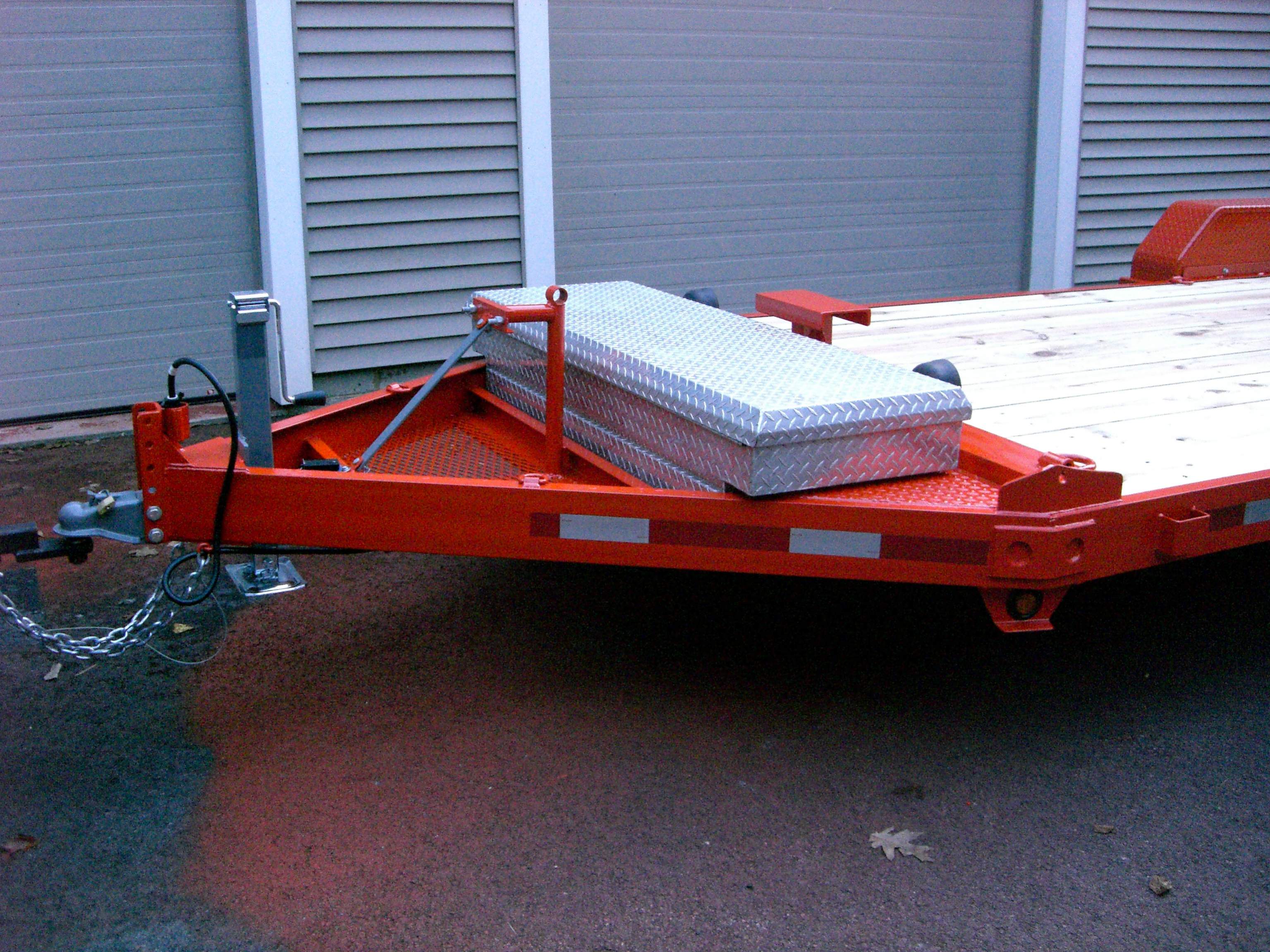

I like your trailer. It sure looks heavy duty and you should be proud of your accomplishment. Now that you are done with it and know the cost and man hours building it, how does it fare with a boughten one that size and heftiness.
I noticed your stinger that it is hooked to. Is that the one you pull with? It sure looks lighter than a 5000# rating. All the tie downs are a real good idea by the way.
/ Build your own trailers #98
Thanks for the positive comments!
The trailer weighs 2600lbs, the axles are a combined 14,000. The biggest thing hauled with it was a 7500lb Mini Excavator.
The reciever in the photos was only used for moving it around the yard, I have a older reciever with no rating but it seems stronger than the 10,000lb rated ones.
I shopped for months and decided in the middle of other projects that I needed another, but it was so much fun building it it really went by quickly.
I bit the bullet back in 2006 and built a big shop for projects like this, worth every penny!
