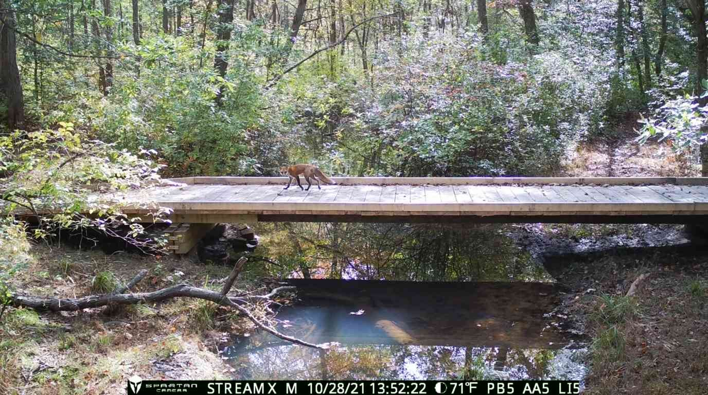

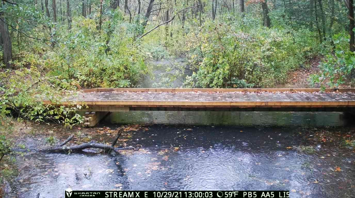

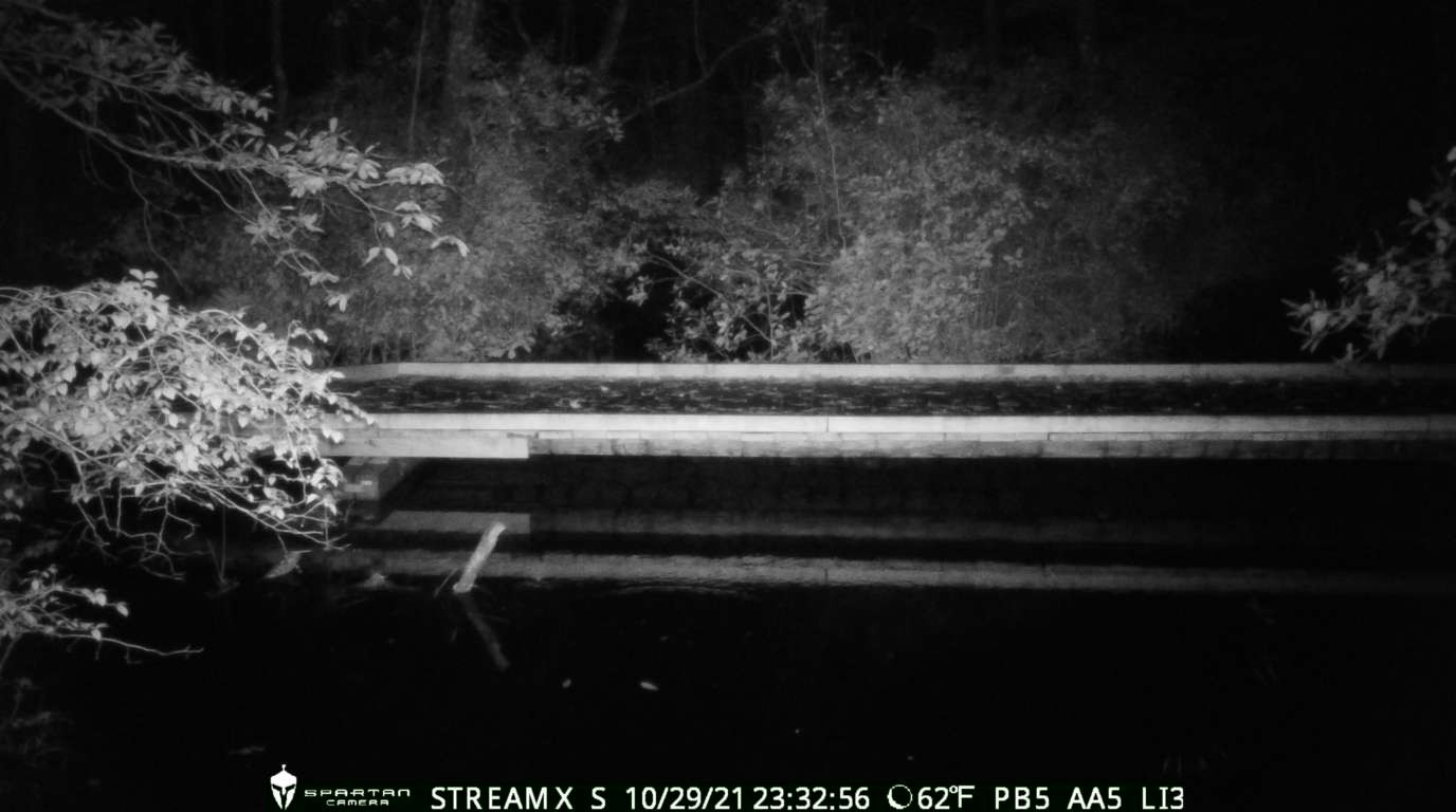

Hello, all. Just stopping in for a quick update. Bridge is doing great, fall colors are starting to creep in.....and we had a "Storm of the Century" (or so they called it) here in the Mid-Atlantic along the bay where we live yesterday. Extreme high tides combined with inches of rain produced some crazy effects along the shore areas around here. To say I was a tad concerned would put it mildly, but even though the water crept higher than its been in 40 years, it did no damage to the bridge, and this morning, water levels are backing off. Pic one is normal, pic two was about 4 hours before the water hit its high point, and pic 3 is as high as it got, but its night and tough to see.
Normal conditions see the water levels anywhere from 42" - 48" below the bridge pole stringers. At its height yesterday, it was less than a foot. You can see in the night pic, the water was above the 2nd 6x6 that the poles sit on.
I will try to post up some fall pics once the colors really get going

Beautiful Fall color!!!
It sure looks like you placed the bridge at the perfect height.
