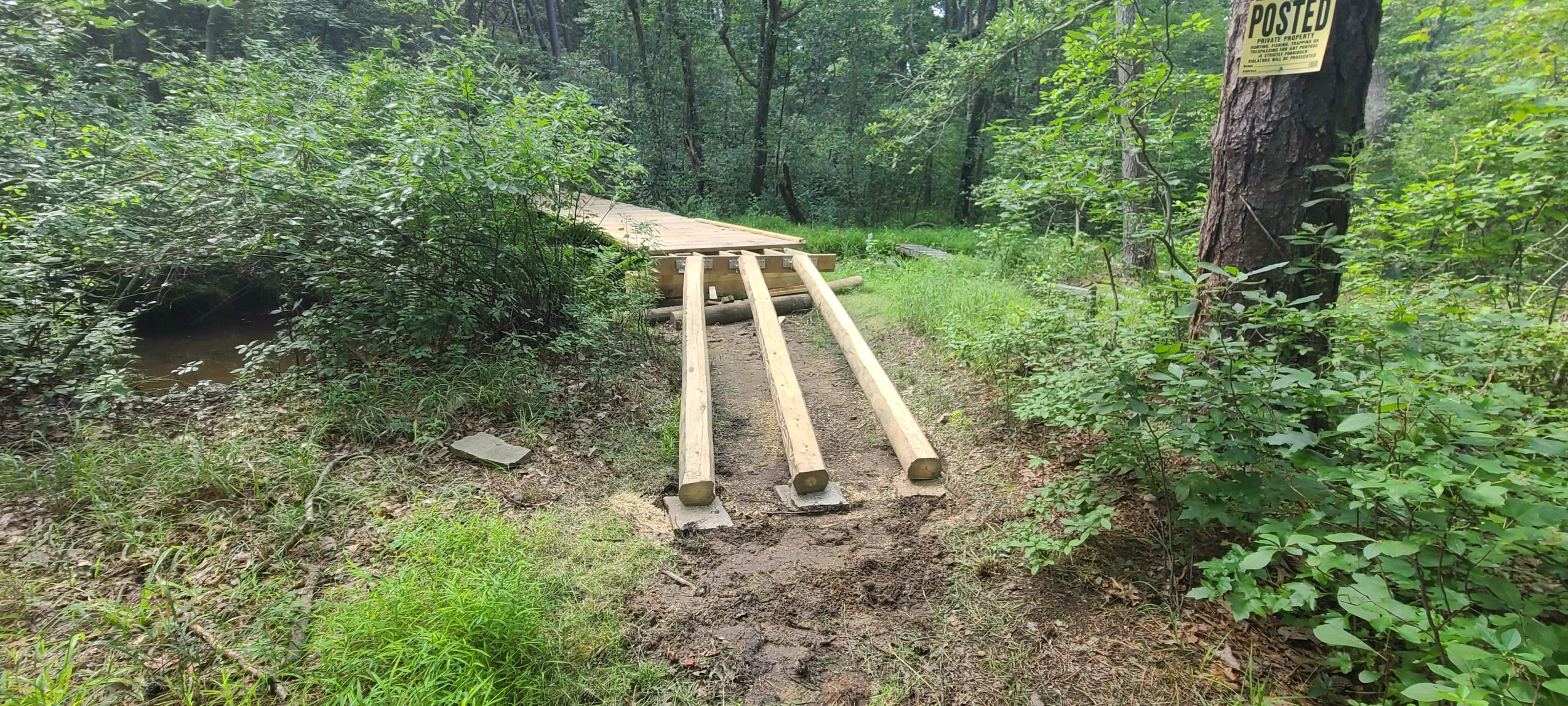

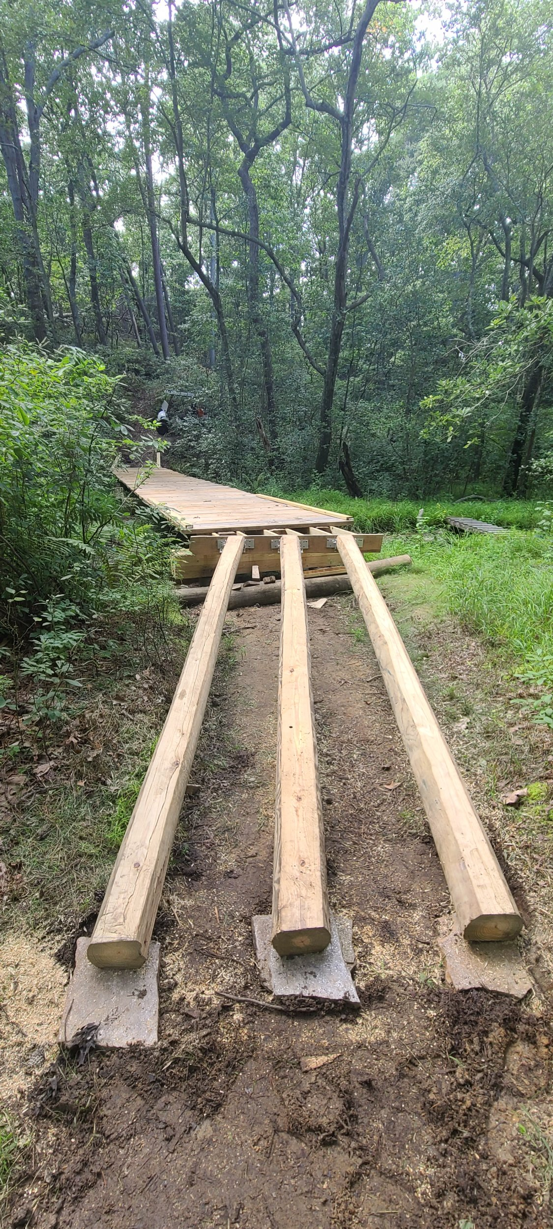

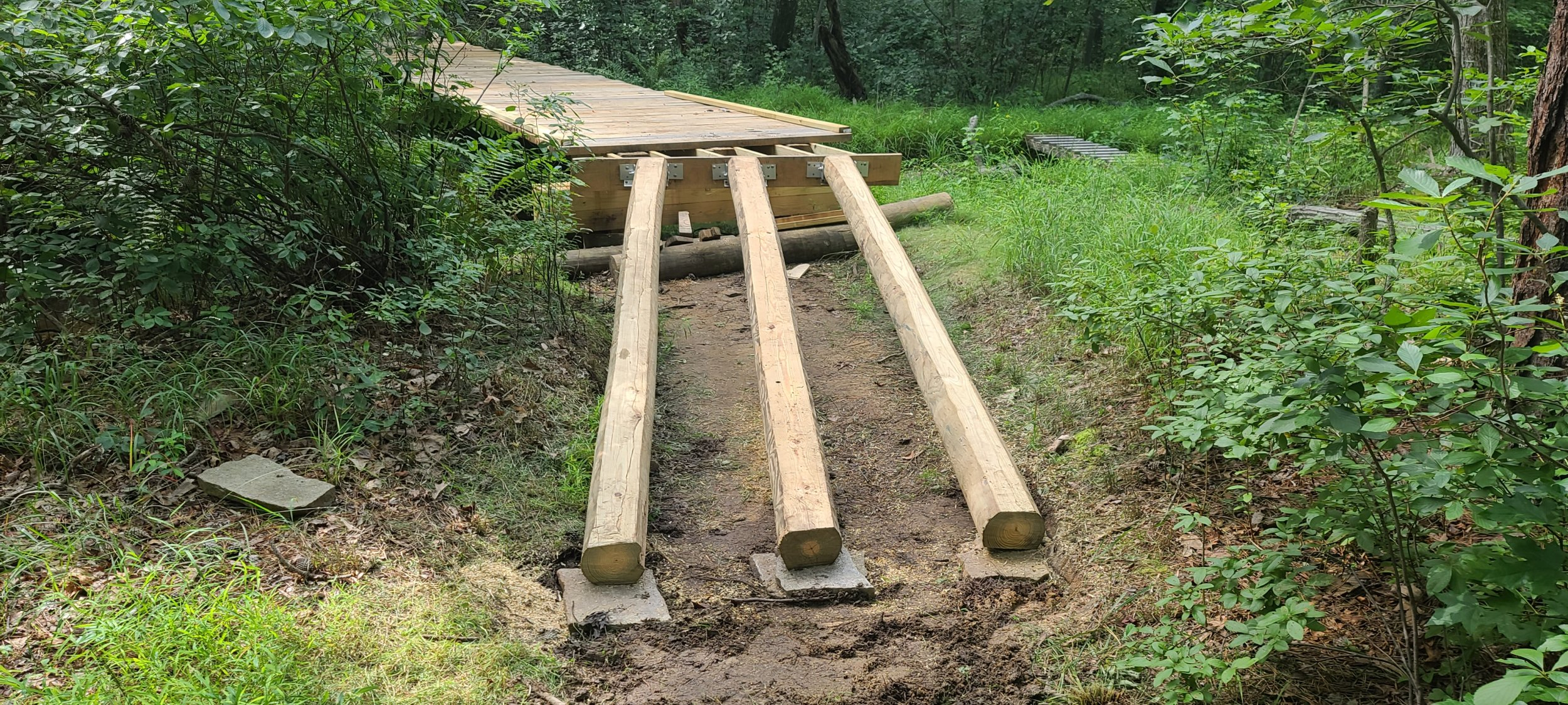

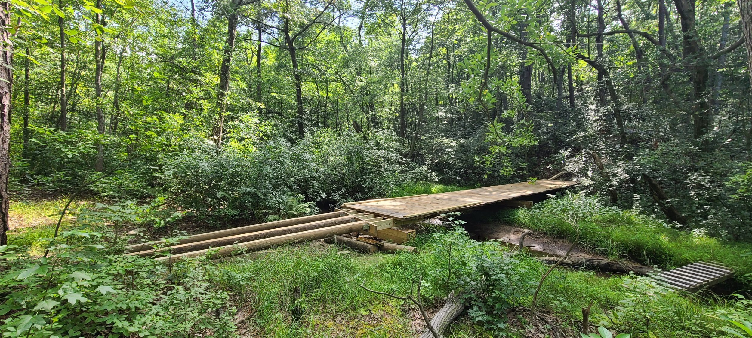

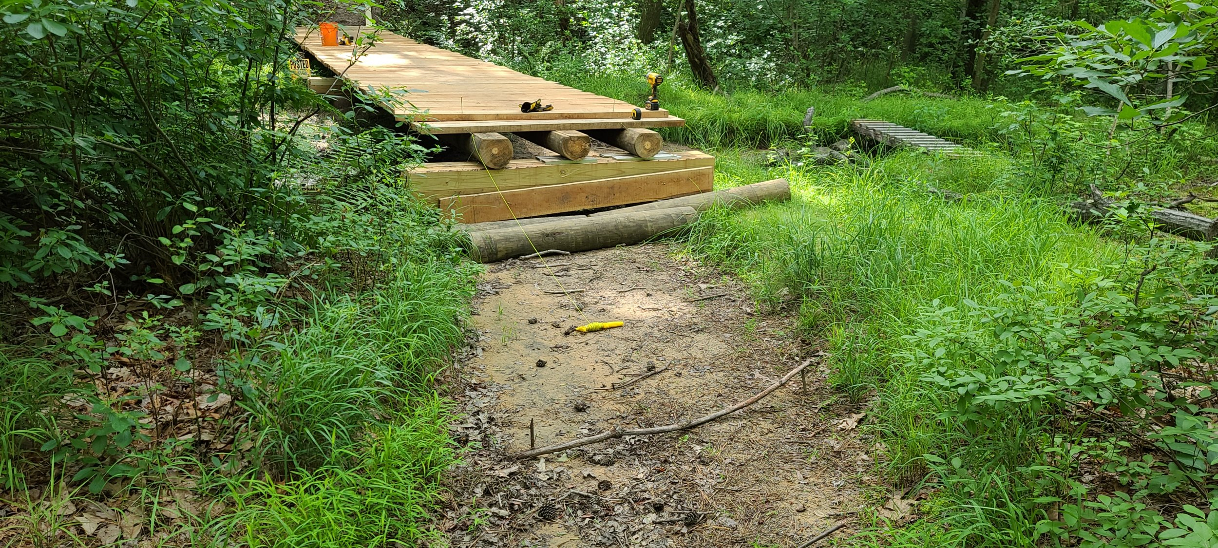

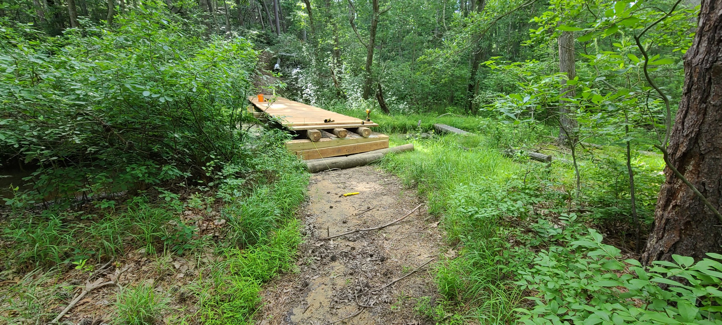

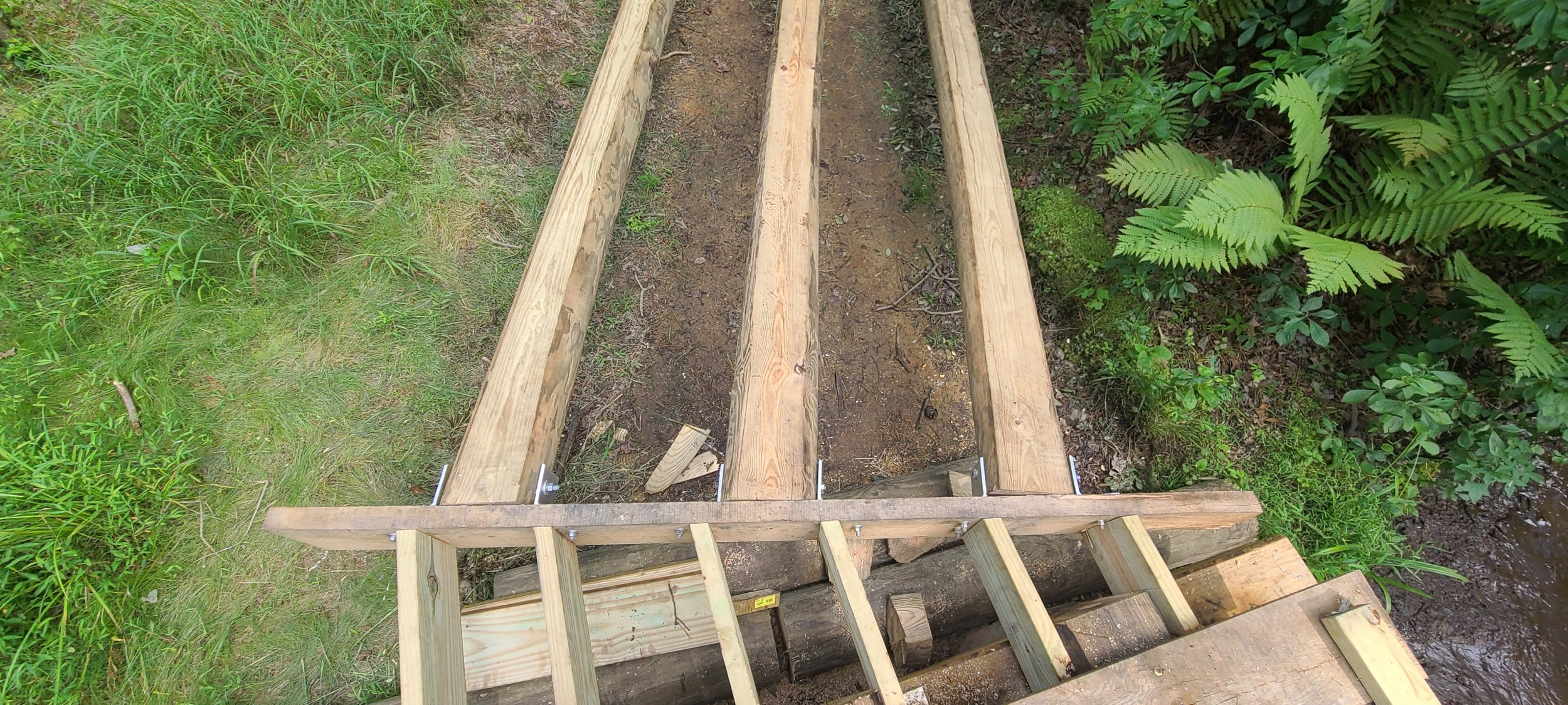

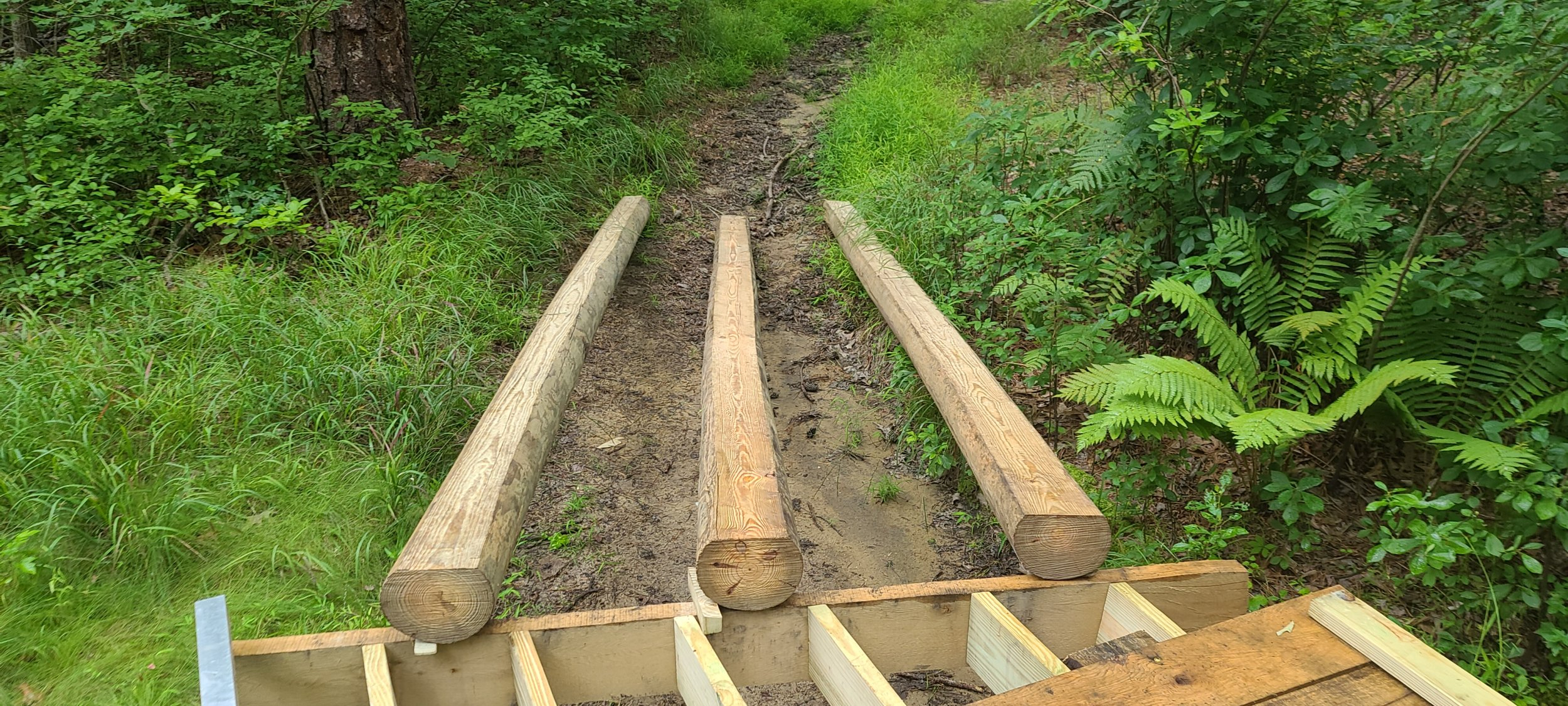

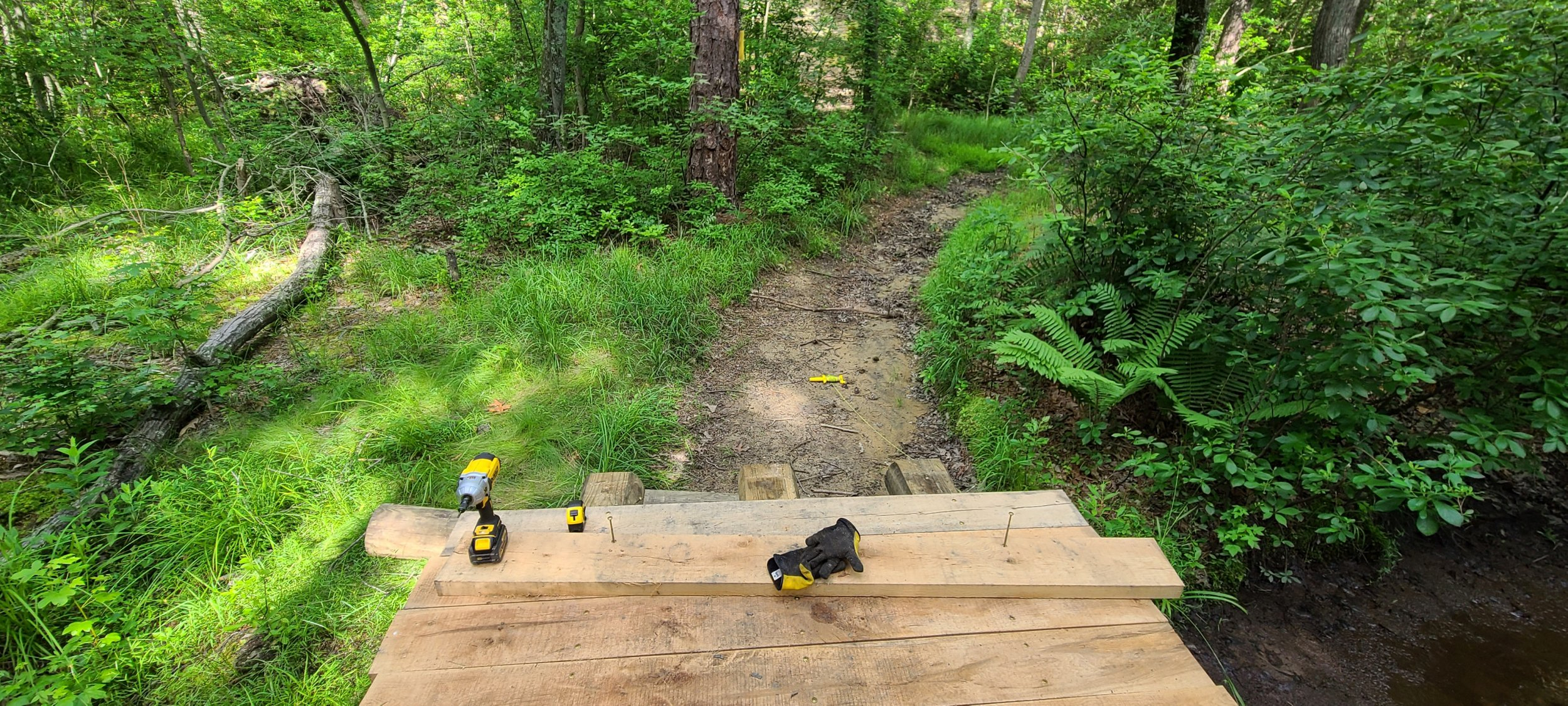

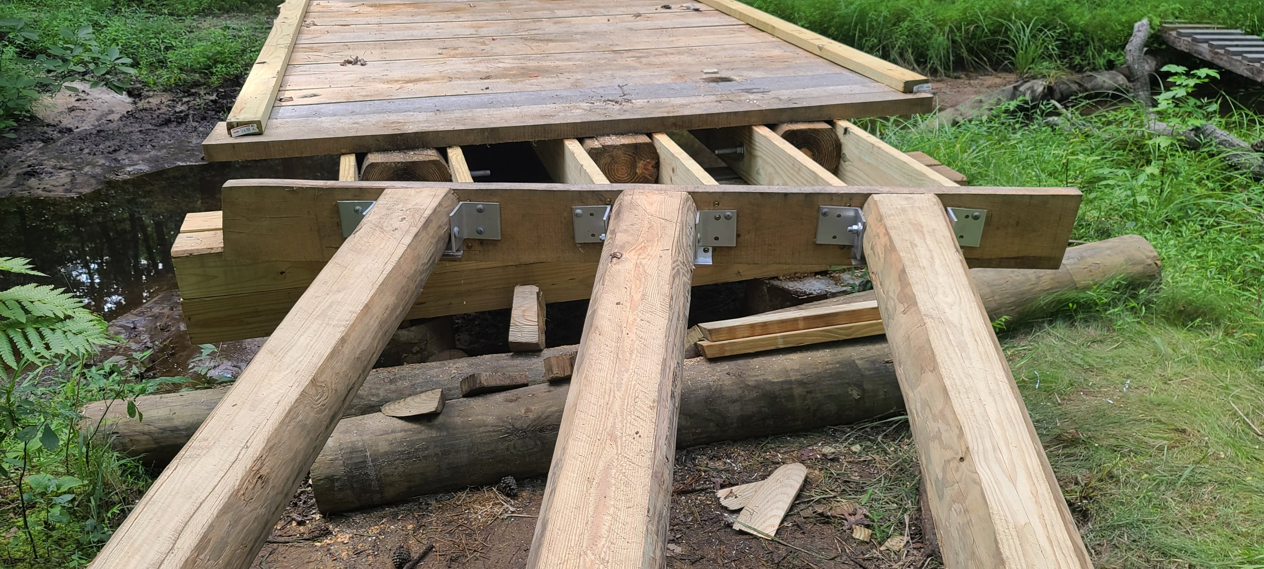

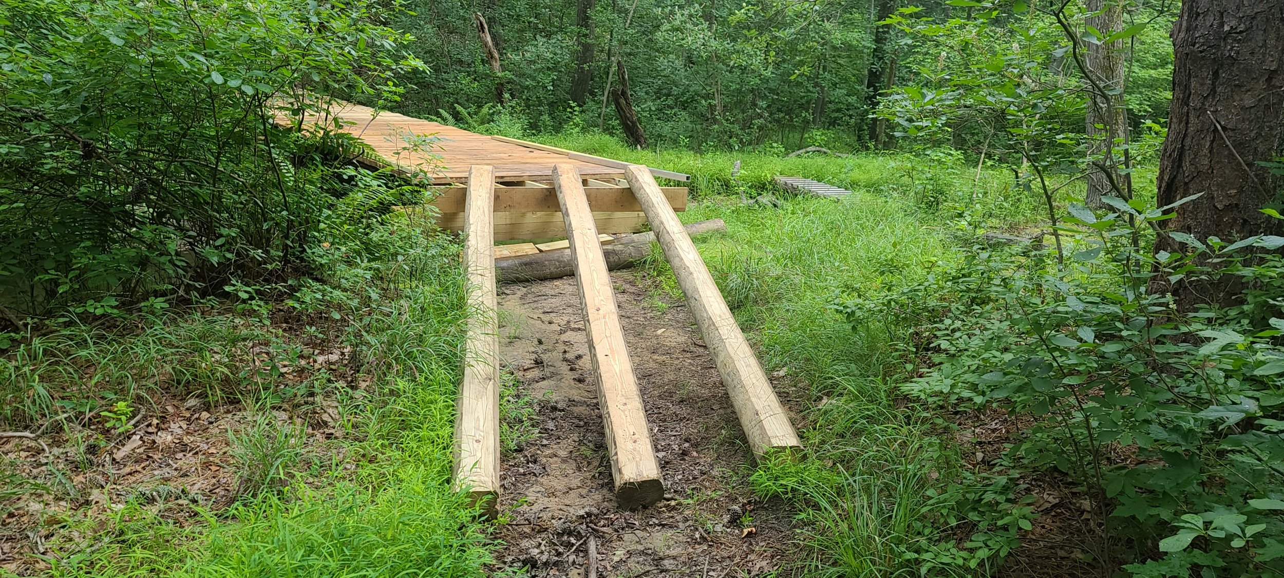

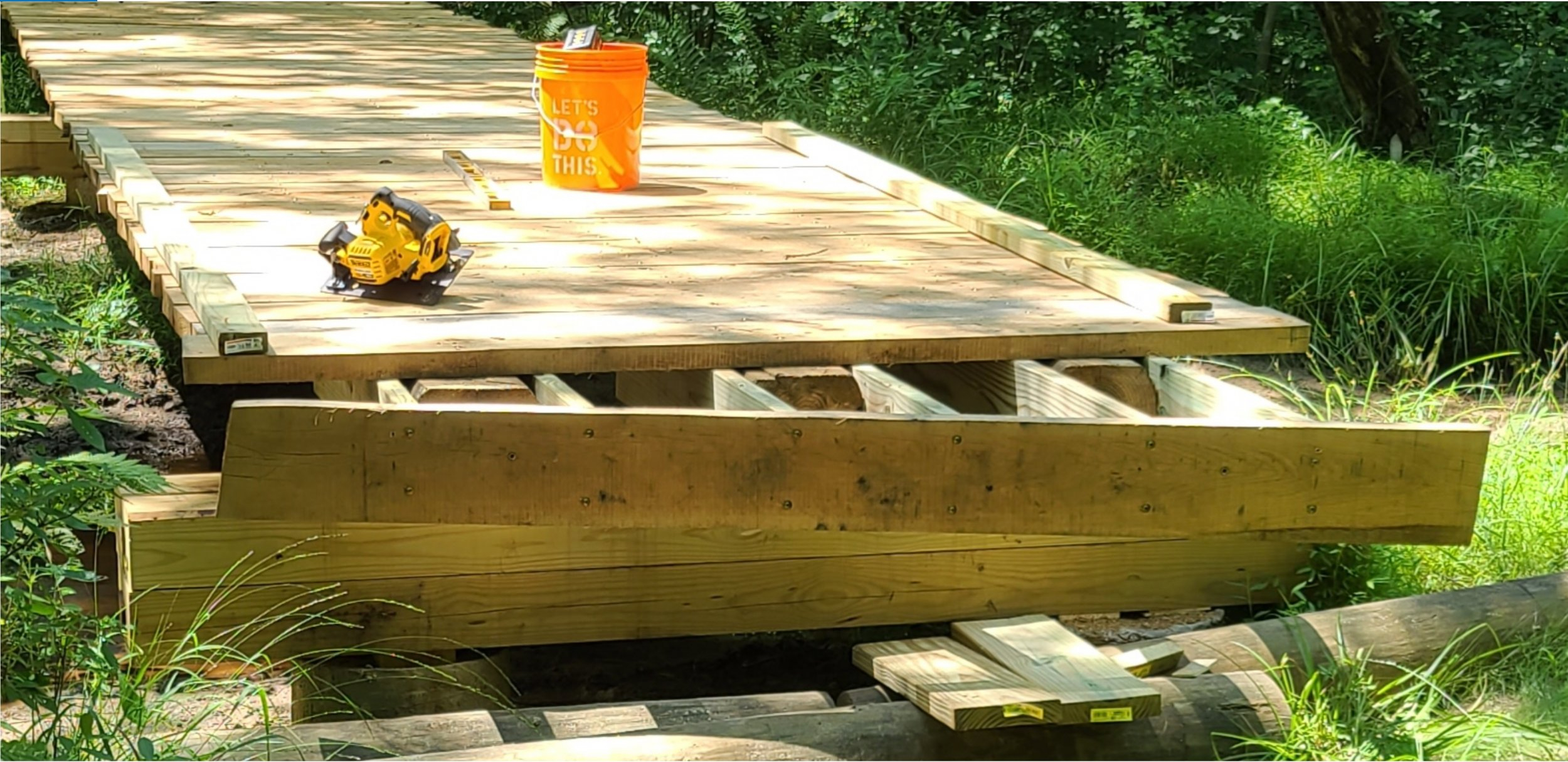

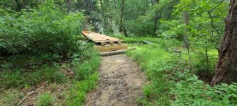

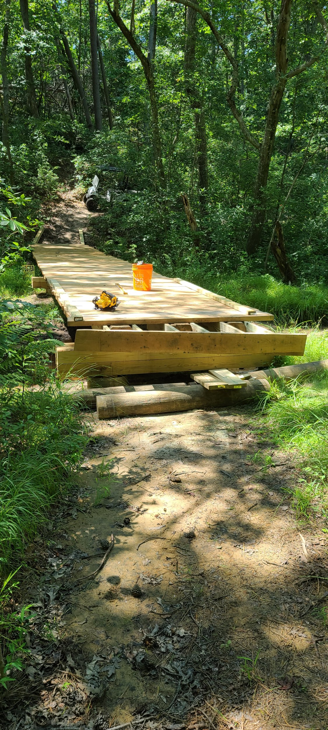

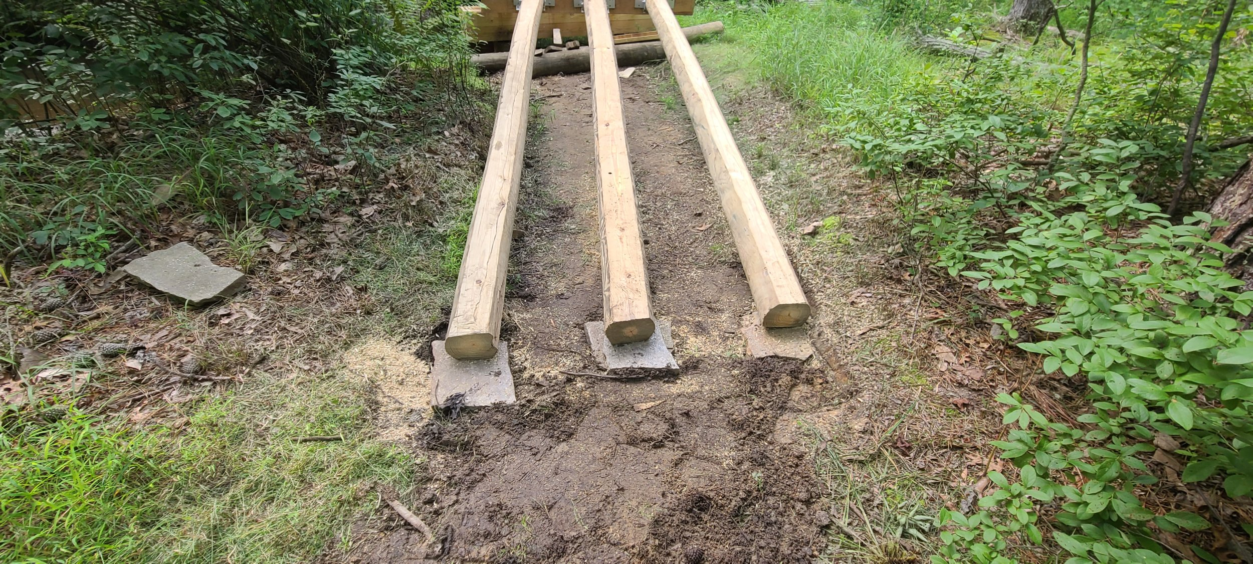

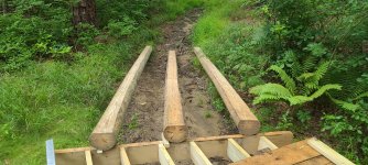

Thank you. This project did not require a permit :).
The bridge is a little over a quarter mile from my house, so the only thing that would have made it easier would have been a road to the site wide enough to pull a trailer. This would have made getting the material there much easier. The only other thing I might have done would have been to build some rock retaining walls along the stream banks on either side of the creek BEFORE building the bridge. I am in the process of doing this now with sandstone, of which we have LOTs on the property. It wasn't required, but it will keep the stream banks from eroding over time and make for a clean area. Other than that, It was just a matter of taking it day by day and humping the material back there. It was strictly a weekend project, but if I didn't have a job, it may have gotten done much faster :).
To give you an idea of the trail size leading up to the bridge, I will attach a few pics. The other two pics are a shot of the bridge from on top of the hill. Now that the leaves are beginning to fall, its a little easier to see from up on the trail.

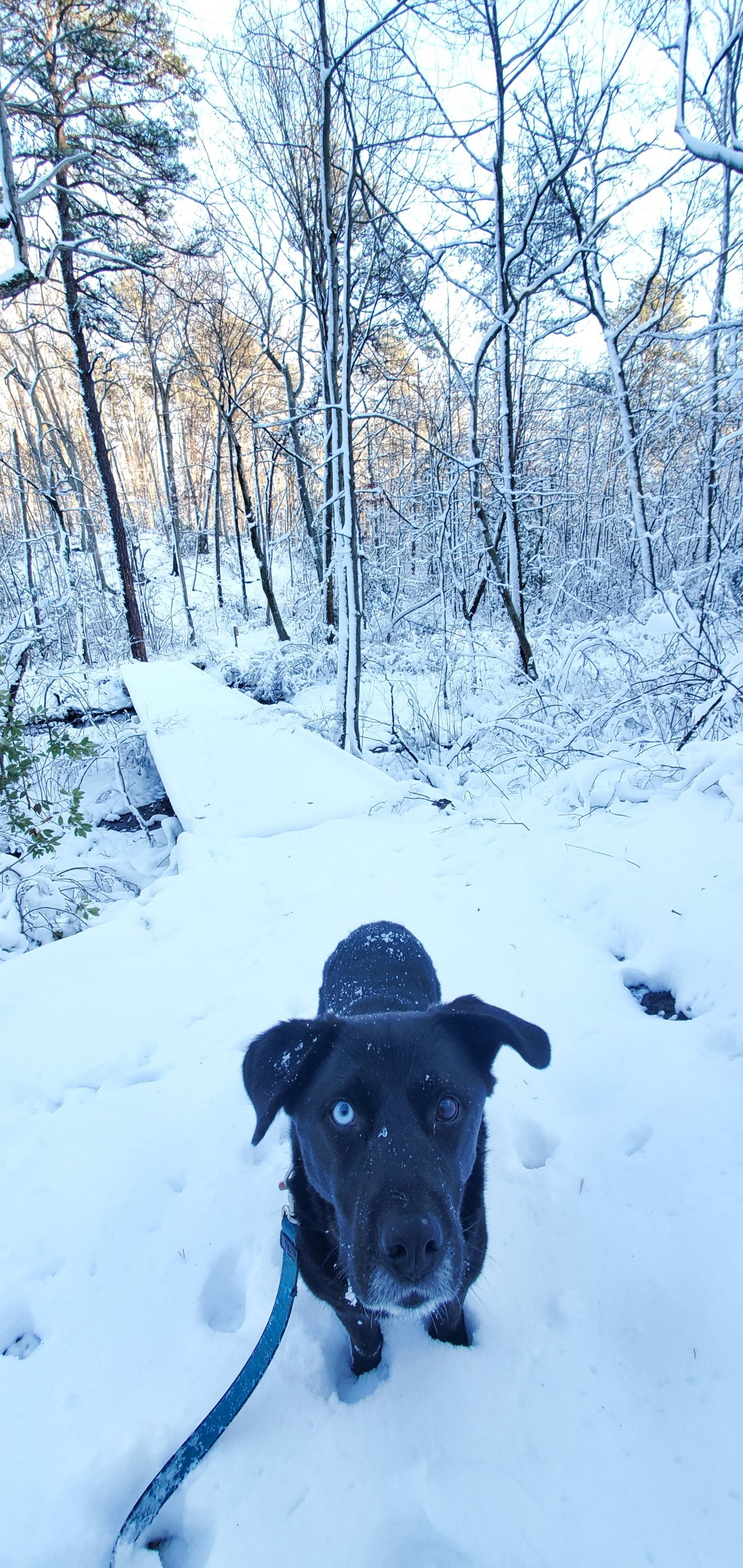

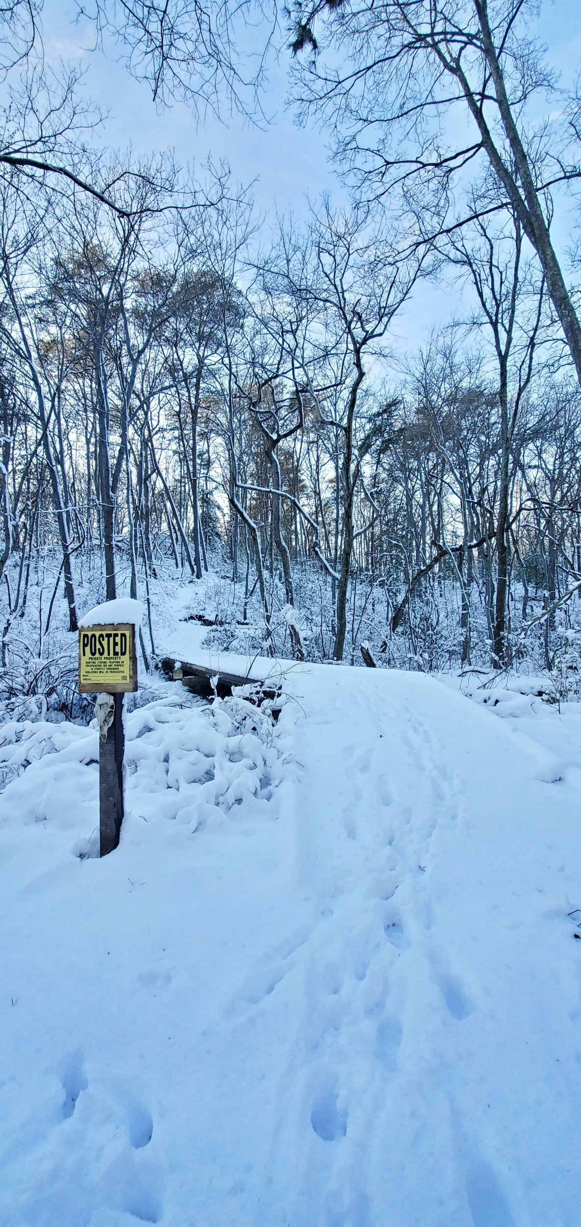

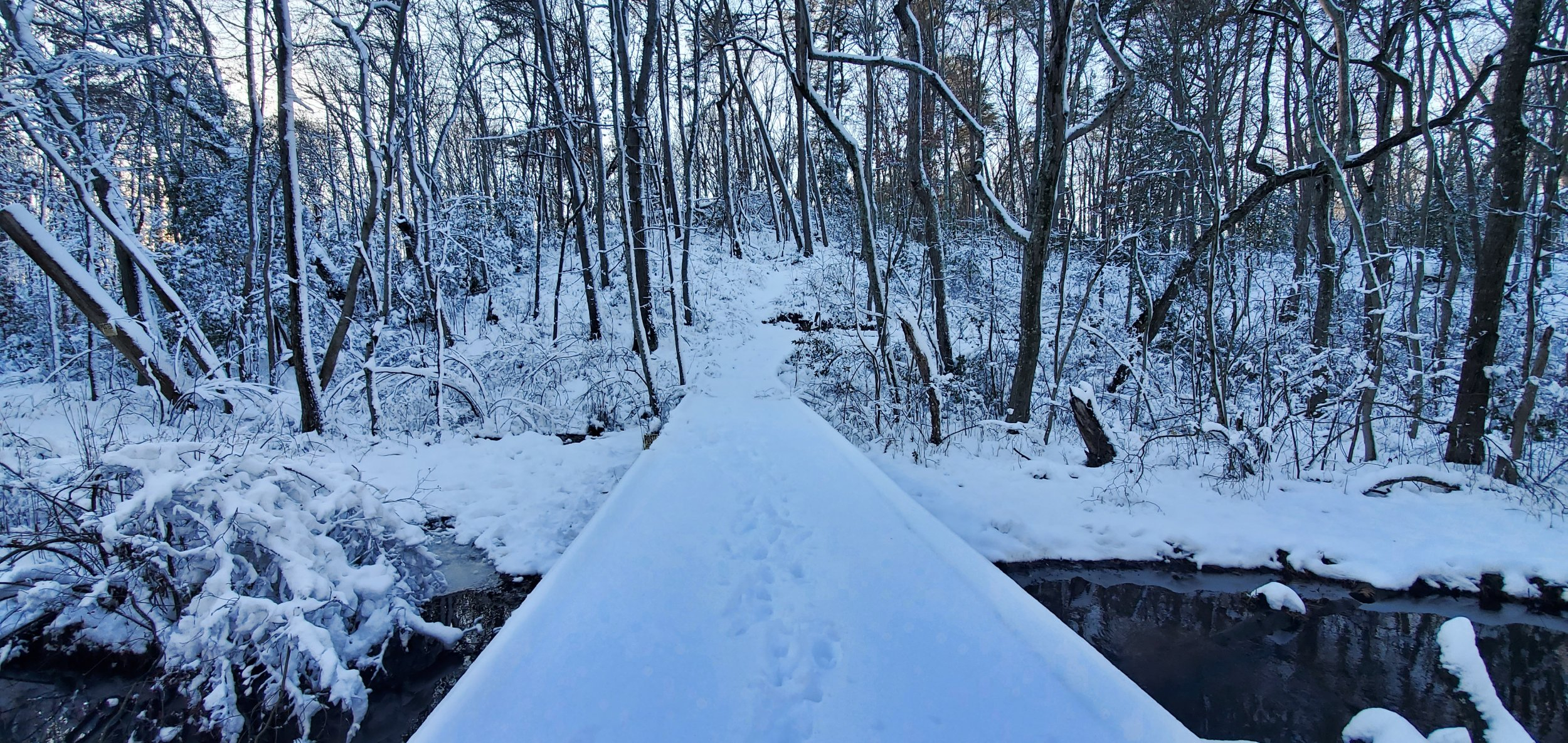

A few pics now that some snow has settled in.
Beautiful Bridge. I would put a Centre Support of Concrete Blocks or 6" capped steel pipe placed on heavy Patio stones or a big length of 8" Channel Iron. Old age sags!
I will keep an eye on it, I am hoping the those large treated poles will hold shape for a while. It would detract from the aesthetic of the bridge to have to throw another support in there if I don't have too.
