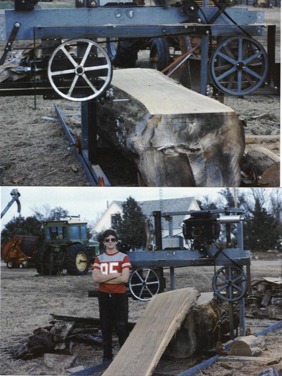

I used the v pulley approach and HUNG a v belt on it for the tire, (it is just large enough to drop on the pulley it is not glued but it is self cleaning,
I used trailer spindles and reversed the hub as stationary and used the shaft on the pulley,
I ended up with 5 bolt hub, (If I was building again I would use 4 bolt, as when you bolt them all one has to do is shim the hub to what ever you bolt it to for alignment,
(now I have not seen plans for a spare tire unit, but my understating on some of them they use air pressure to tension the blade,
on the pulley system one Will need some type of a slide and some form of tension system to tighten the blade, (I just used a section of all thread and tighten up a nut (similar to a pulley tensioner),
if your blade guides are set up correctly there should only be the blade tension on them, and If your guides are not set up right I doubt if you will keep your blade on the wheels regardless of what system you use,
(I know the pictures are no that good, but what I have of it, and there were taken about 20 years ago, ),
I used bearing for a JD gauge wheel bearing and sleeve for the basic guide bears,
http://www.shoupparts.com/SH45951/ or http://www.shoupparts.com/SH45742/ I used the sleeve as well,
(do not rember what I used for the thurst bearing, I may look tomorrow and see).

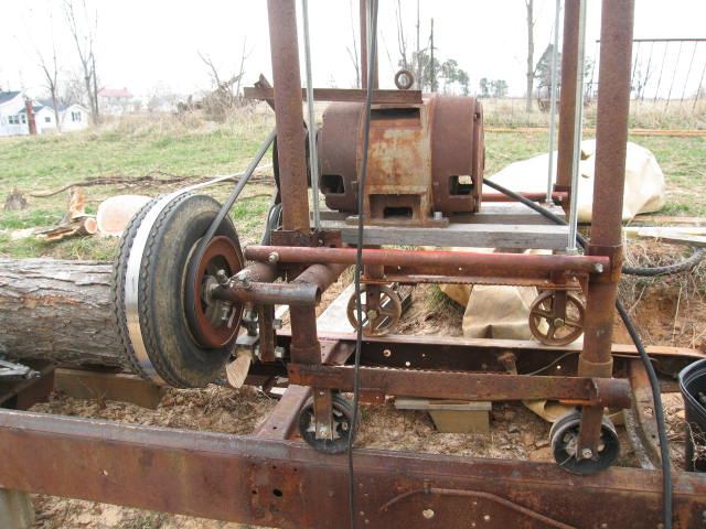

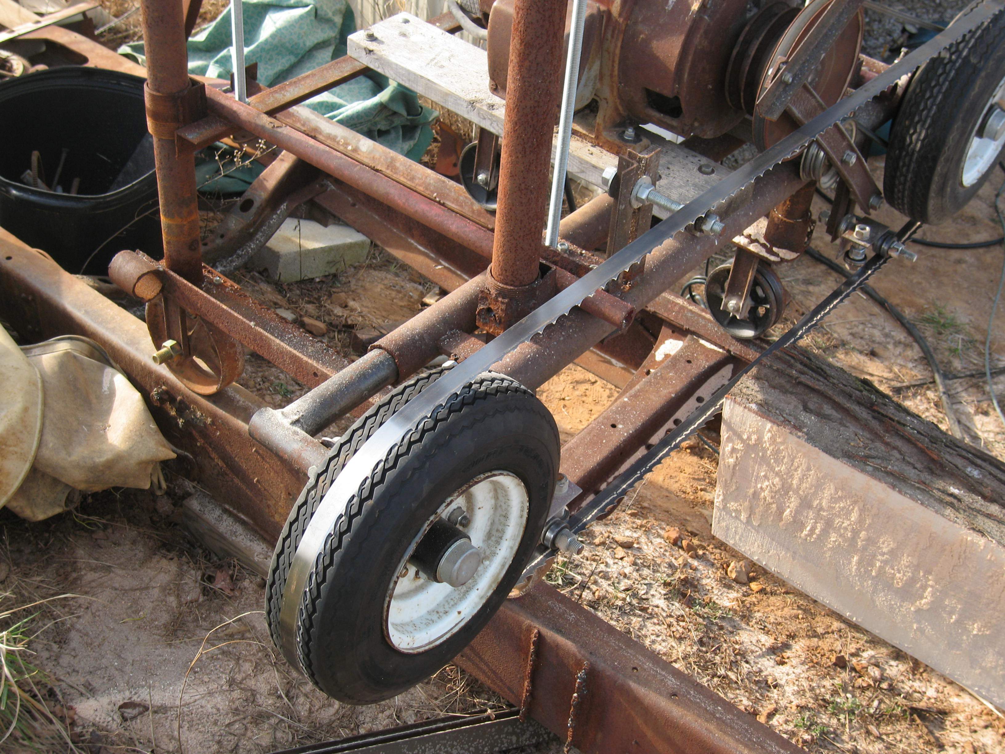

I used 8 inch trailer tires/spindles for my bandwheels and carefully welded a 9" pulley to the rim- it was an exact fit and easy to center. The 8" trailer tire has a 16 inch circumference.
The spindles are each set in a pipe with two sets of angle adjusting bolts (one each 120 degrees) clamping them in position. This gives me adjustment in all 3 planes so I can get the blade tracking correct. The blade is tensioned with tire pressure as well as with a telescoping idler wheel frame (see the pic with the tape measure).
There are two "generations" of mill pics here. The original mill had a single 5hp electric motor (actually a 7.5 hp 3 phase with a static converter). This past year my dad and I added a second electric motor and a hydraulic feed (you can see the power steering pump in one pic). The hydraulic feed was OK (hydraulic motor on the carriage controlled by a spool valve pulling a cable attached to the frame), but I prefer to hand feed with a crank (same cable set up but I crank the cable spool). The hand crank lets you "feel" how hard you are pushing the saw so you can adjust speed better than with the hydraulic feed (and in some cases you can cut faster with the hand feed).
The current set up uses two 5hp electric motors pulling in tandem joined by a belt and did well making 17" wide white oak boards.
The saw bed is the frame off a 1959 chevy 2 ton truck with a pice of angle iron on the sawdust output side and v-groove casters on the saw carriage. I can cut 28" diameter logs that are 16 feet long.
Saw guides are made from sets of standard size bearings from TSC.
My only disappointment is with blade life. I can only cut one clean white oak log (no dirt on the bark- 15 foot by 20 inch diameter) into 1 inch thick planks and then I have to send the blade off for a $6 sharpening. I am running 158" long woodmizer blades, 1.25 inch wide and 4 and 9 degree hook angle- both angles seem to work well. Blade speed is about 5000 linear feet per minute.
