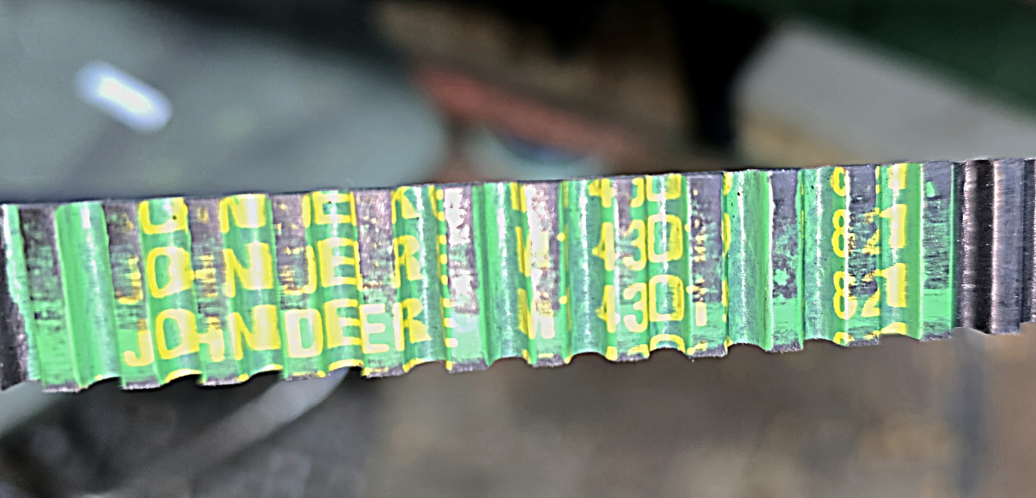

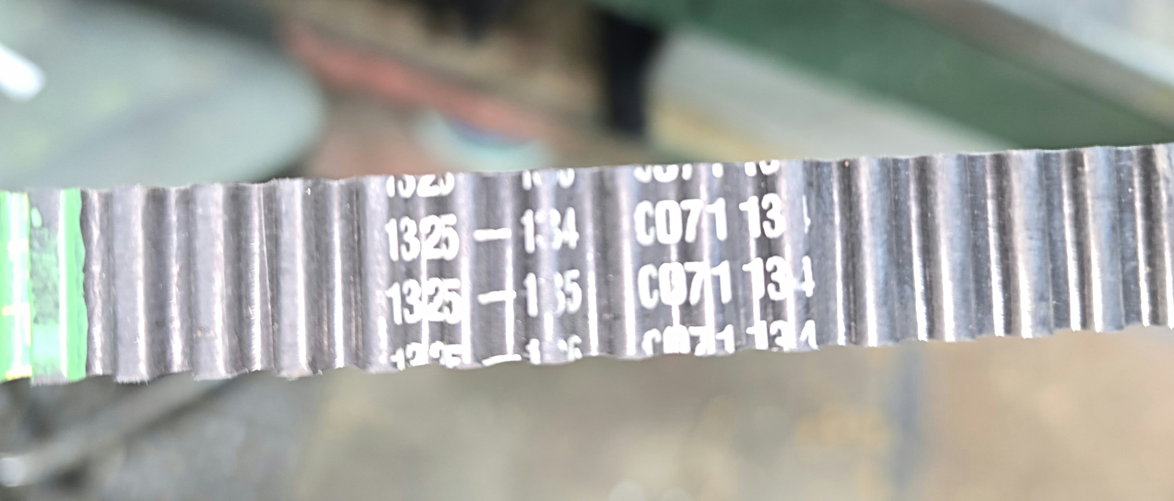

I will check the belt tomorrow. If I remember right it has the part number on it.. the deck turns just fine. The big thing is the pto that makes the noise. Because that is also how the old one sounded before I changed it....
This is the belt that John deer gave me. I thought It did feel tight when I first put it on. But now its loose. But that's going off of my memory which isnt all that great ...
