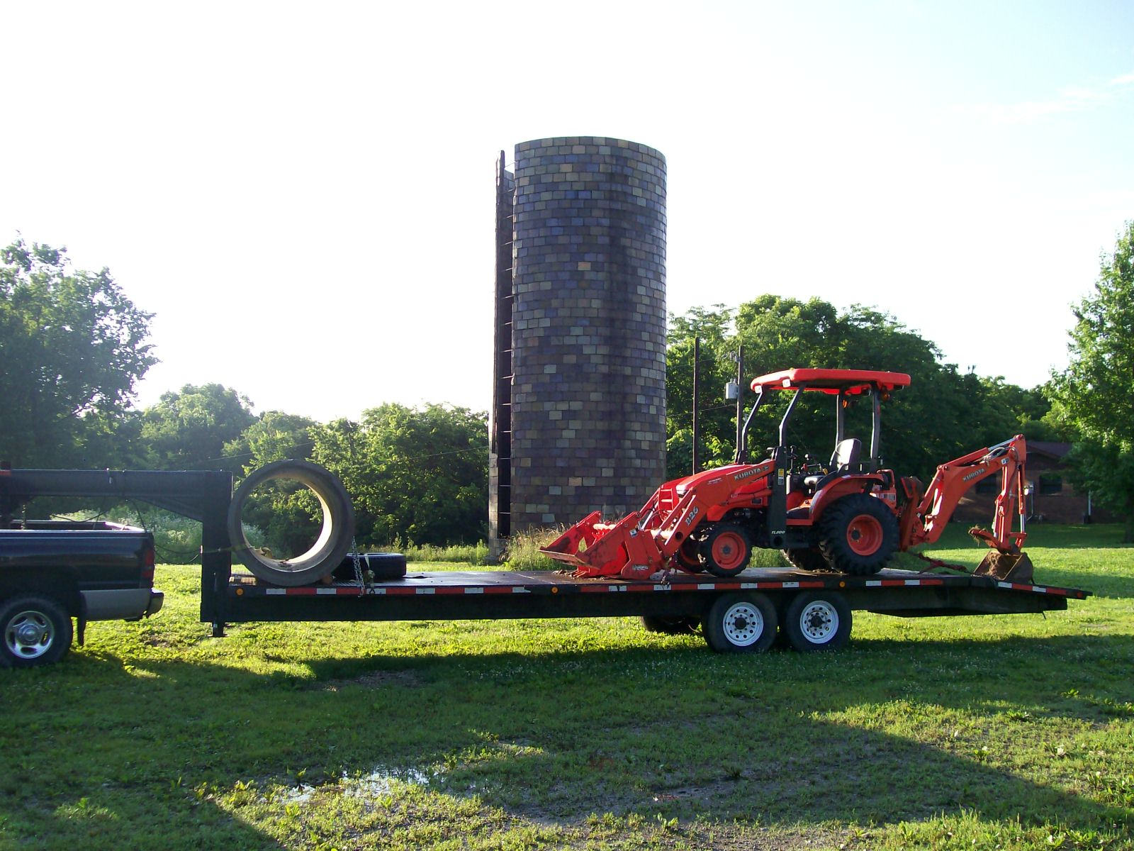

I really enjoy reading and seeing what people build but I am always leary of putting what I have done on here as some just like tell everyone that there is a flaw or something that could have be done better. I know I am not perfect but this bridge looks better and more thought out than 90% of the poster could have ever done. GREAT JOB and let see the photo's of the second one.
FYI my idea of a homeade bridge is the biggest piece of pipe I move covered in dirt.
