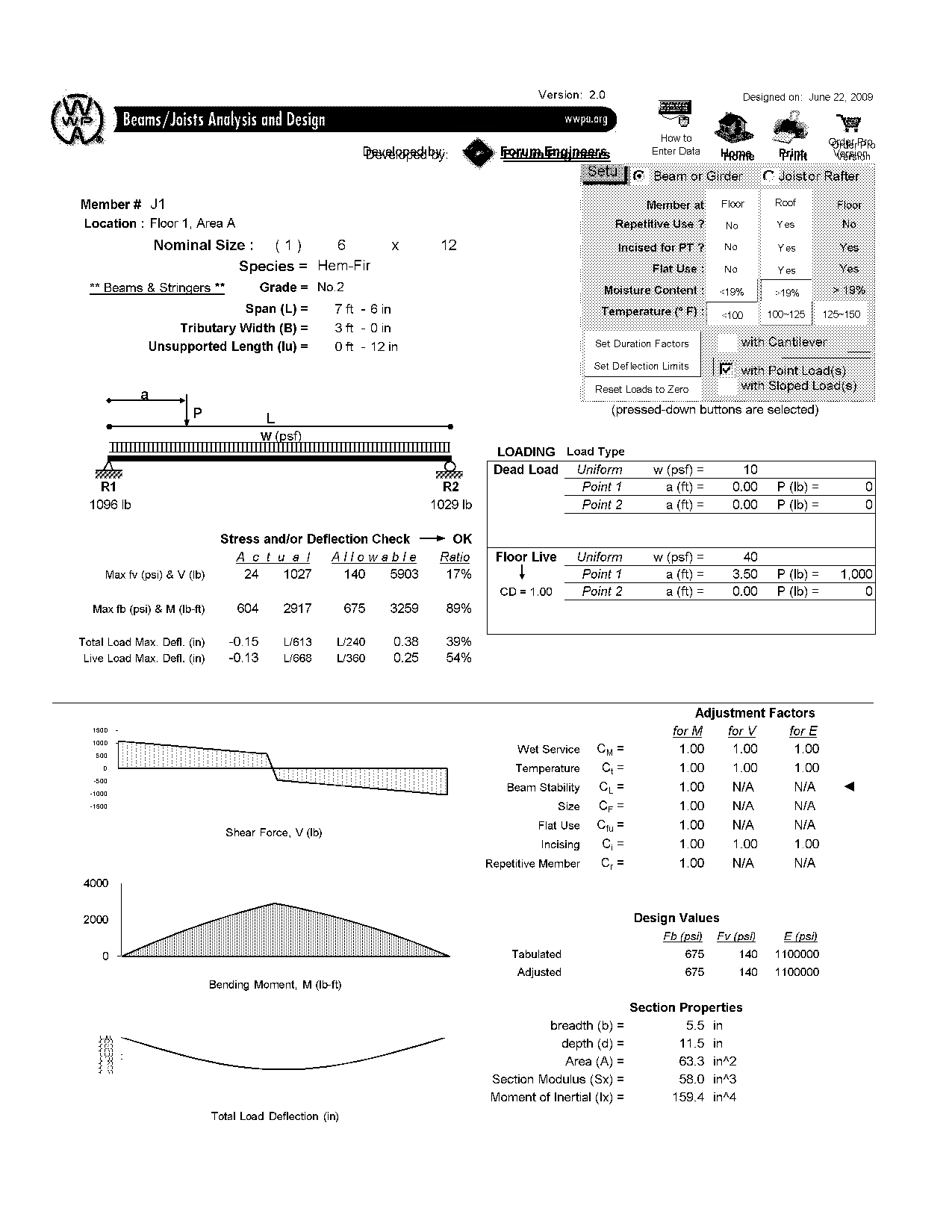

While I am not a structural engineer (and don't even play one on TV;)), I did download the WWPA Beam/Joist Analysis and Design add in for MS Excel from the WWPA web site (I believe you have to register to get access, but it was free). I used this to check the work of the structural engineer I hired to sign off on the design of my house to make sure he wasn't over engineering it too much.
Assuming that the long span is 7.5 feet, and using a Hem-Fir 6x12 flat (about the same as two 6x6 spiked together), incised for PT and >19% moisture content. It can handle a point load of 1000lb in the center. The total deflection is low at L/613 or 0.15 in. However the bending moment is very high at 89% of the allowable. Now there should be a fair amount of safety factor built in to the calculations so it is probably fine, but I would not say that it is way overbuilt. If you had put the 6x6s on top of each other and laminated them or used a 6x12, the bending moment would have been about half as much and this would be great. But, then I would start to worry about the decking痴 ability to transmit the load to the beam. Since the beam would only be 6 wide it would need to be on the center of the wheels, which would probably be a little bit of a challenge to get correct.
If the wood is actually SPF (South) then the load just exceeds the design values for bending moment.
Having said all that, the bridge does look very sturdy and you have driven your tractor over it. Since your tractor probably isn't going to weigh enough to put 1000lbs on a single wheel, you are probably okay. Pay attention to the noises the wood makes and inspect the beams for cracks regularly.

Forgmore, your on the beam. Moisture content in your example is 19%. The wood in the bridge is going to have a higher moisture content and will soften the lumber making it sag more.
Many events in nature follow a square law, in this case, if you set two beams side by side the strength will double , take the same two beams, place one on top of the other doubling the depth, the strength will be 4 times greater. Somewhat over simplified, but you get my point.
