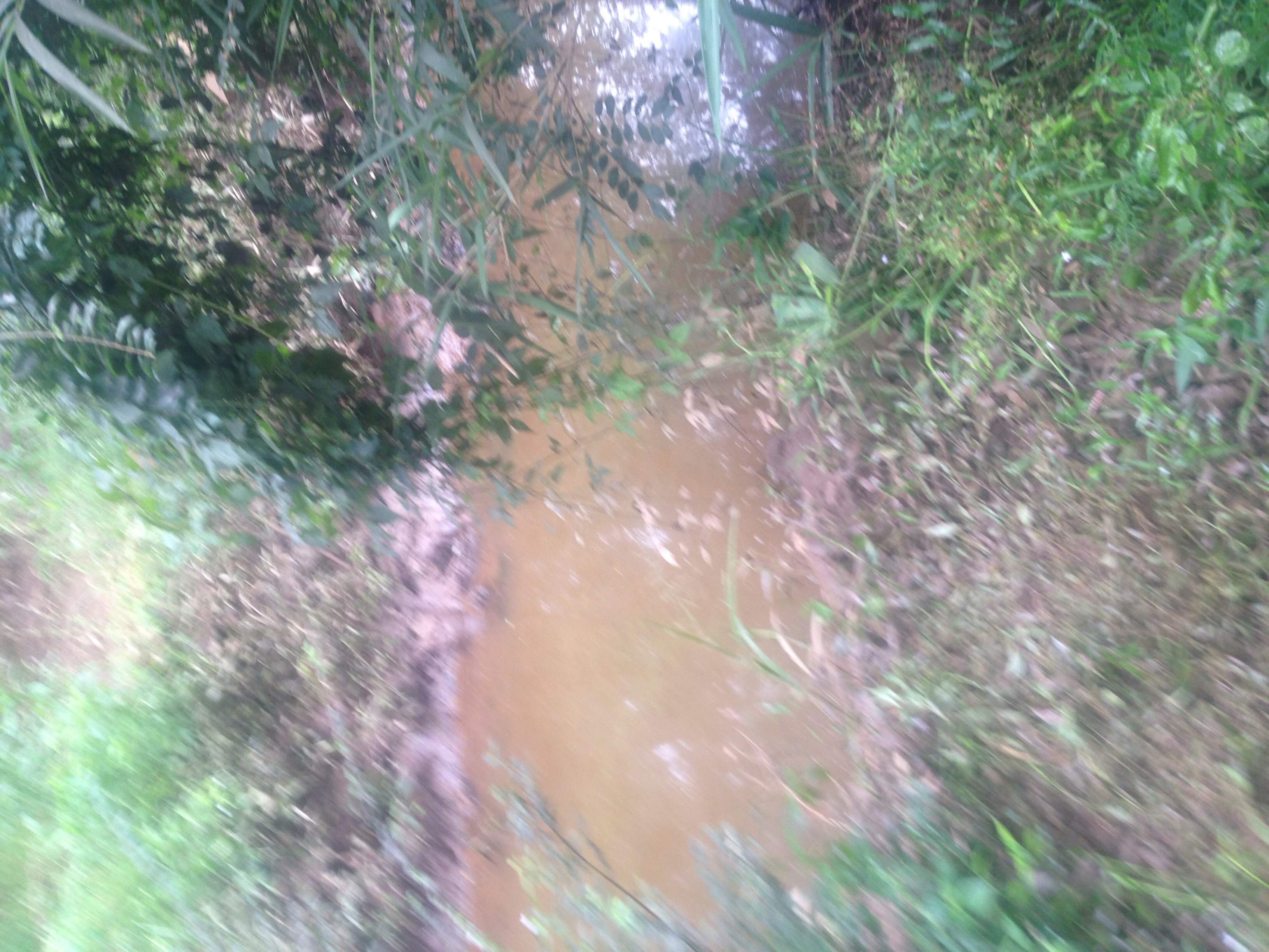

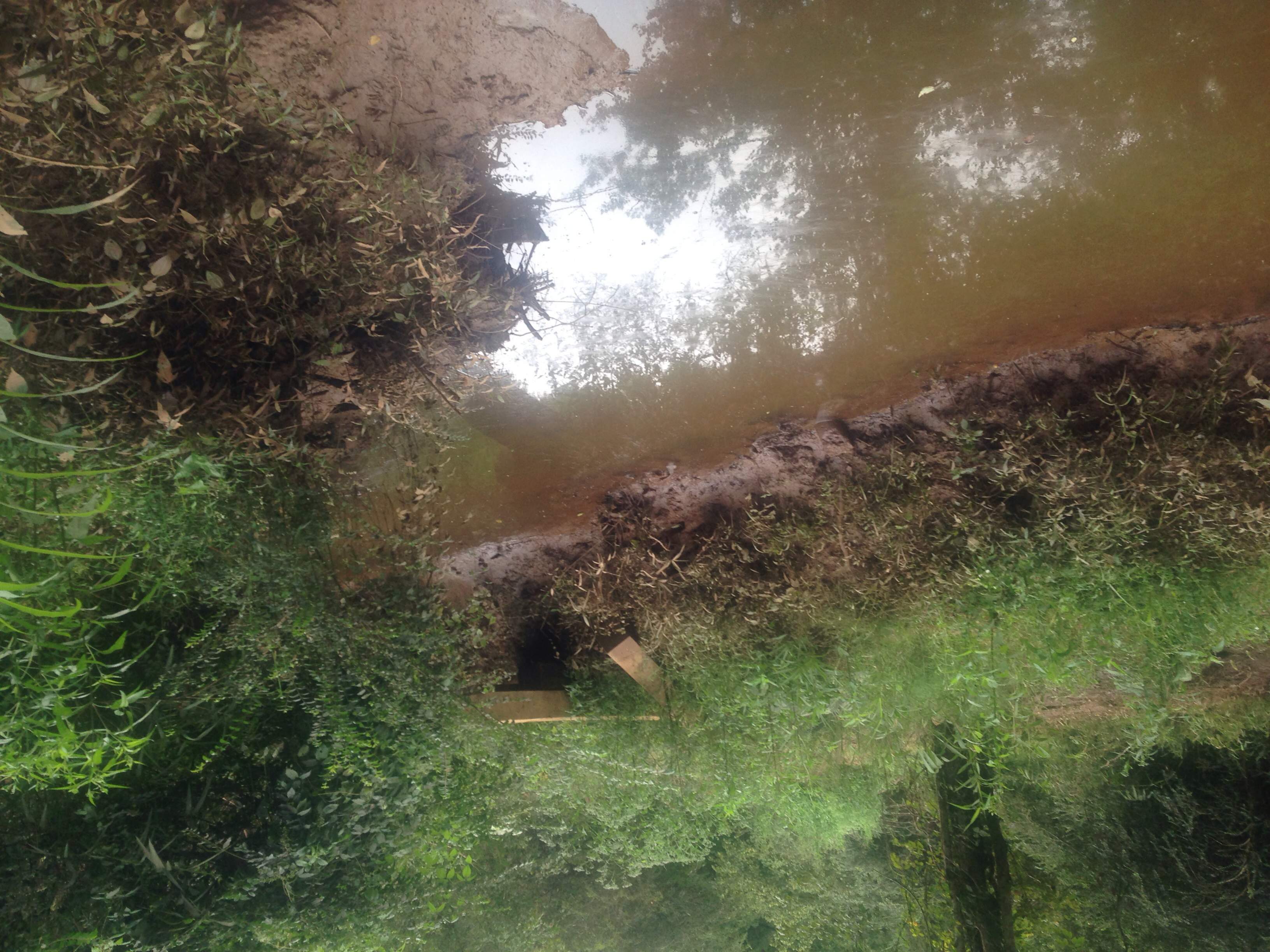

Hey been searching the web for help and have read numerous posts on here (about the only place I've seen about dyi build bridging). But haven't seen what I need. Trying to replace/build a bridge (had to pick up the old one do to age rotting and beavers). From edge to edge of the creek is 15 feet the old bridge was a beam bridge put down like that. The water level is usually 3-4 feet below the bridge. High water mark is around the top of the land but that's a rarity. Trying to make it where I can cross it with my Ford 555D backhoe (14,000 pounds) so I can start cleaning up the back side of the property. Been thinking about using 25-30 foot telephone poles and using a wire on both sides to the center kinda as a suspension/beam bridge.

Well posted this from my iPad and the photos posted aren't anything overtaken lol. Will have to post them once I get to my computer

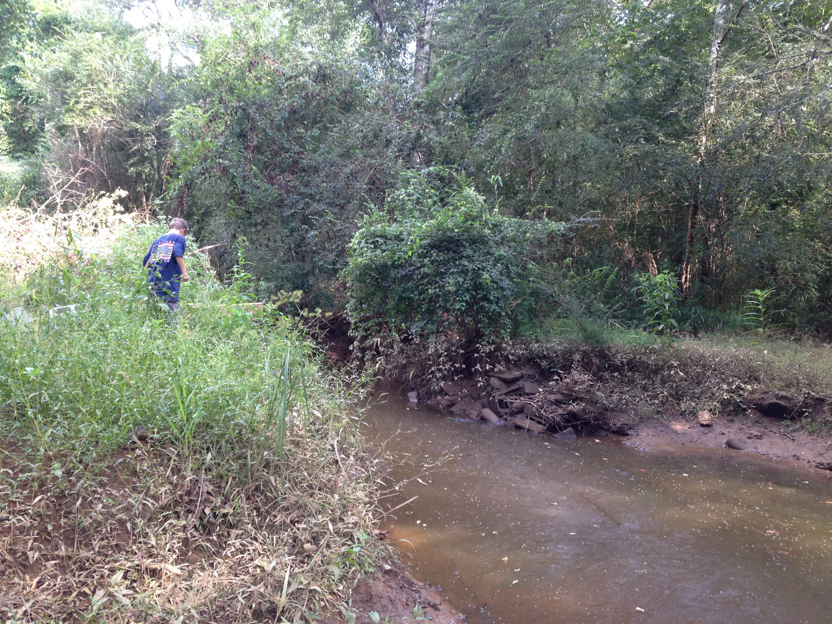

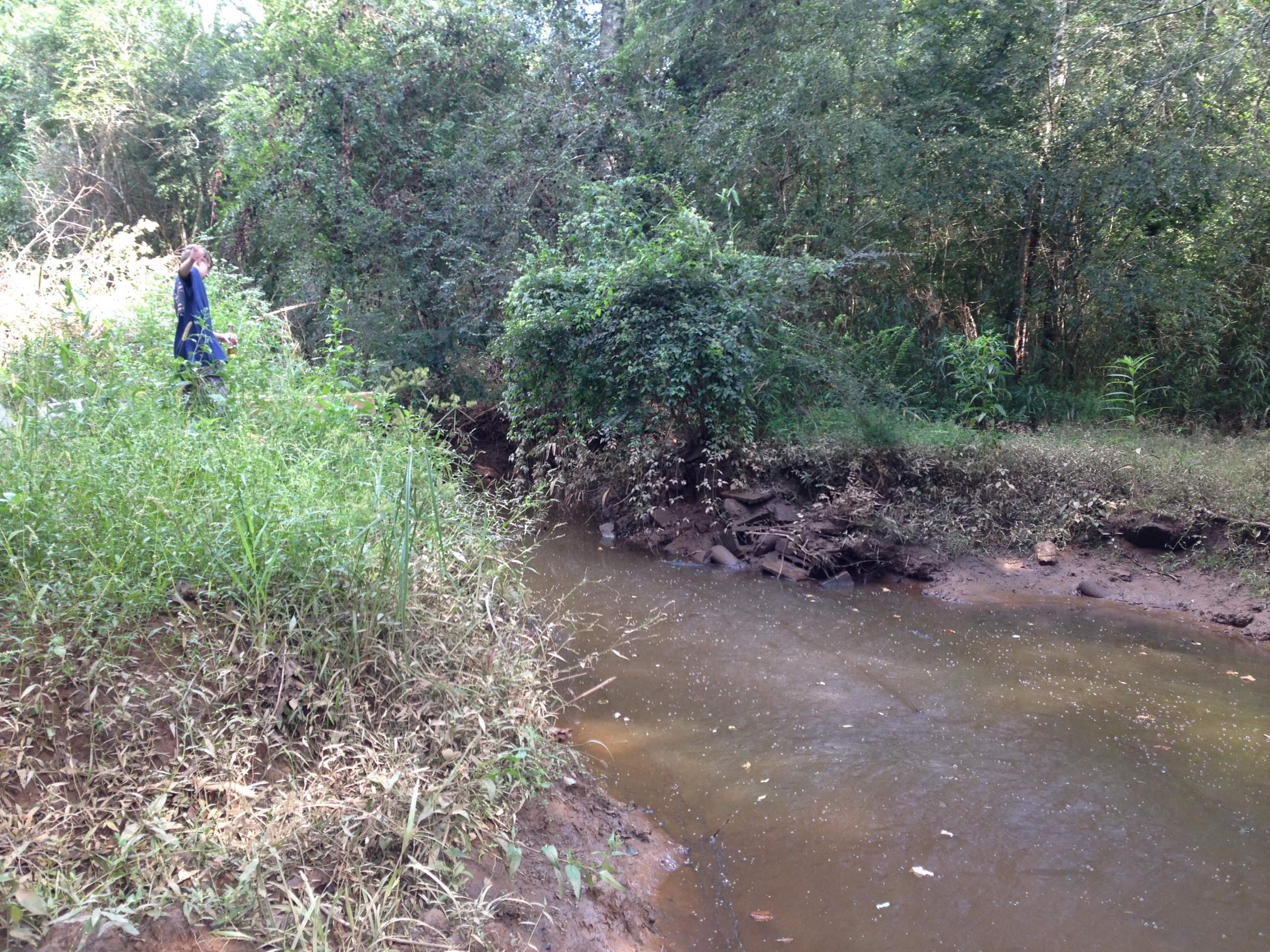

Thanks for all the input... Been looking at flat bed trailers and the cheapest I found was around $3,000 out of my budget..... Never thought of a rail car but pretty sure thats out as well but will definitely look into it..... Here are some better angles of the spot for the bridgeIMG_1719.jpgIMG_1720.jpg. Thats my son standing near the edge of the one bank...
Still leaning toward the telephone poles since I can get them for free. Was thinking about possibly bolting the telephone poles together making a beam out of them and putting them directly under the path of the tires. also was planning on putting concrete footers down so that they have something solid to sit on. The top deck will be out of 2x8s...
