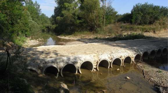

   / Building a bridge #36
Lowes sells a 10' x 12" section of plastic pipe for $150 each. Not sure what concrete pipe cost is.

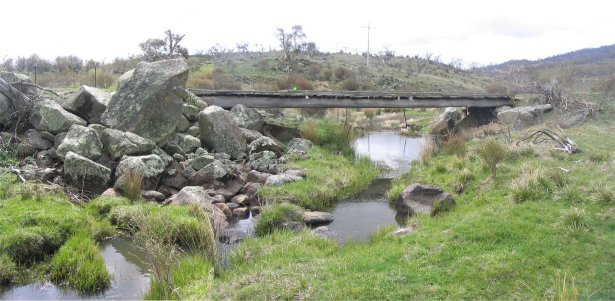

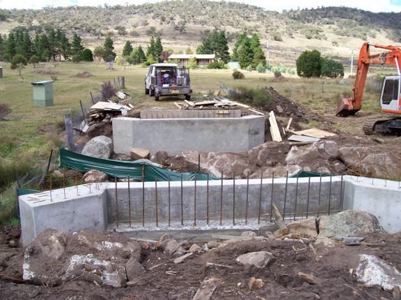

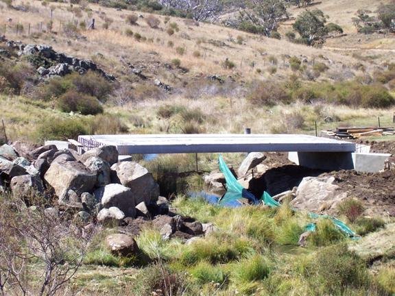

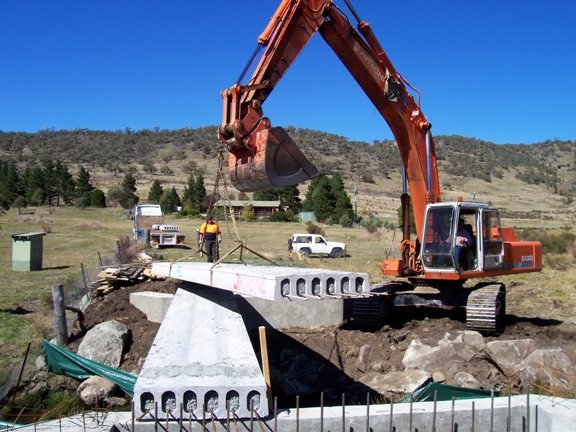

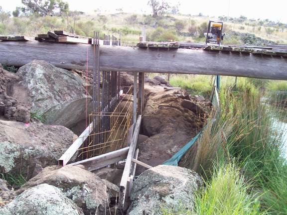

Photo_0_Original_Bridge.jpgPhoto_4_Footing_Before_Granite_Pour.jpgPhoto_15_Abutments awaiting planks.pg.jpgPhoto_18_Planks being positioned onto abutments.jpgPhoto_20_Planks in position on abutments.jpgPhoto_32_Finished bridge with security chain.jpg
Slicer1972, I had a need to build a significant structure to replace an old, termite-eaten timber bridge spanning about 12 metres (see pictures). The new bridge led to the site for our new house so had to be substantial, to carry the weight of a full concrete truck (22 tons) plus a full fire truck (16 tons) if the need arose!!. The build involved a contractor putting in reinforced abutments on either side, down to granite bedrock and then we used 3 pre-stressed concrete beams as the span. These were cheaply available from a concrete manufacturer and are used for building car parks - REALLY strong and in long lengths. They were lifted into place by an excavator and then set up with a concrete slab over the top. The bridge has now withstood three BIG floods (over the deck), and some really heavy loads. All up, the result is an engineered bridge with a cost of about $30,000 - Perhaps more expensive than you are after but a really great solution to our problem for access to our home into the future. Peter G.
