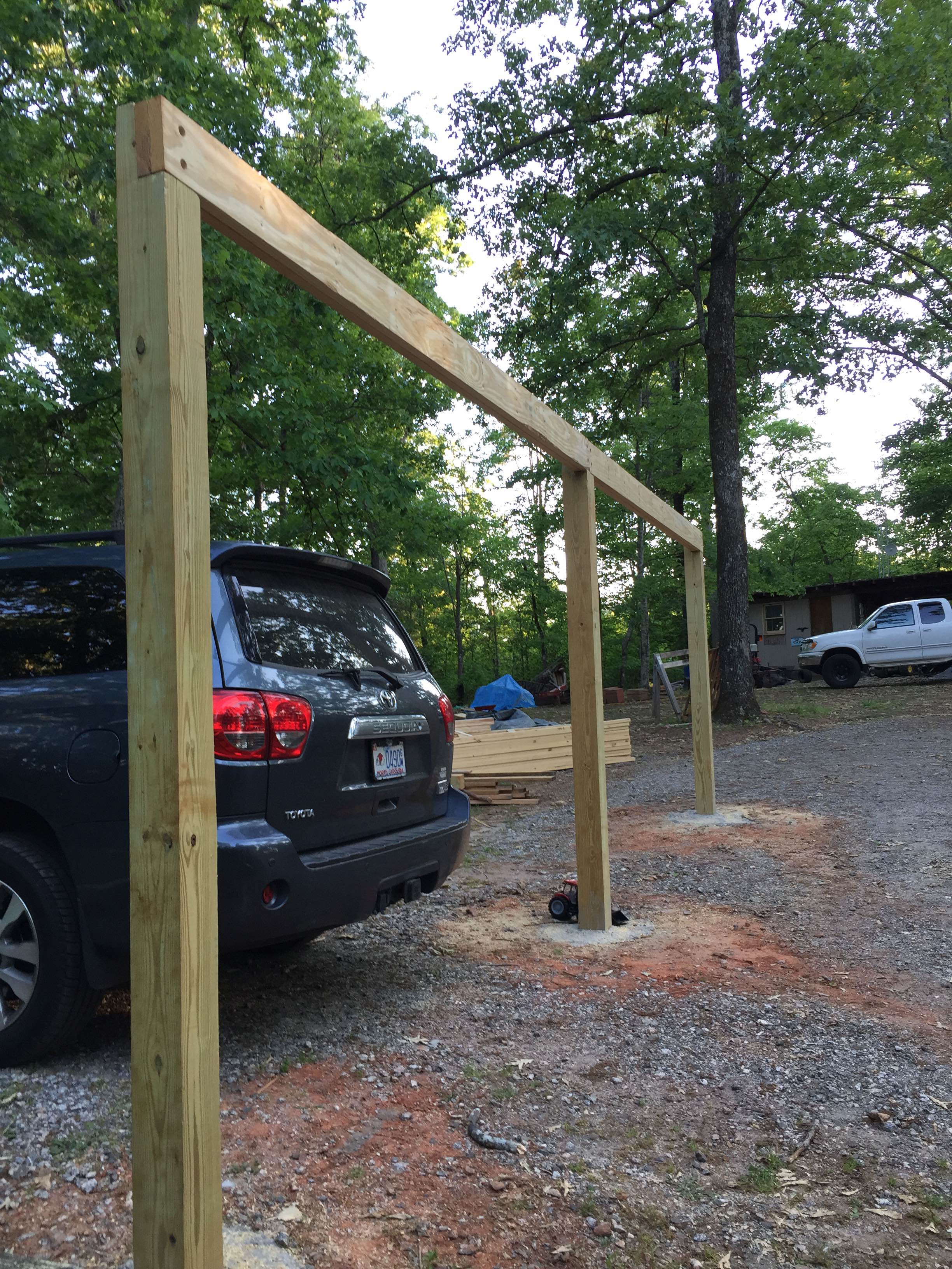

Cut off posts, notched them, and put up two beams this afternoon.
   / Building a Car Port #57
Don't know why, but your picture loads sideways on my computer.
The beam looks great!!!!

Lifted a truss onto the load beams. Much easier than I expected. When help gets here this weekend, it ought to be a cinch.
