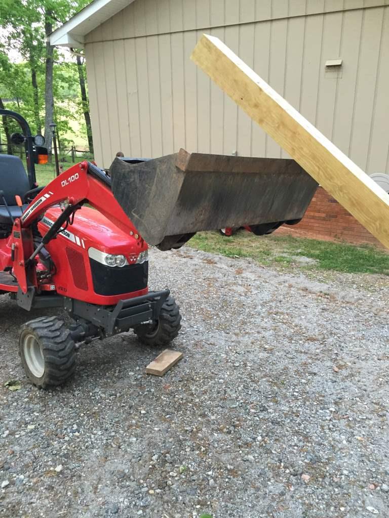

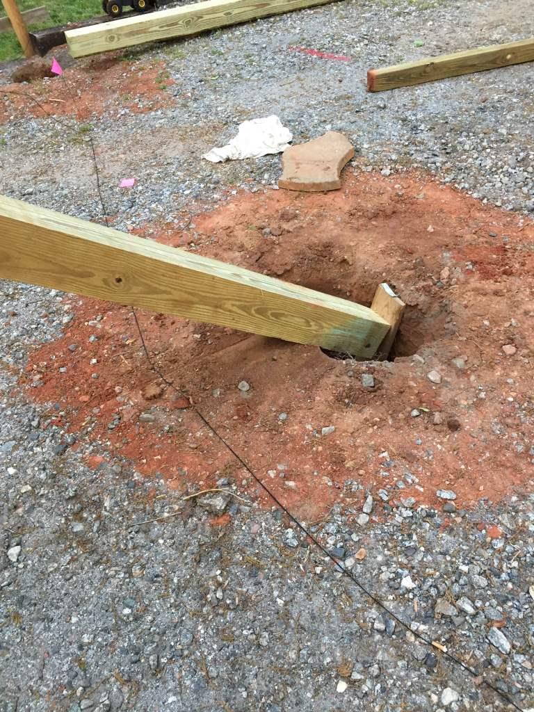

Finally got some posts stuck in the ground last night. My goal is to have all six posts ready for concrete Saturday and rent a mixer and set them all at one time.
The "slider" board in the hole was a great idea! Used the bucket of my tractor to walk the posts up to vertical position.
