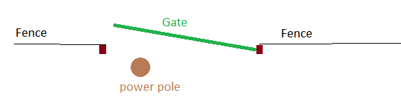

Hi all - I'm building a fence and the ideal line has the fence come very near a power pole (PG&E, California).
I've made a variety of inquiries with PG&E for guidance, but the best I've gotten is a pointer to their "Greenbook" which pretty much just describes how you give access to meters and such; there's no mention of setbacks from power poles.
I'm sure I've seen fences almost touching poles, and I'm not expecting to attach my fence to the pole, but I'd like more information. Anyone know?
I need a gate in the vicinity of the pole anyhow so I'm thinking of sinking a fence post to one side of the pole, and having the gate opening allow access to the pole - kinda like this:
Does that seem reasonable?
   / Building a fence near a power utility pole? #2
Looks good to me... you're being more than accommodating.
As long as you're not attaching to the pole, they have easy access to it for maintenance/repair, and for future removal/replacement, you're good to go.

Here in Texas, I already had the fence in place when the power pole was installed. They insisted that it be on my property, inside the fence. There is probably a foot between the pole and my fence. I cannot mow around it, so I weed eat there.
I guess that you have your reasons for having the pole inside the gate area. If it was me, I would slide the gate over so I could get through the gate with a tractor or vehicle.
   / Building a fence near a power utility pole? #7
Having a pole in the path of the gate opening doesn’t make sense (IMHO).
