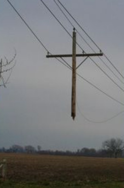

   / Building a fence near a power utility pole? #13
Ask them to convert it to this style pole that doesn't need ground contact. :)
Bruce
