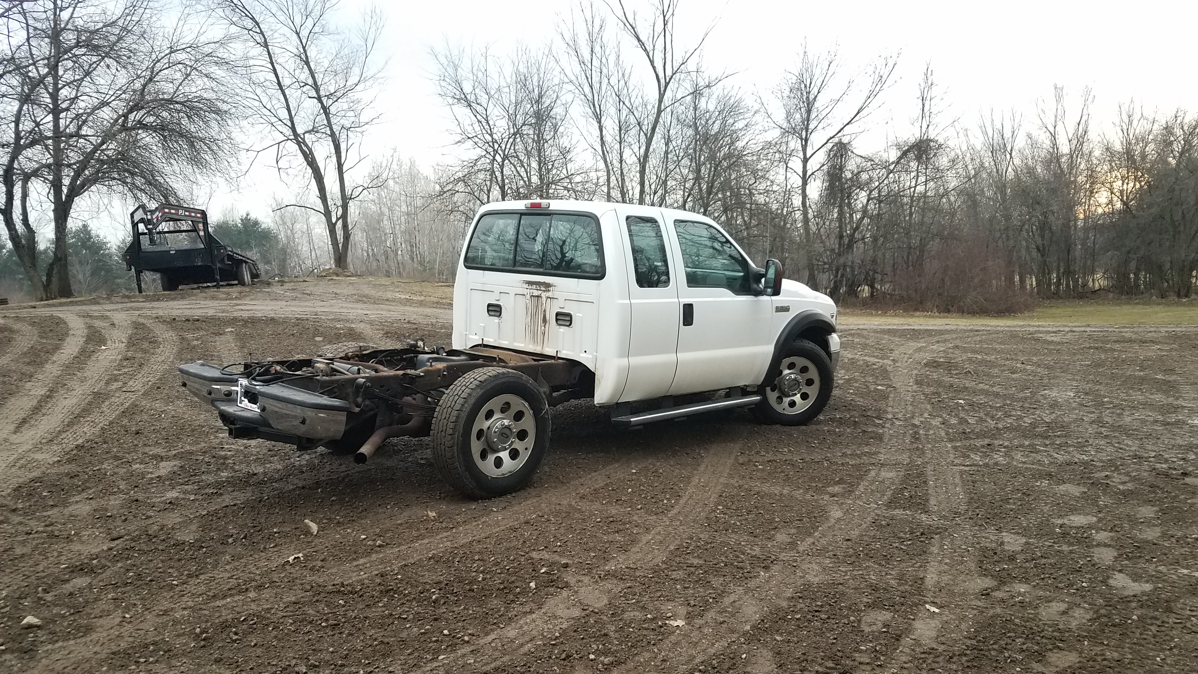

Ongoing project... I'll post updates as it goes. I'm hoping to complete the project within the next couple weeks. This is going on my 05 F350 ShortBed. The flatbed will measure 94"x80". The deck material will be wood.

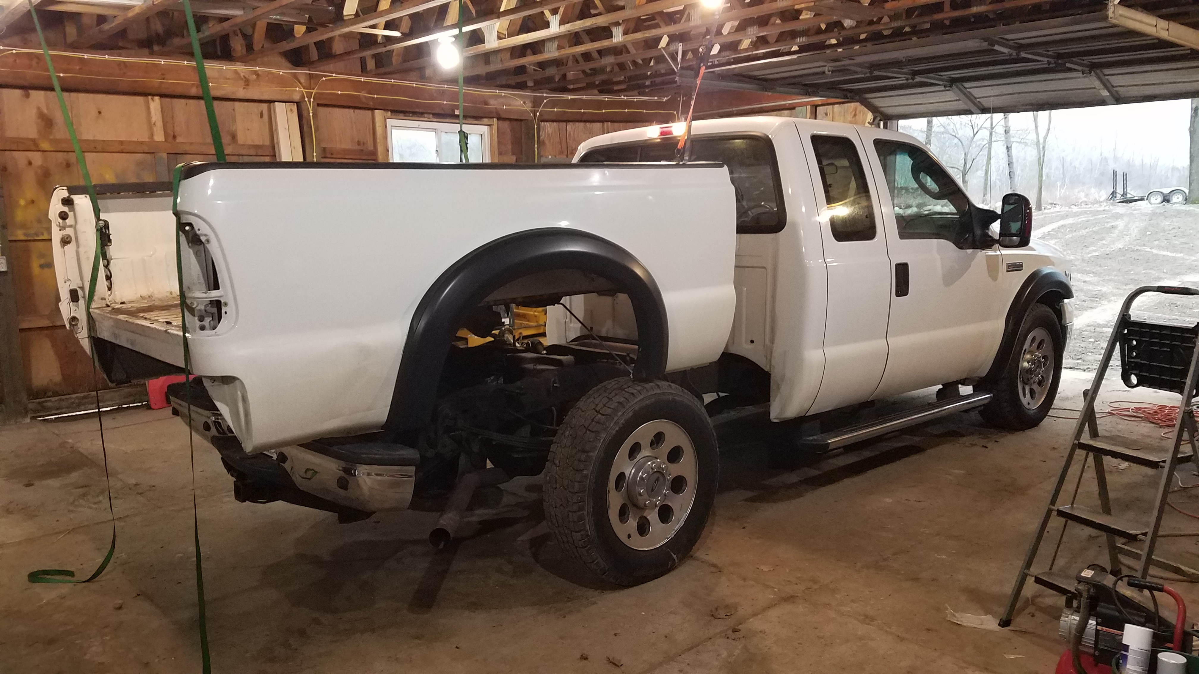

Took the bed, bumper, tailgate, lights... off the truck and sold them on Craigslist.

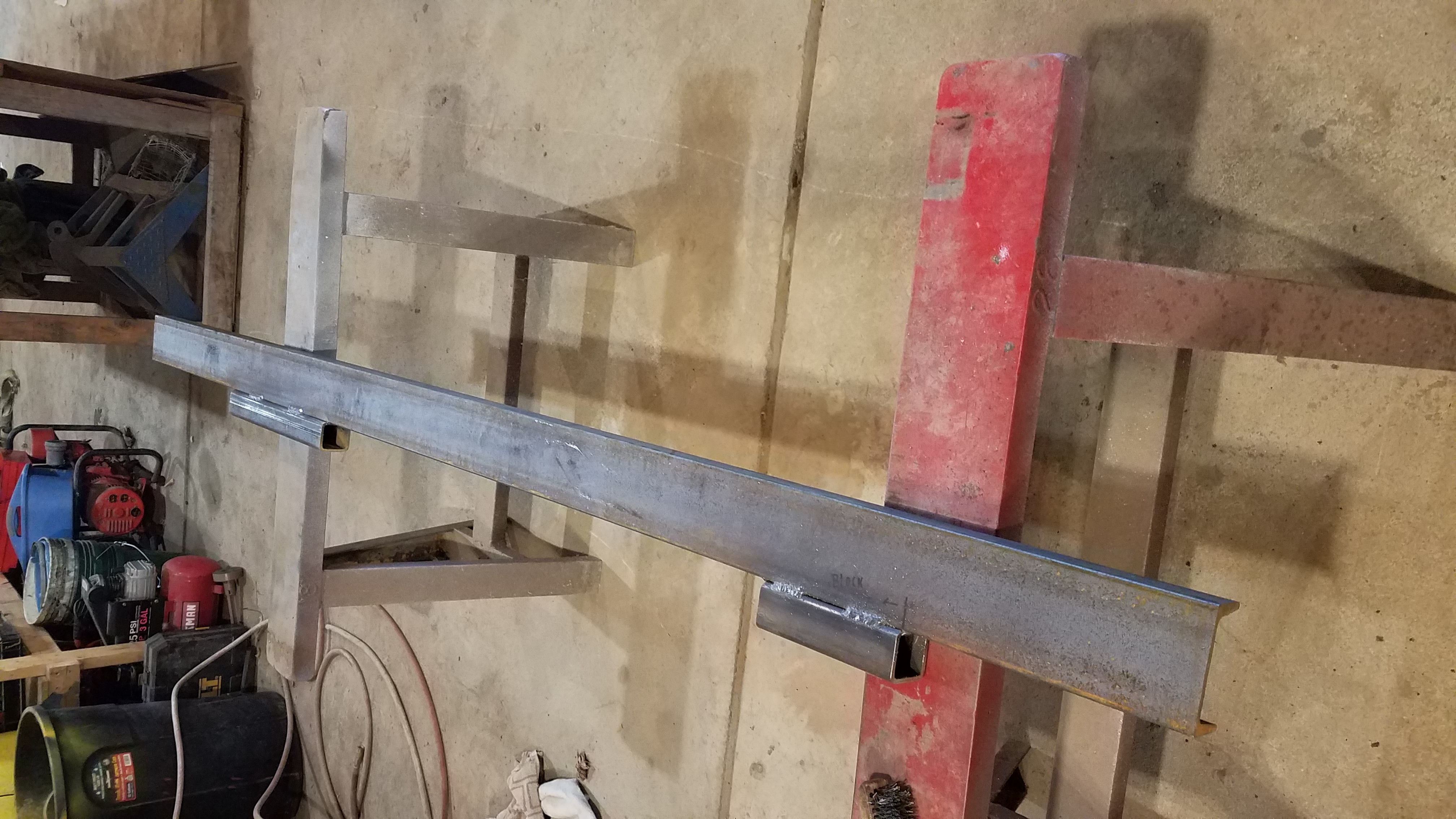

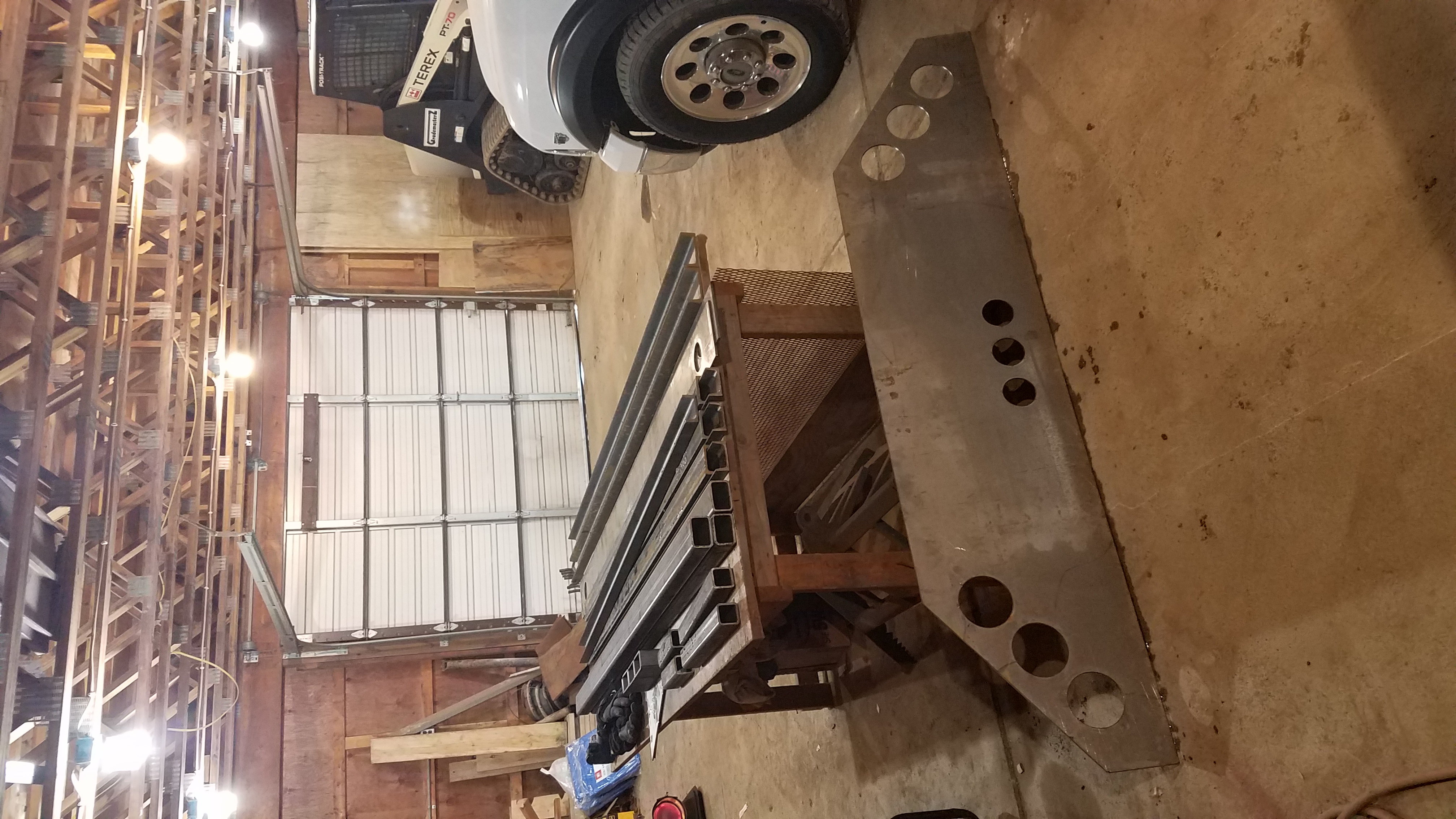

Picked up my steel order from my local steel shop. I have about $750 in steel (which includes the custom cuts). I'm using heavy gauge structural C-channel for the framing. 1/4 " plate for the side rails. 3/16 " plate for the rear "apron". I'll be building the bulkhead/headache rack out of 3/16" walled 2"x3" box tubing.
I'll be retaining the factory rear trailer hitch, but building in recessed 5th wheel rails with a gooseneck adapter plate (for towing flexibility).

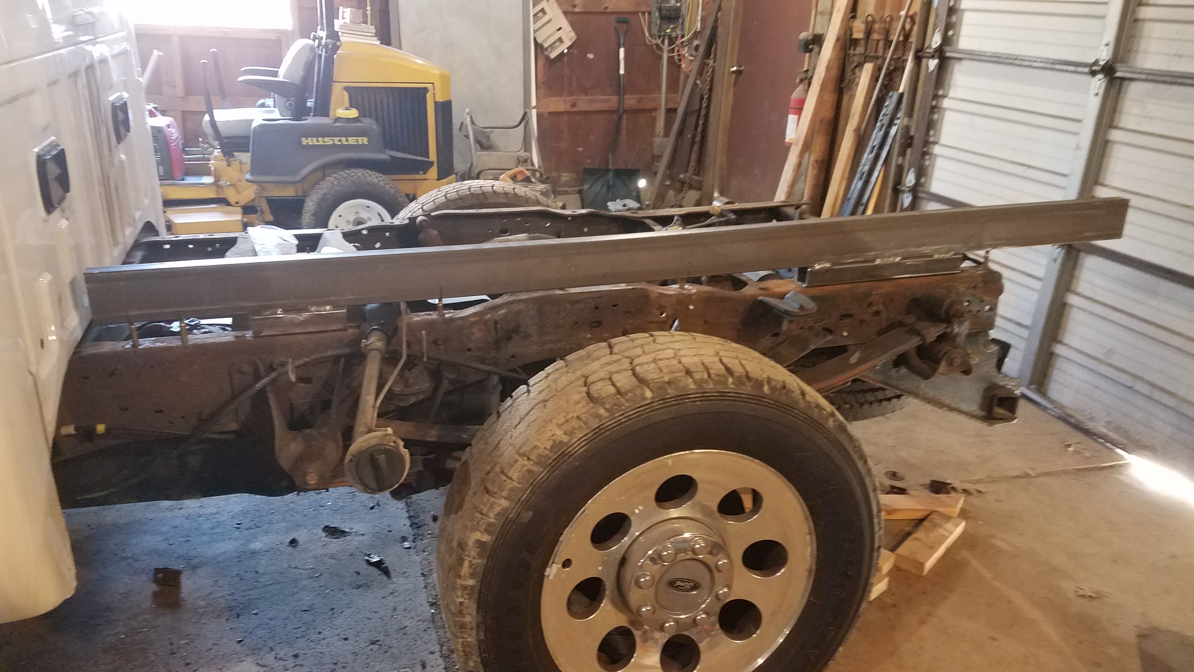

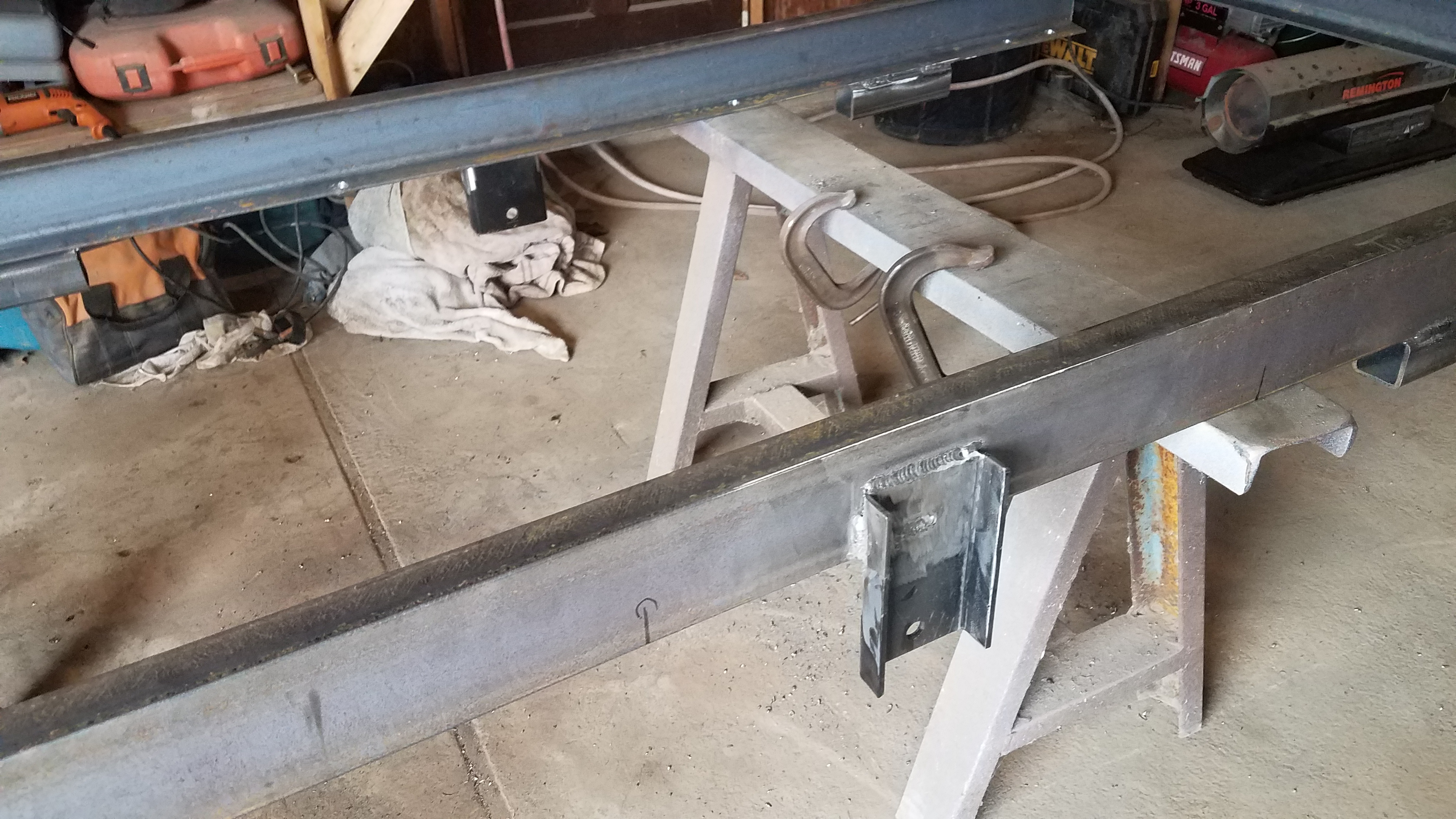

Spacer blocks for the frame rails:
Each frame rail will be mounted to the truck frame with (5) 5/8" grade 8 bolts, bolted thru the original mounting holes on the top side of the truck frame. There will be an additional (not pictured) 5/8" bolt on the outer side of each frame rail, bolted thru a C-channel bracket.
So in total, this flat bed frame will be mounted to the truck with (12) 5/8" grade 8 bolts.
Now that the mounting points are drilled and completed, today i can start welding the cross-channel pieces.
More to come...
