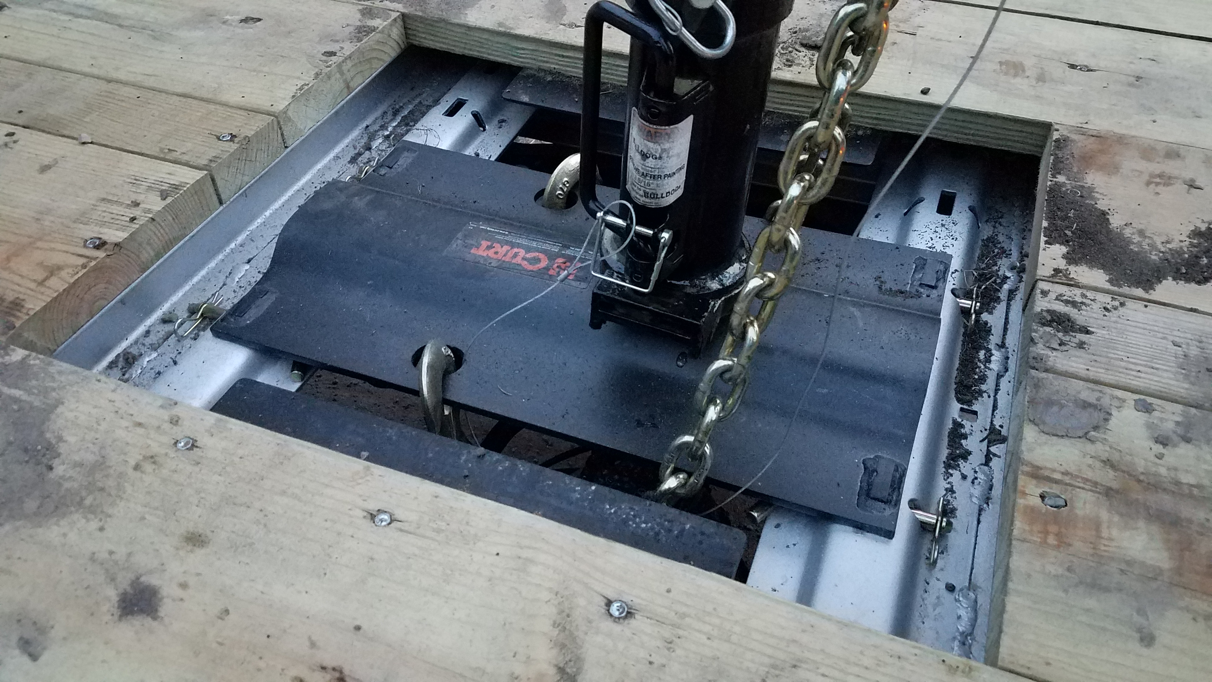

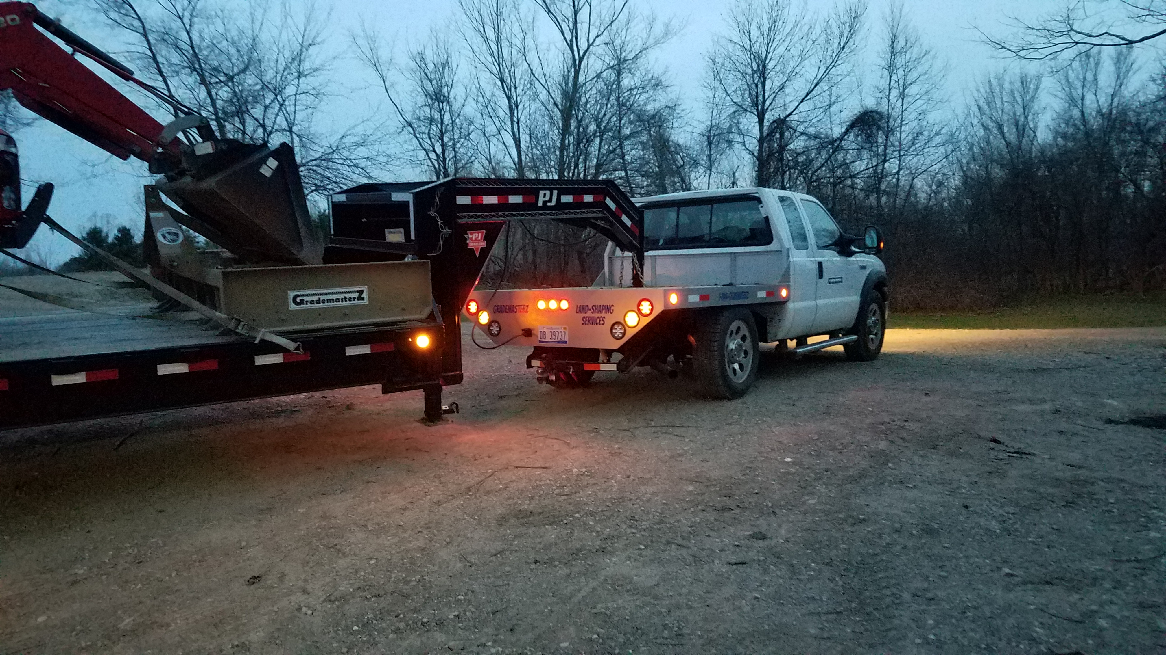

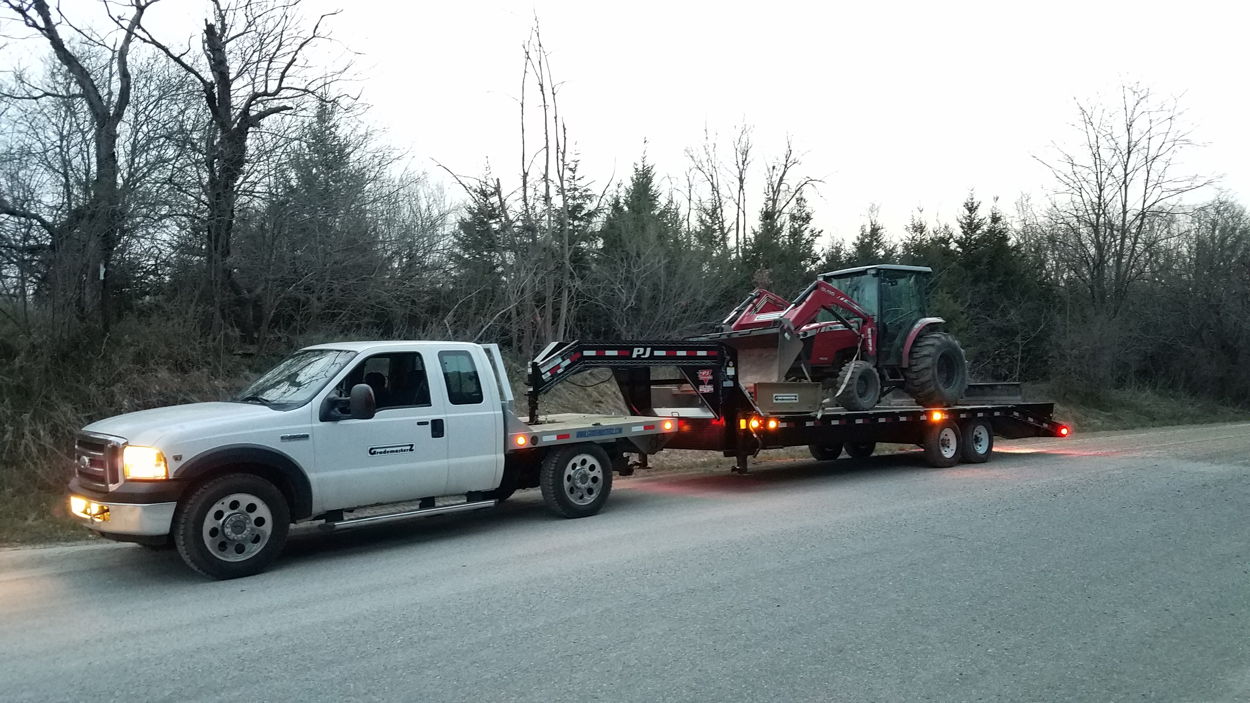

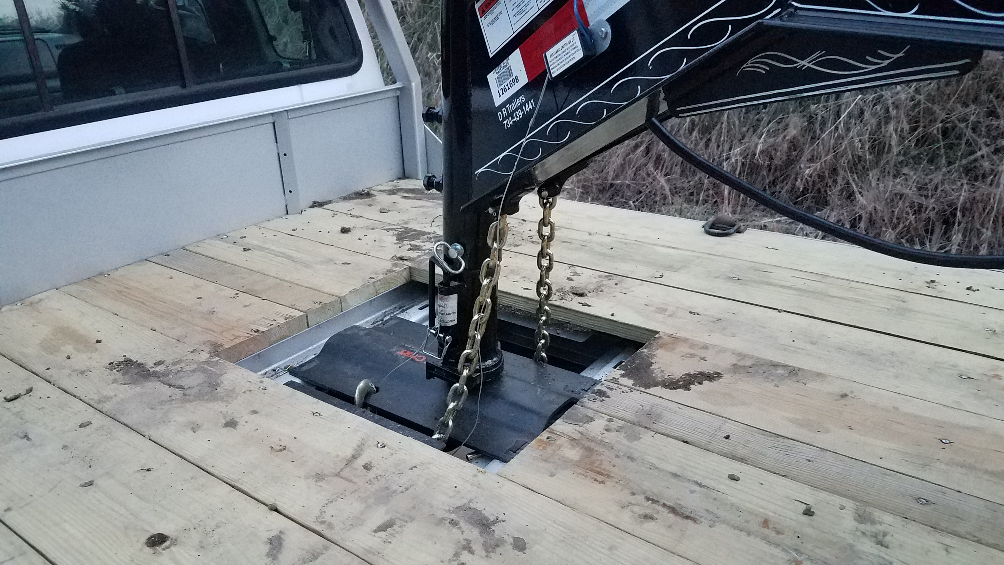

Been using the truck and it's been doing great. Used the Gooseneck for the first time today...
